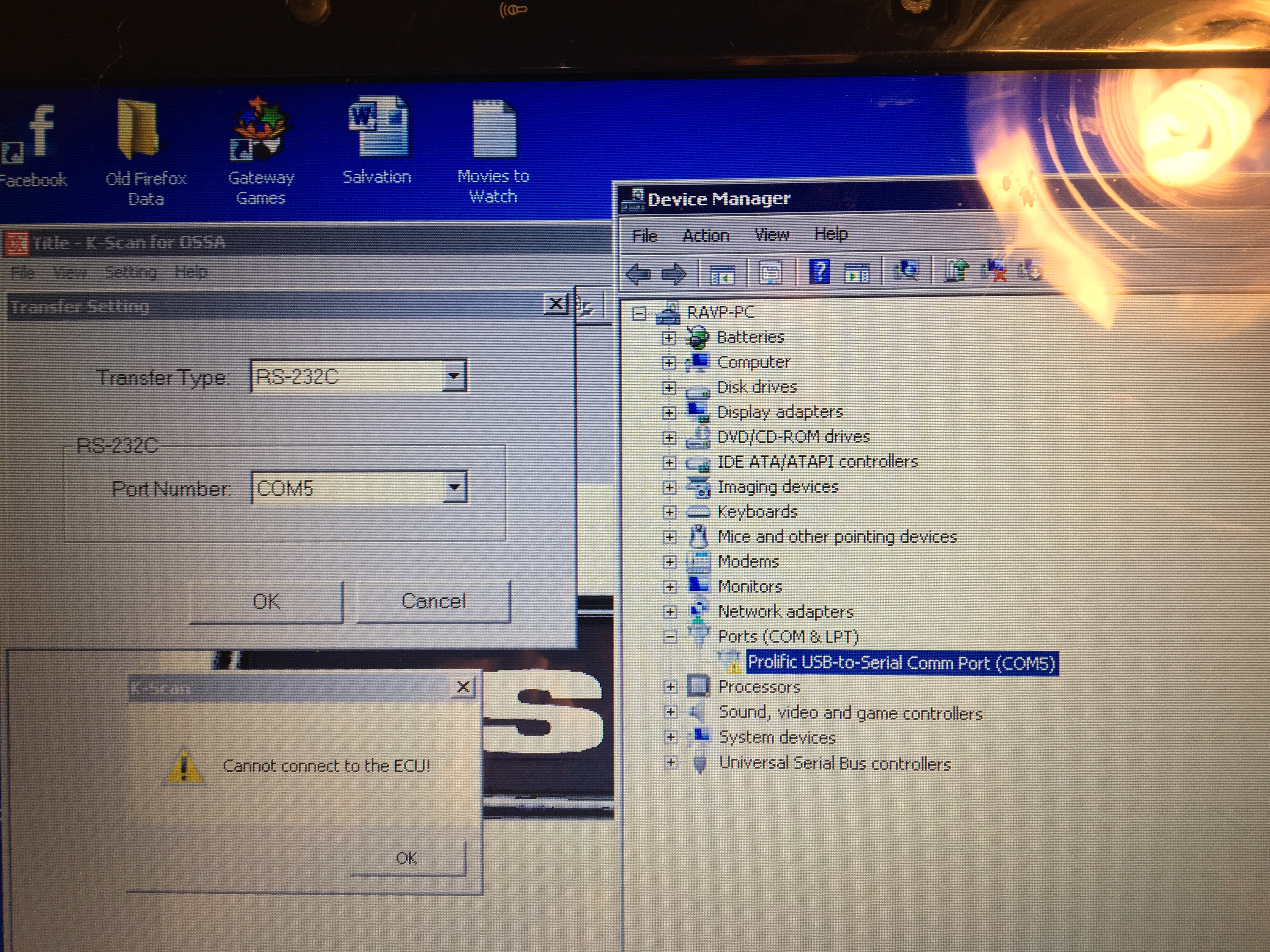

ricarvar Posted March 10, 2017 Author Report Share Posted March 10, 2017 Guys... this is being quite interesting (to keep a positive note). I do have match the ports (see picture below) but still get the same error. It seems that from the few drivers I've tried... none work... despite what websites say about they working(?). So, as you have suggested... I've been in the looks for either a PC, HD or XP system... with no success... AT this point I'm willing to try anything that has a serial port, or XP installed on it. Preferably the "DELL"... but just can't get my hands on one of those... I'm in Calgary by the way... we're in the middle of a cold-snap (-27C)... Quote Link to comment Share on other sites More sharing options...

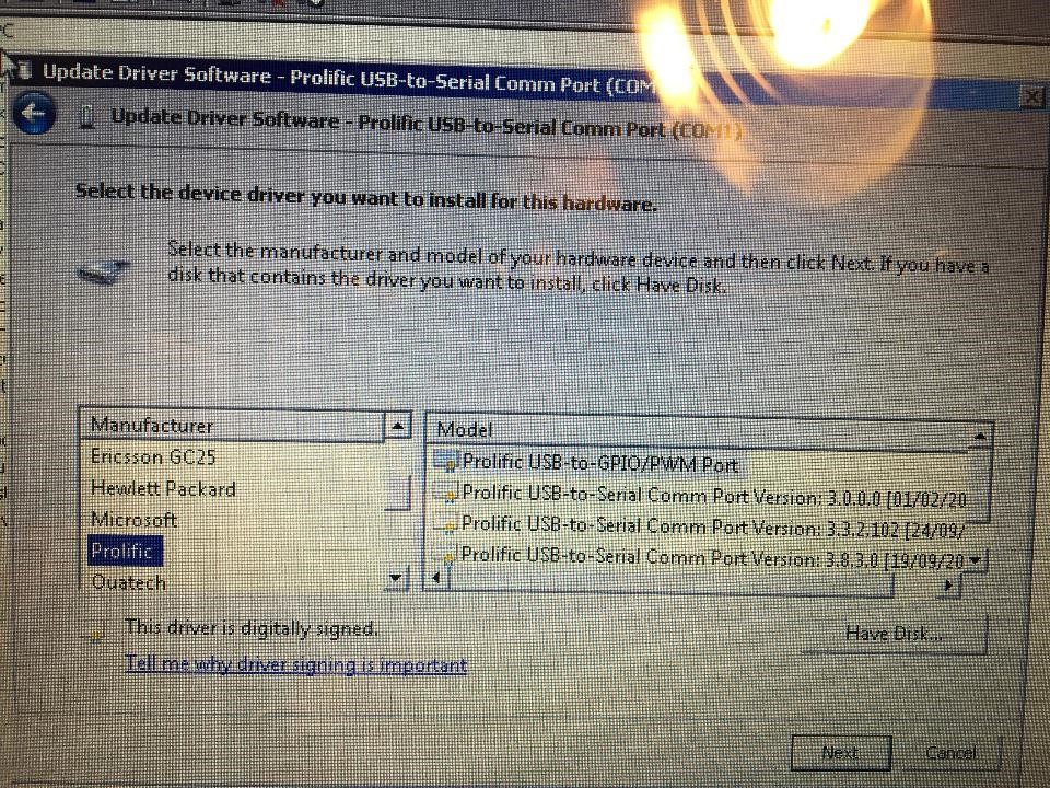

ricarvar Posted March 10, 2017 Author Report Share Posted March 10, 2017 by the way... below is a picture of some of the "drivers" names I've already tried... Quote Link to comment Share on other sites More sharing options...

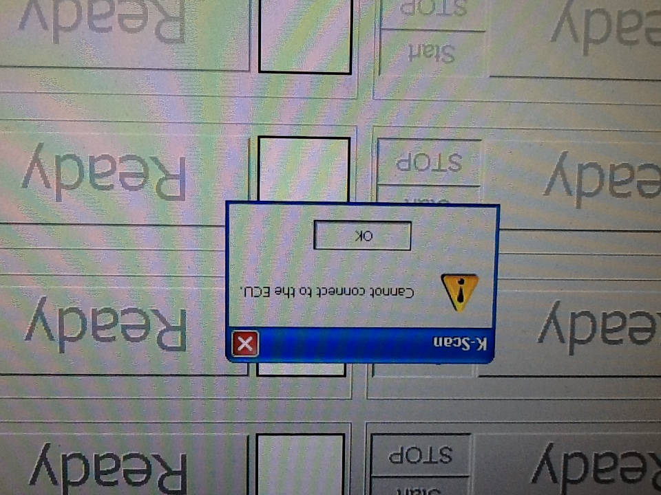

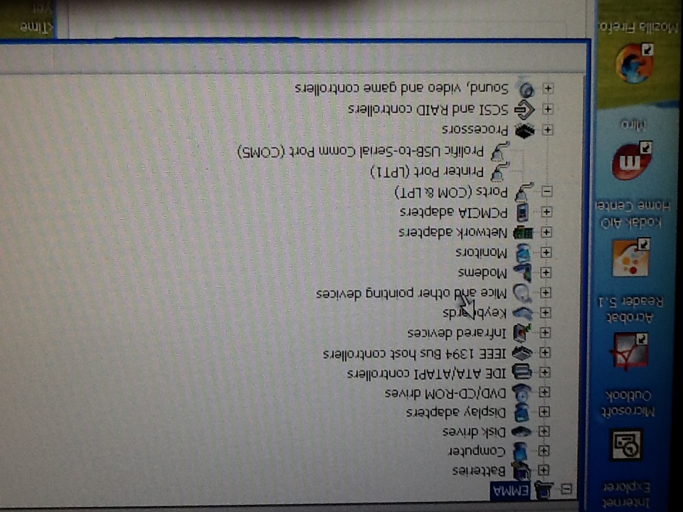

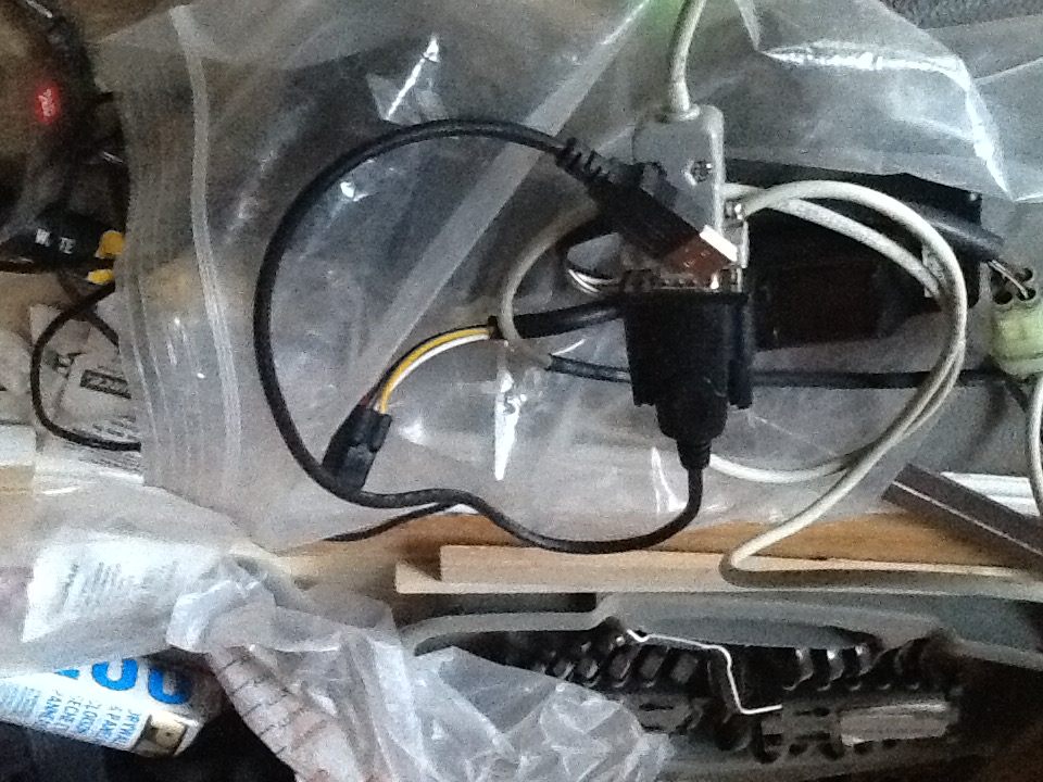

canada280i Posted March 10, 2017 Report Share Posted March 10, 2017 Pics are as follows 1. Prolific sub to serial com port driver settings which I think win xp just auto detected and loaded when I plugged the USB adapter in 2. Screenshot showing the cannot connect message. The ecu is not connected and the bike system is not charged with 12 v so this is normal at this stage 3. System devices list showing the prolific adapter on com 5 4. Pic of the adapter wire, I think 10 dollars from best buy 5. Crappy old toshiba running win xp with 1 gig of ram. Takes an age to fire up but runs the software with no issue Quote Link to comment Share on other sites More sharing options...

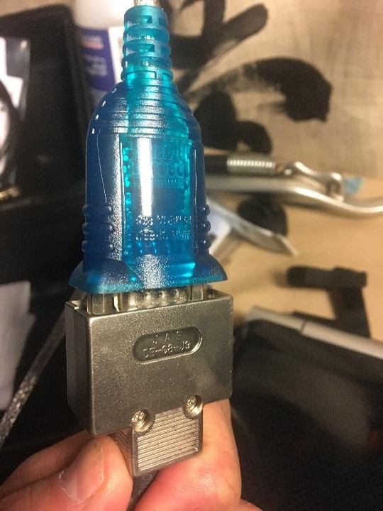

ricarvar Posted March 12, 2017 Author Report Share Posted March 12, 2017 Hey Guys, I found a newer cable. It does have a bunch of electronics within its case at the end part of it (Pic attached). My PC recognized it... but still no connection with the ECU. Lotus - thanks a lot for your offer on the HD with XP, it's much appreciated. I believe I'll be able to find a laptop with XP on it and probably even with a serial port. But I'll have to wait for a couple/few days as my friends are digging for it in their basements ... Ossabc - I will check the ftdi website, thanks for the tip, seems also an interesting opportunity. I do believe as lotus has mentioned before it's a Windows-7 issue. Mind you there's also the chance that my ECU actually was burnt... but let's hope that's not the case. As soon as weather improves and temperatures are good to work, I'll check the pick-up coil, and flywheel. Any of you guys know how to test the "Coil"?... the one that feeds the spar-plug cable?... any voltage, resistance or amps measurements that can be taken? Quote Link to comment Share on other sites More sharing options...
