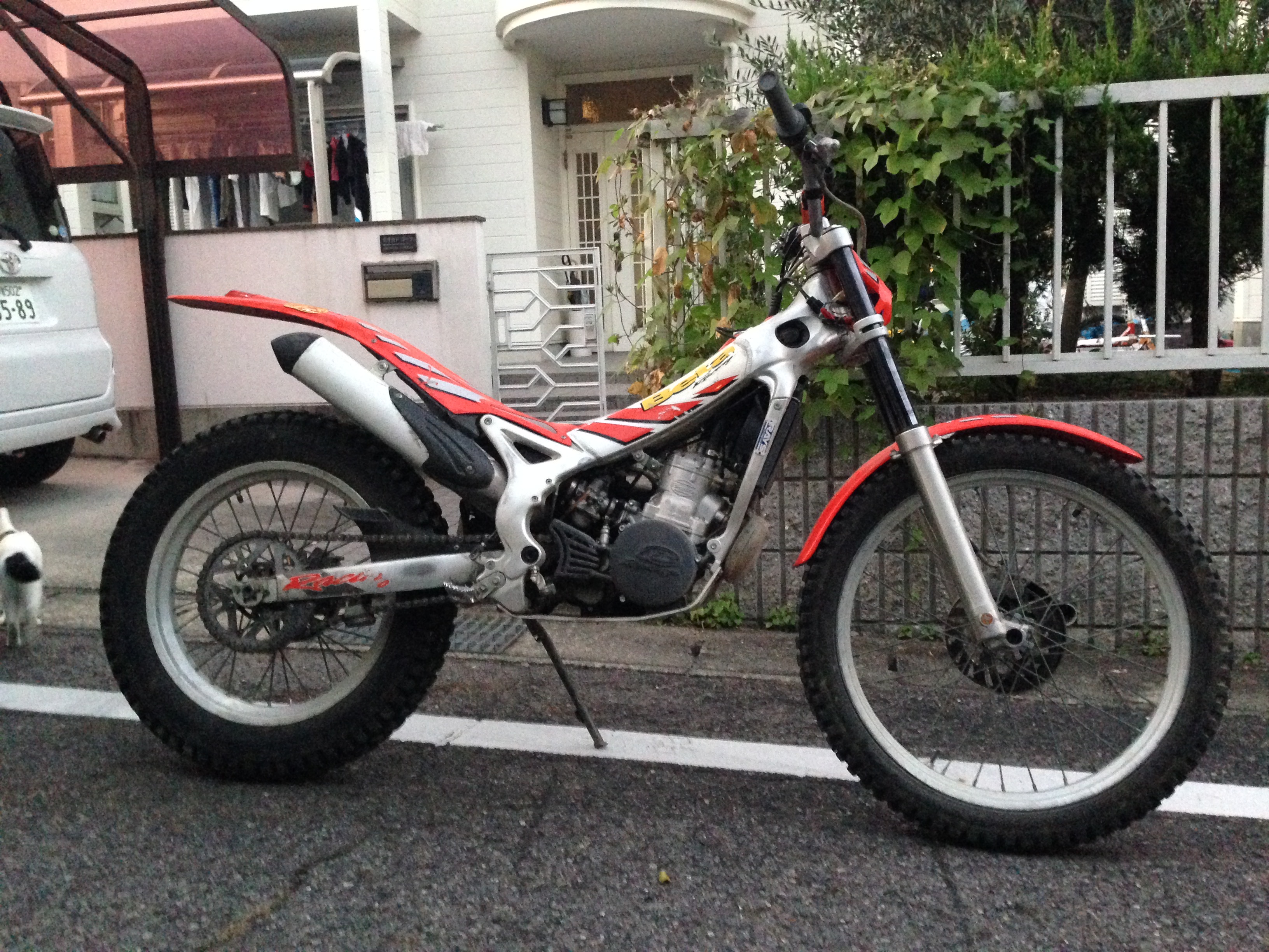

Dualta Posted March 6, 2017 Report Share Posted March 6, 2017 (edited) Hi folks, I'm trying to identify my Rev 3's year. It has the yellow graphics, and the frame number begins B6*004.... Can I safely assume that it's an '04? If that's the case, is it also safe to assume that I can use the '08 owner's manual? Thanks in advance. Edited March 6, 2017 by dualta Quote Link to comment Share on other sites More sharing options...
daz14 Posted March 6, 2017 Report Share Posted March 6, 2017 It's got the wrong swinging arm sticker (possibly a later model) and I'm pretty sure the 04 models and possibly later had a red anodised rear shock. The frame number should tell you the year as well. Quote Link to comment Share on other sites More sharing options...
bilks Posted March 6, 2017 Report Share Posted March 6, 2017 (edited) Frame decals from 04 should be red rear shock but forks look like from later model as 04 wasn't coated black.used have 04 and 05 model cpl links .http://www.americanbeta.com/node/751 http://www.motomerlin.co.uk/moto/motobeta.html http://www.whomademybike.com/ Edited March 6, 2017 by bilks 1 Quote Link to comment Share on other sites More sharing options...
Dualta Posted March 7, 2017 Author Report Share Posted March 7, 2017 Cheers folks. I hadn't spotted the upgraded swing arm or rear suspension. I'll not complain about that. Do you know if the '08 owners' manual covers from '04? Quote Link to comment Share on other sites More sharing options...
pa. Posted March 10, 2017 Report Share Posted March 10, 2017 (edited) For most parts the owners manual from 08 will be fine. Here is a list of the manuals I have on my site. http://www.trialsport.com.au/beta/documents.htm 2004 Frame parts link, http://www.trialsport.com.au/beta/Manuals/2004/rev3_2t_04_200-250-270cc_frame.pdf 2004 Engine parts link, http://www.trialsport.com.au/beta/Manuals/2004/rev3_2t_04_200-250-270cc_engine.pdf Edited March 10, 2017 by pa. Quote Link to comment Share on other sites More sharing options...
