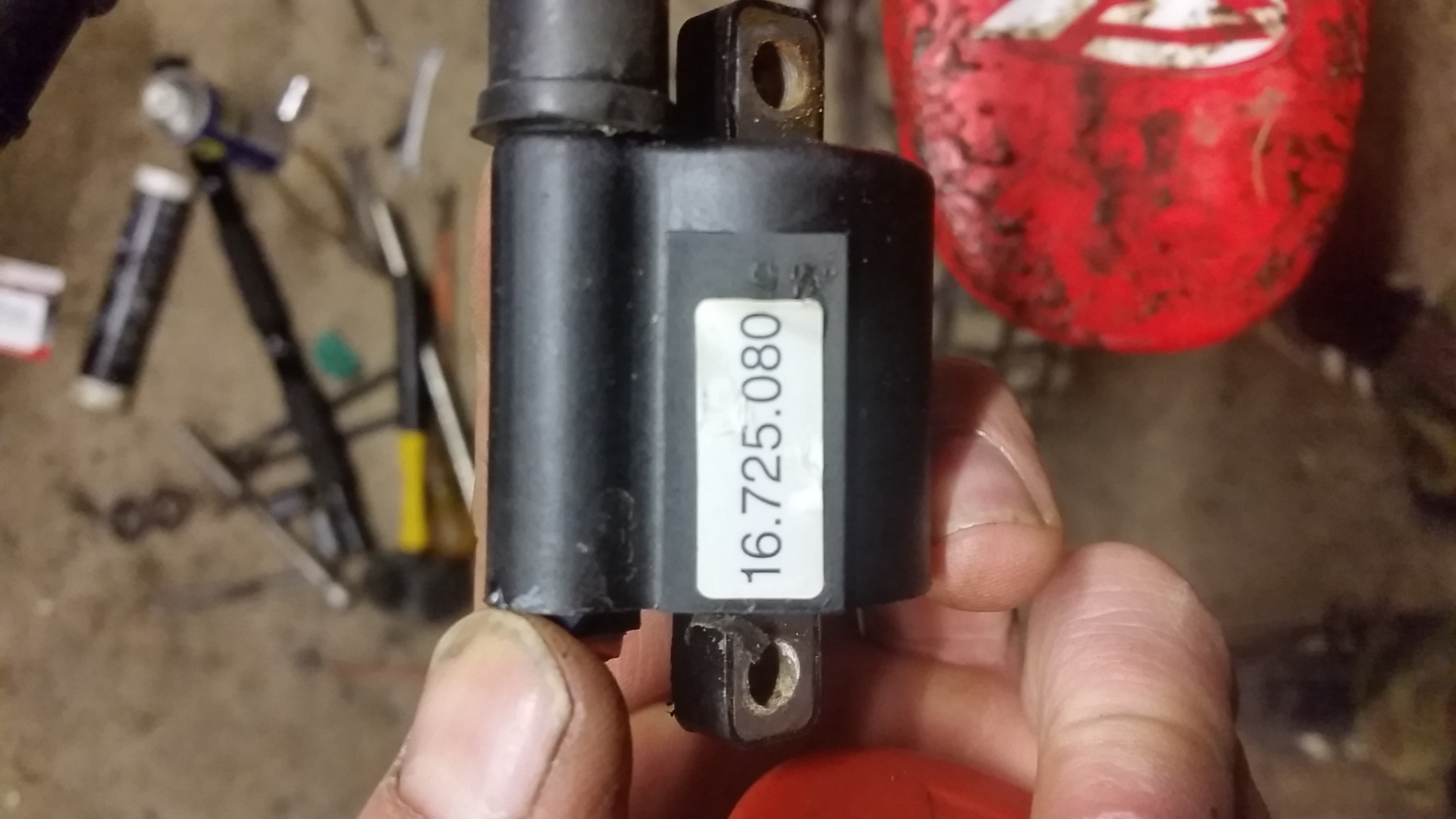

stilly36 Posted March 6, 2017 Report Share Posted March 6, 2017 Dear all. Beta rev 3 250cc 2002 coil. Will a beta rev 3 270cc 2004 coil be the same. Will it work the same. Cheers all. Quote Link to comment Share on other sites More sharing options...
lineaway Posted March 7, 2017 Report Share Posted March 7, 2017 It should, but the chance of the coil being bad is slim. Have you trimmed the coil wire back 10-20mm ? Quote Link to comment Share on other sites More sharing options...
stilly36 Posted March 7, 2017 Author Report Share Posted March 7, 2017 On 3/7/2017 at 2:15 AM, lineaway said: It should, but the chance of the coil being bad is slim. Have you trimmed the coil wire back 10-20mm ? Expand I will try that. I have ordered a new 1. A spare won't go wrong I suppose. Thanks for the help. Quote Link to comment Share on other sites More sharing options...
bilks Posted March 7, 2017 Report Share Posted March 7, 2017 Well it's the same part no,so should be ok if your coil is faulty.which is very rare,normally it stator that goes, Quote Link to comment Share on other sites More sharing options...
