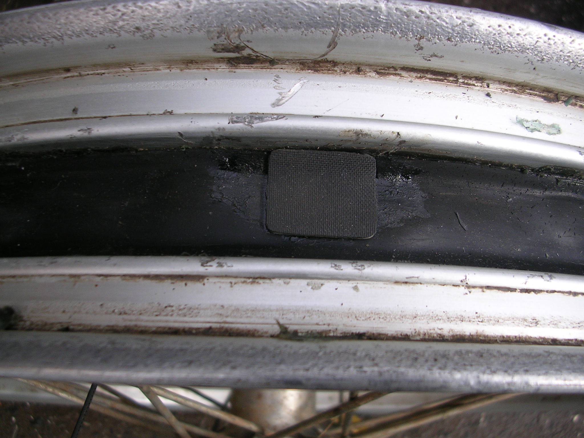

suzuki250 Posted March 8, 2017 Report Share Posted March 8, 2017 I’ve got a slow puncher, it turns out the rim tape has a very small split where a spoke has damaged it! Anyone ever repaired a rim tape with a puncture repair kit? Quote Link to comment Share on other sites More sharing options...

suzuki250 Posted March 8, 2017 Author Report Share Posted March 8, 2017 Just finished it, put a large patch on the rim seal. It currently seems to be holding 40psi quite well at the moment Quote Link to comment Share on other sites More sharing options...

suzuki250 Posted March 8, 2017 Author Report Share Posted March 8, 2017 32 minutes ago, faussy said: As with most rim tapes, having them hold high pressure is the easy bit lol True! I'll leave it overnight with 5psi 1 Quote Link to comment Share on other sites More sharing options...

suzuki250 Posted March 9, 2017 Author Report Share Posted March 9, 2017 Never had a problem getting a seal, just make sure everything is clean and well lubed The puncture repair seems to be holding even at low pressure 1 Quote Link to comment Share on other sites More sharing options...

suzuki250 Posted March 16, 2017 Author Report Share Posted March 16, 2017 (edited) One trial later and the rim tape still holds pressure, so rim tapes do repair Edited March 16, 2017 by suzuki250 Quote Link to comment Share on other sites More sharing options...
nigel dabster Posted March 16, 2017 Report Share Posted March 16, 2017 Well done. I notice a bulge in the rim tape(?) if so, put the tyre back on and leave 60 psi for a few days and it will flatten out nicely! Quote Link to comment Share on other sites More sharing options...
