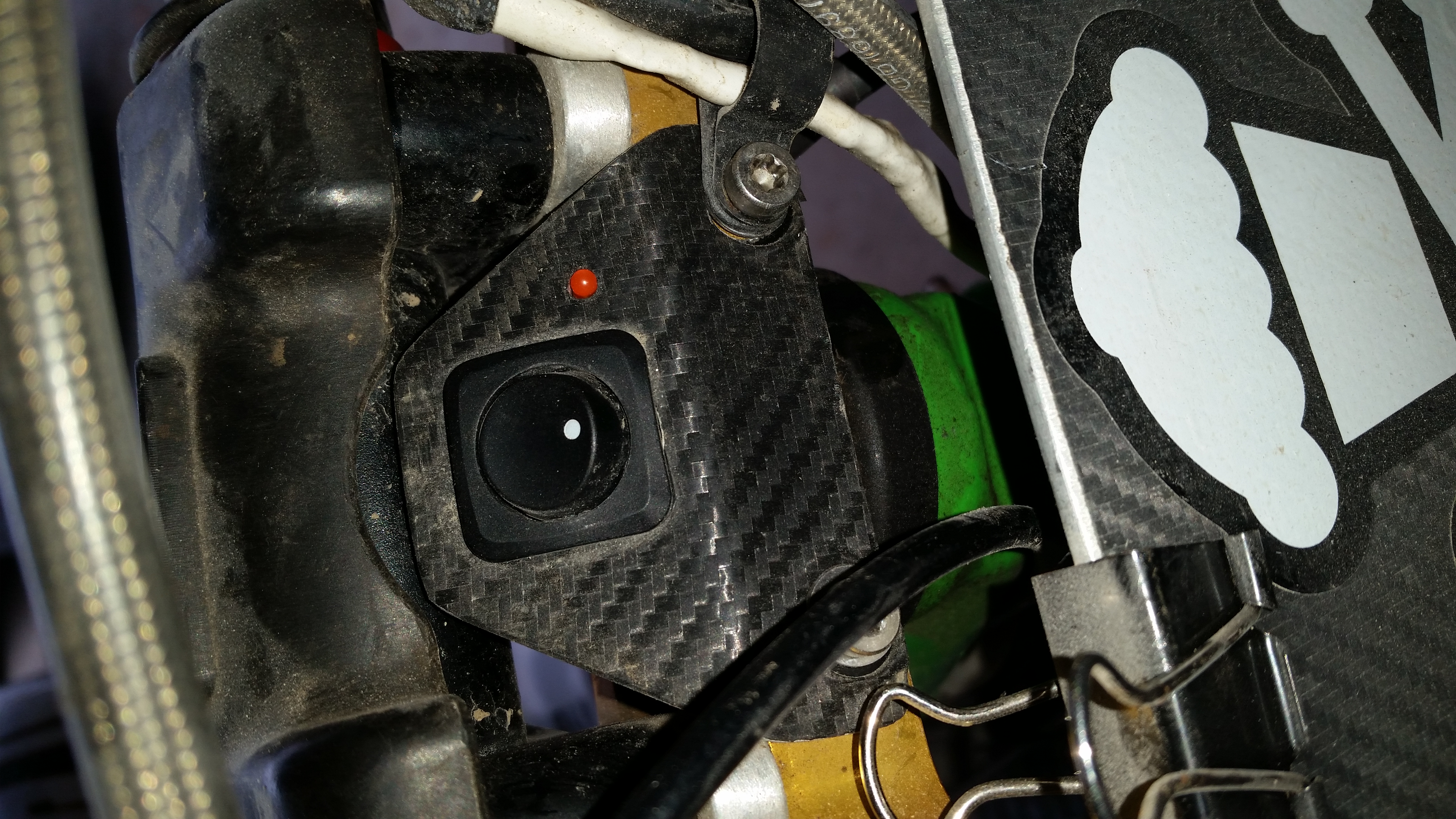

lotus54 Posted March 26, 2017 Report Share Posted March 26, 2017 I'll take a look at my Explorer and see what it has. I'm guessing an incandscent. Quote Link to comment Share on other sites More sharing options...
lotus54 Posted March 26, 2017 Report Share Posted March 26, 2017 (edited) I just looked. It is definitely an incandscent. Edited March 26, 2017 by lotus54 Quote Link to comment Share on other sites More sharing options...
canada280i Posted March 26, 2017 Report Share Posted March 26, 2017 Perfect, thanks for checking, this gives me something more to go on Quote Link to comment Share on other sites More sharing options...

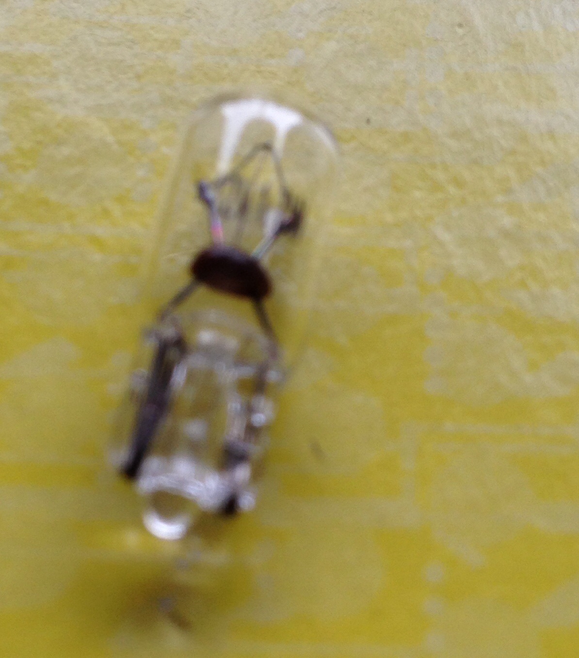

lotus54 Posted March 26, 2017 Report Share Posted March 26, 2017 Sorry for the blurry photo ( just had phone) Quote Link to comment Share on other sites More sharing options...
canada280i Posted March 27, 2017 Report Share Posted March 27, 2017 that looks like a specific type of bulb, automotive? I need to find out the voltage output from the connector and then try to find something suitable Quote Link to comment Share on other sites More sharing options...
canada280i Posted March 27, 2017 Report Share Posted March 27, 2017 Does it have any voltage ratings marked on it? Quote Link to comment Share on other sites More sharing options...
lotus54 Posted March 27, 2017 Report Share Posted March 27, 2017 (edited) I will get the number form the bulb. the gauge itself is TrailTech - I will check their site and see if they have bulbs that fit also, mark http://www.trailtech.net/digital-gauges/vapor/vapor-accessories/022-pda Edited March 27, 2017 by lotus54 Quote Link to comment Share on other sites More sharing options...
canada280i Posted March 27, 2017 Report Share Posted March 27, 2017 looks like the bulbs that are used now are all LED as the instructions indicate.....still a mystery in progress Quote Link to comment Share on other sites More sharing options...
