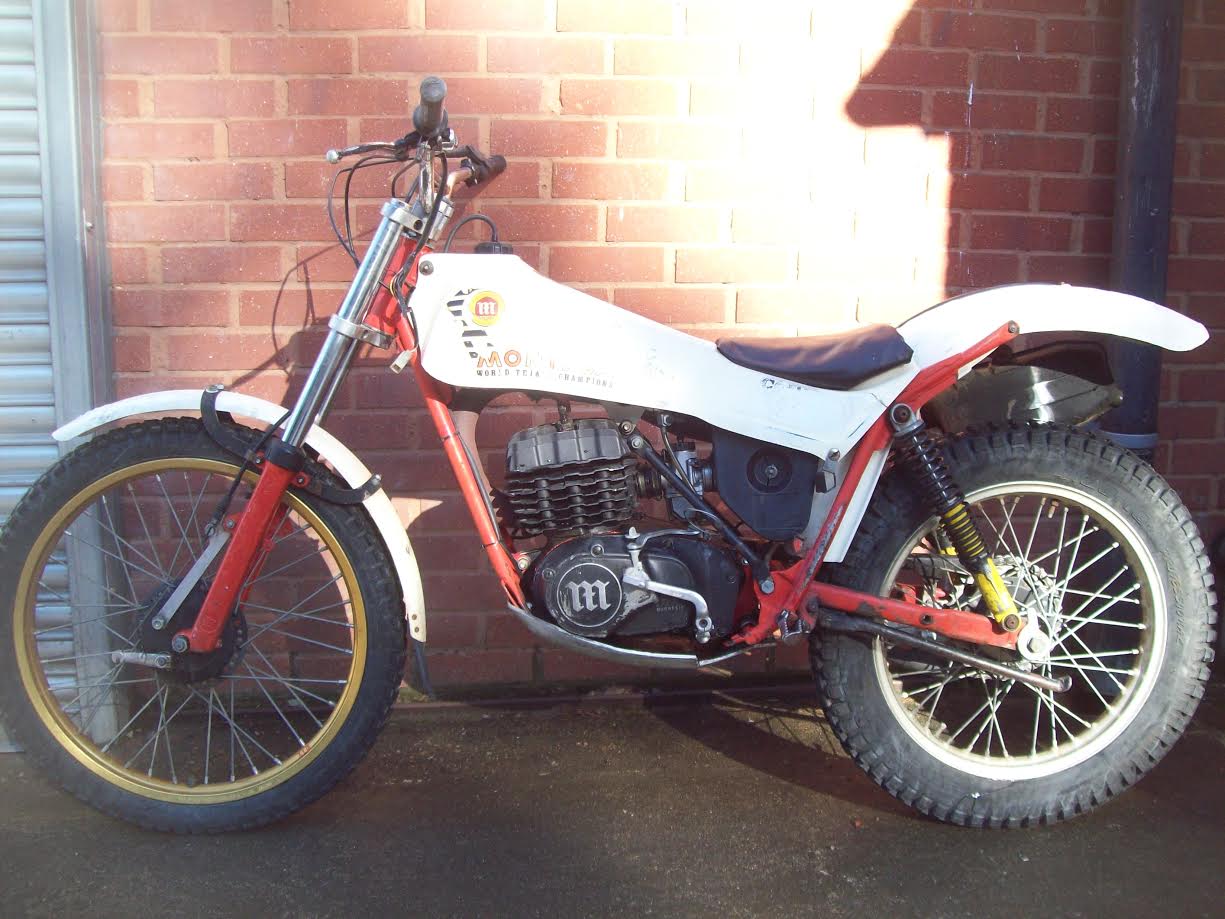

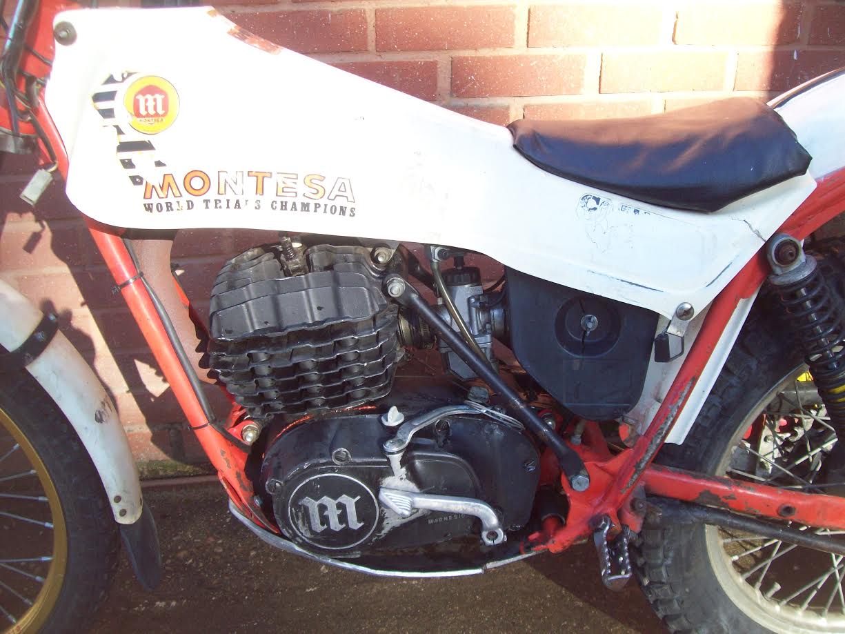

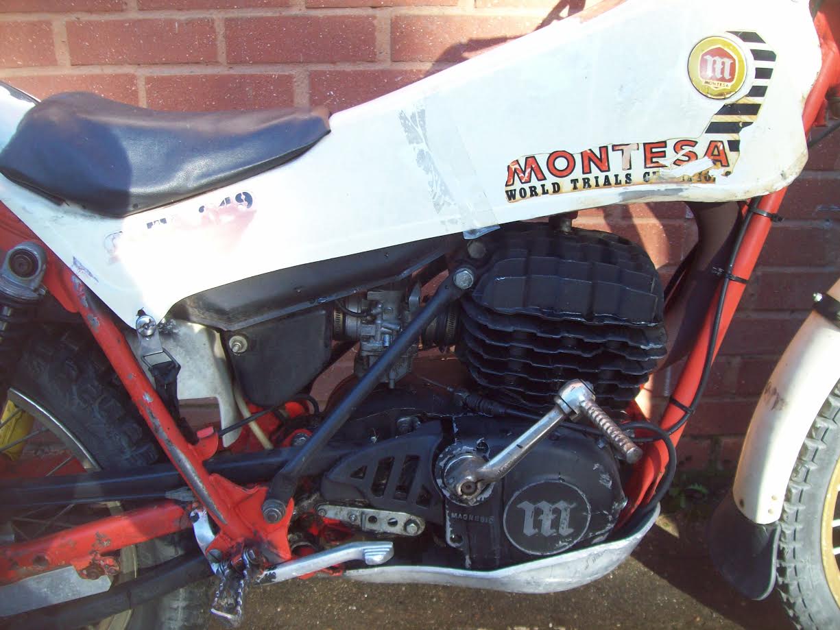

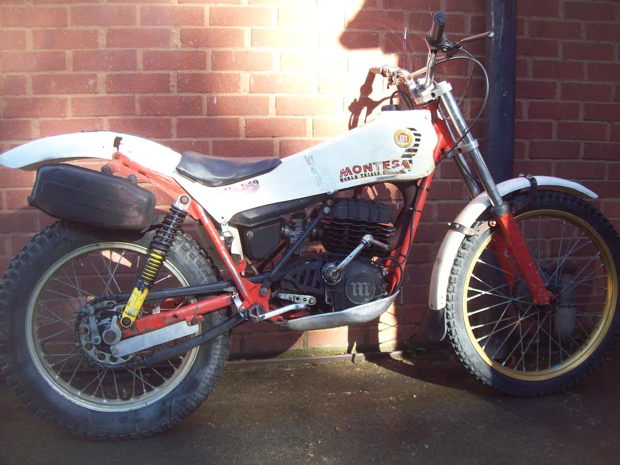

netley Posted March 20, 2017 Author Report Share Posted March 20, 2017 Hi, Just received these pics. I think I've seen info on bikes with the engine as stressed member and bashplate so I'll look around but any advice as to the exact model would be appreciated. Thanks. Neil Quote Link to comment Share on other sites More sharing options...
montesamadness Posted March 20, 2017 Report Share Posted March 20, 2017 Neil - I don't want to position myself as any sort of expert here but I think that might be a 349 not a 348. I say this because I think the 348's had frame rails running under the engine with a bash-plate bolted under them, whereas the 349 had no lower frame rails and used the bash-plate (and engine) as a stressed member. The photo isn't totally clear, but that's what it looks like. I'm sure someone with more experience will be along to give you more info though. I think the 348's were actually 306cc whereas the 349's are actually 349cc. Good news for your right-leg muscles! As long as it turns over (even if it doesn't run) and selects all (6) gears correctly then I reckon you'll be safe paying 800 for it. Even if it needed a new piston/ re-bore AND a crank rebuild you'd still get your money back (as long as you did the work yourself), 'coz it looks pretty complete apart from that.... 1 Quote Link to comment Share on other sites More sharing options...
barnesy Posted March 20, 2017 Report Share Posted March 20, 2017 Hi Neil That's defo a 349 (81 white wonder model) Cheers Guy 1 Quote Link to comment Share on other sites More sharing options...
