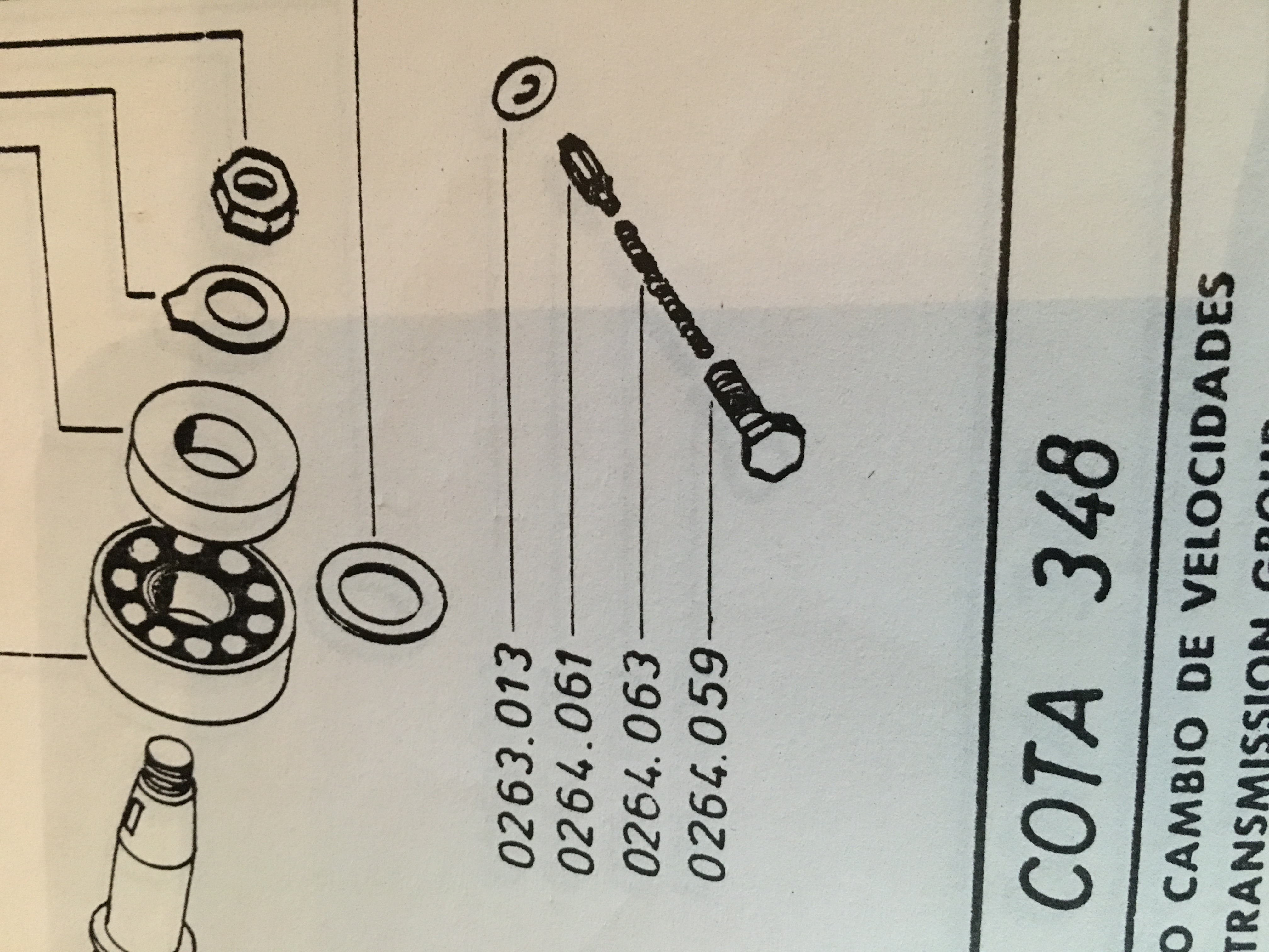

Hi,

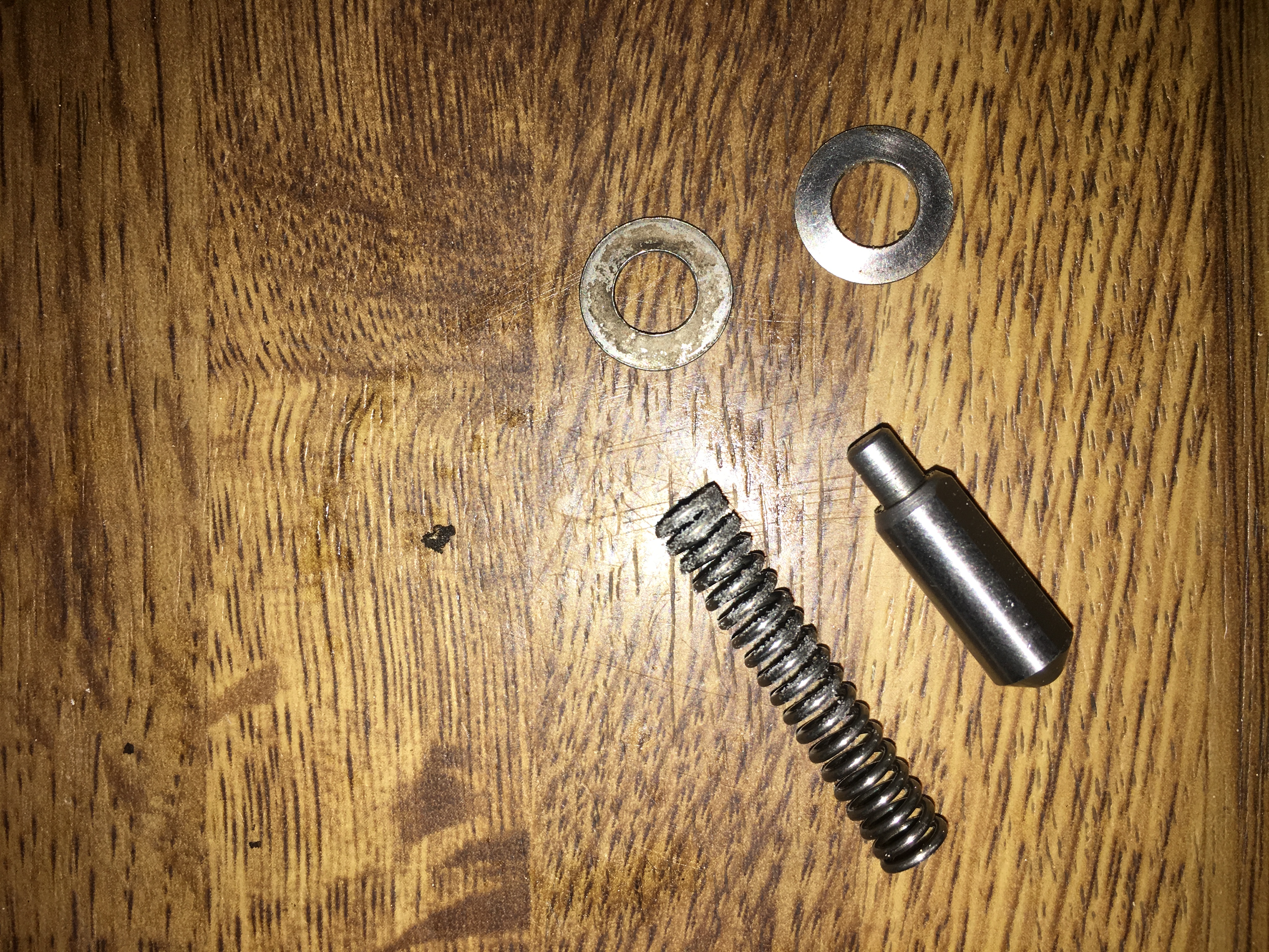

After opening the motor of a cota 348 i got a couple of washer that cannot identify. I think they are related to the part number 0263.013. But cannot find where it is the position to assembly and why two when in the manual is shown only one.
Any help is welcome
Thanks

The assembly you have shown is the gear shift detent. It is secured by a 17 mm bolt, located on the upper rear, sprocket side of the case. Detent pressure can be "adjusted" by adding or removing washers. Increasing the spring pressure will make it shift slightly harder, but with less chance of jumping out of gear.
