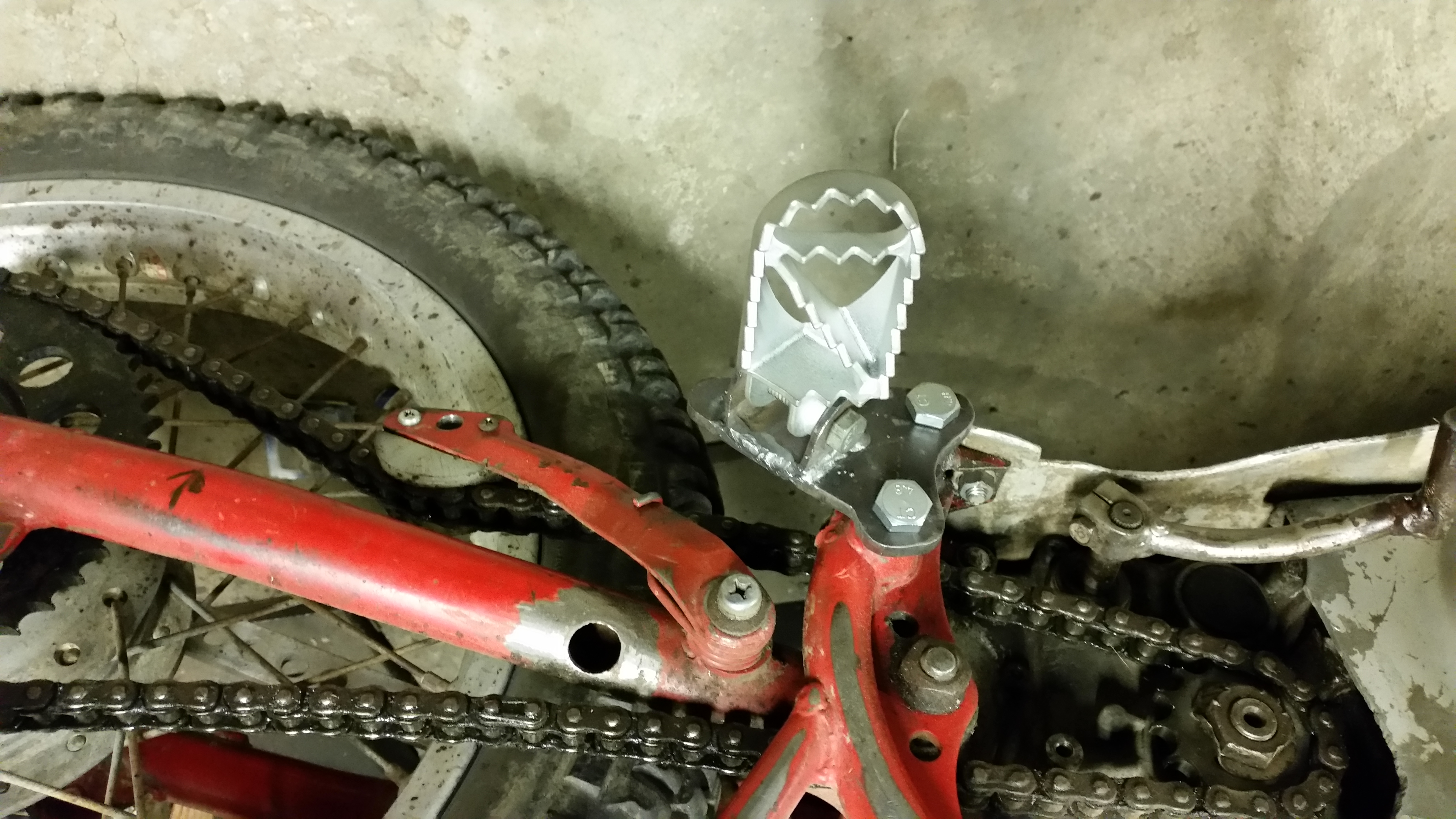

Sectioned Posted March 24, 2017 Report Share Posted March 24, 2017 Made some crude footrest hangers and mounted by the usual method, drill and tap upper hole and welded a nut inside frame on bottom rather than a threaded rod right through. These are temporary to experiment with position before I commit to weld on mounts. Yes I've put them well back and that may attract some critisism but I am tall and heavy with chicken legs so if I lean forward the front end won't be light. Footrests are from an enduro bike. Quote Link to comment Share on other sites More sharing options...
guy53 Posted March 24, 2017 Report Share Posted March 24, 2017 The first time I repositioned mine , I lowered them 1 1/4 inch and also back 1 1/4 inch. I'm 5' 8'', since than I modified 2 other TY and did the same, they feel right for me. First few ride, I mostly notice the lower position but I felt it did not made such a big difference. It's only when I swap bike with a friend who wanted to try mine that I really felt the difference. I kept the TY footrest and made them wider and longer, but the back plate look very similar to yours. Guy Quote Link to comment Share on other sites More sharing options...

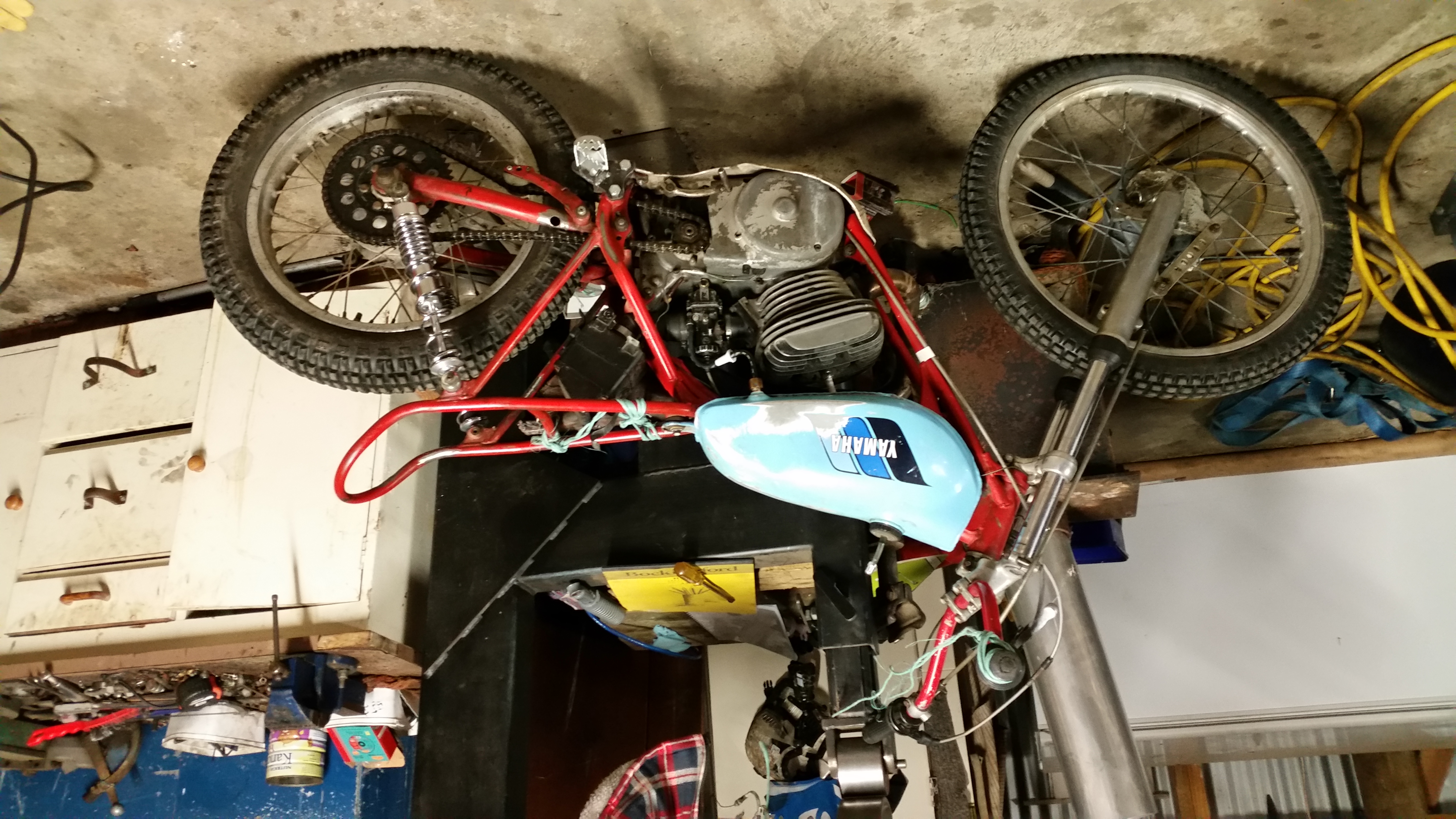

kurtas Posted March 24, 2017 Report Share Posted March 24, 2017 Made some for the TY175 out of KX65 footpegs. Bolt on replacement +/- a bit of angle grinding to the pegs for the cheese grater originals. I wonder if the northern hemisphered motherland will see your photos the right way up? 1 Quote Link to comment Share on other sites More sharing options...
Sectioned Posted March 24, 2017 Author Report Share Posted March 24, 2017 Haha kurtas I don't know what happened but if I click on them they are right way up. Guy53 I just measured mine and they are the same as yours, inch and quarter both ways. I'm 6'2 so maybe I could stand on the rear axle lugs bmx style ? Quote Link to comment Share on other sites More sharing options...
trapezeartist Posted March 24, 2017 Report Share Posted March 24, 2017 12 hours ago, theoldstuff said: Haha kurtas I don't know what happened but if I click on them they are right way up. Not in the northern hemisphere, they're not. Quote Link to comment Share on other sites More sharing options...
bullylover Posted March 25, 2017 Report Share Posted March 25, 2017 Nor in Australia. Upside down here. Quote Link to comment Share on other sites More sharing options...
feetupfun Posted March 25, 2017 Report Share Posted March 25, 2017 I find with the standard Ty250 frame you do need to be over a certain height to be able to lower them by much without it becoming a problem. I'm 1760mm 5' 10" and have a Ty250 with standard frame that I mounted them in the position you have done and found that my coccyx sometimes hit the bike behind the seat when unweighting the rear on obstacles. I figure I would have gotten used to how far I can unweight if I only rode the one bike. It did change the handling a lot Quote Link to comment Share on other sites More sharing options...
Sectioned Posted March 25, 2017 Author Report Share Posted March 25, 2017 My coccyx hasn't hit anything for a few weeks ; ) May cut the rear loop off if it causes problems. 1 Quote Link to comment Share on other sites More sharing options...
