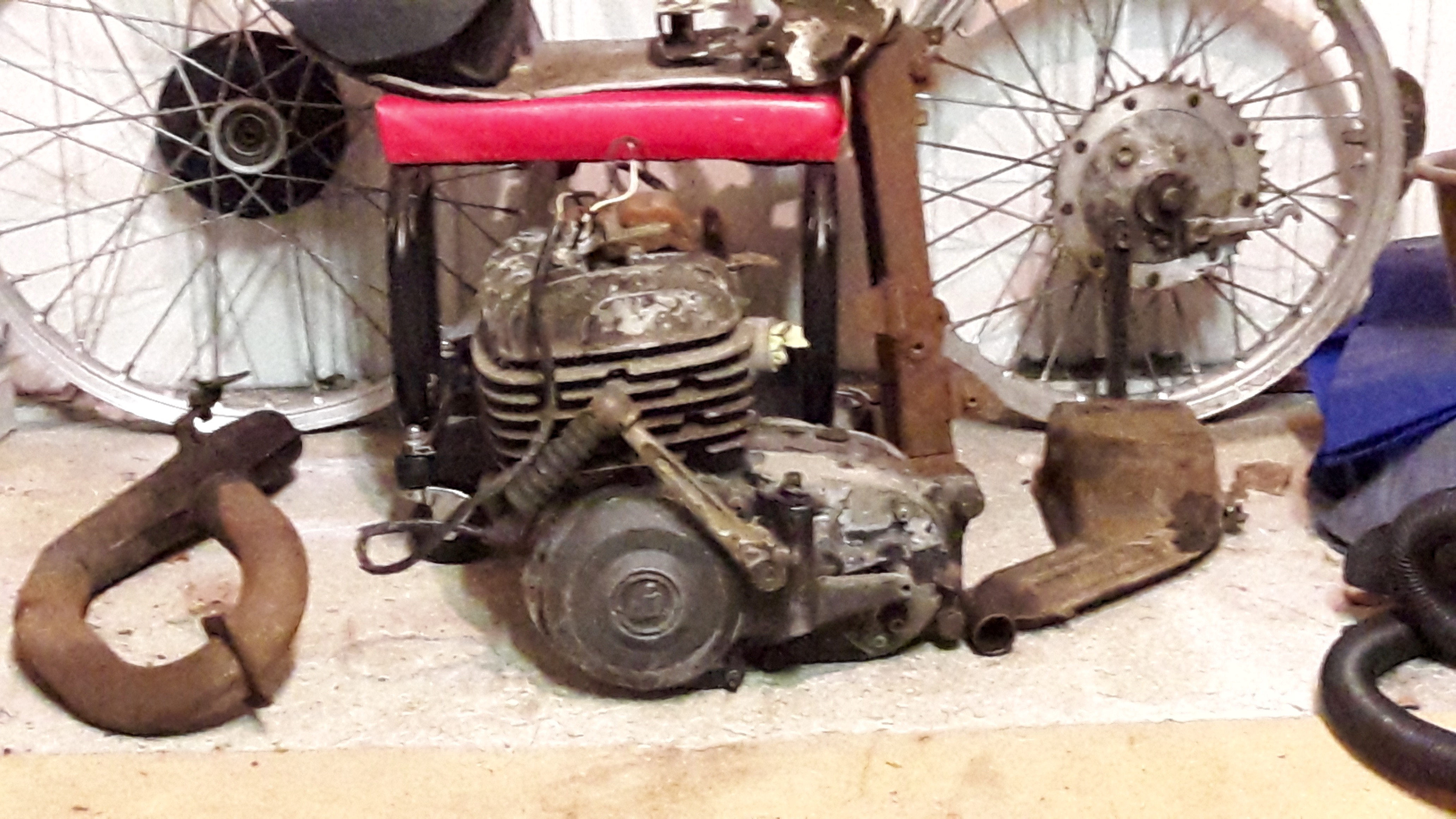

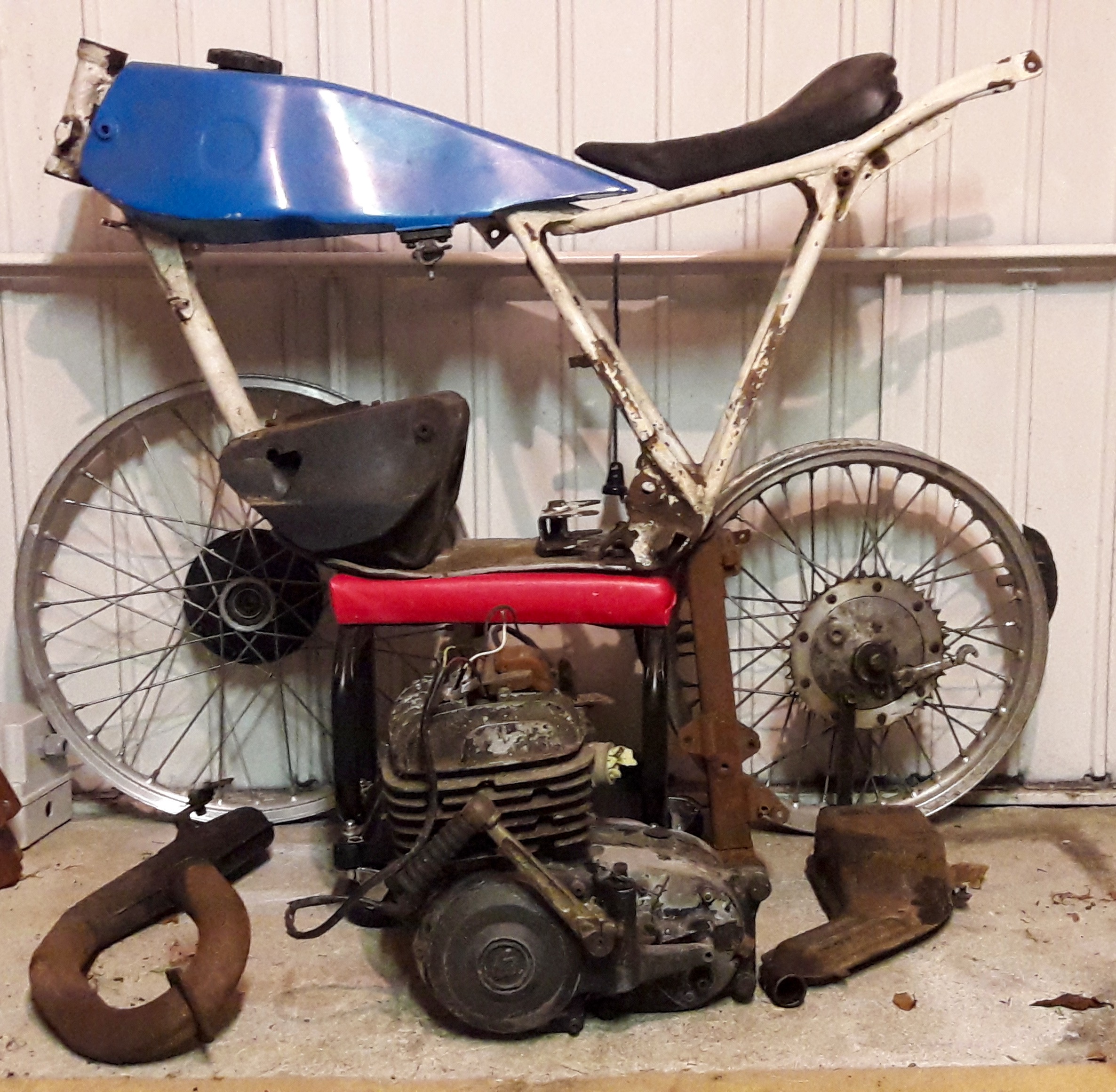

model80 Posted March 27, 2017 Report Share Posted March 27, 2017 Just took possession of my new 199B project today. Always had an itch to scratch when it came to the 340, 6 speed Sherpa's. So after nearly a quarter of a century "looking out" for one, I need look no longer. Yeah, there is lots to be done, but heaps of new ideas to try out. Electronic ignition, Dellorto or Mikuni carb, what suspension set up will I go for etc, etc..... Will keep you all updated on here on my progress 6 Quote Link to comment Share on other sites More sharing options...

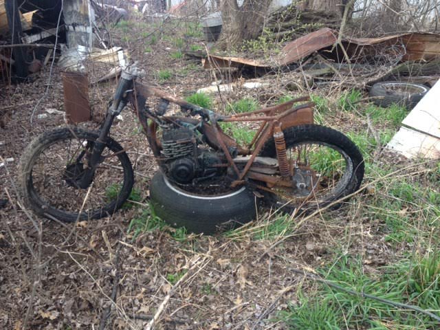

scot taco Posted March 28, 2017 Report Share Posted March 28, 2017 Nice find! I,m sure after such a long search that it will be a labor of love so it will be fun. Also nice to bring it back to life and keep it from being parted out. They are super rare over here.This is the closest I ever got to getting one,but even that would have been a long shot as I was a third party in the deal and the second fellow would have probably got it first. Have fun and keep us posted. 1 Quote Link to comment Share on other sites More sharing options...

model80 Posted March 28, 2017 Author Report Share Posted March 28, 2017 Thanks guys for the kind words. Yes, it's in a bit of a state alright, but its all repairable or replaceable. I made good progress today, got my local welder who also happens to be a big Bulto fan, lined up to repair a cracked tube in the frame. Also have the frame, swinging arm and rear engine bracket booked in for medium blasting and painting. I have now got everything catalogued and a list of spares that will be required. Luckily I was just about to start a 199A restoration before the "B" happened along and I had already acquired a lot of spares for that restoration. So now I just basically need is a new airbox, side panels, saddle and a pair of white mudguards. Unfortunately my poor old 199A will have to say in hibernation a bit longer until I've got the "B" up and running. The plan for the moment is to work on the frame and cycle parts, get that all sorted and assembled, then delve into the engine and gearbox. Will definitely go with electronic ignition and use the Mikuni carb I have planned to use on my 199A. Ironically both bikes came to me without carburettors, no loss really as I was never a fan of the Bing carb, way to fragile and finicky in my experience. Will post up photos every once in a while as progress reports. 3 Quote Link to comment Share on other sites More sharing options...

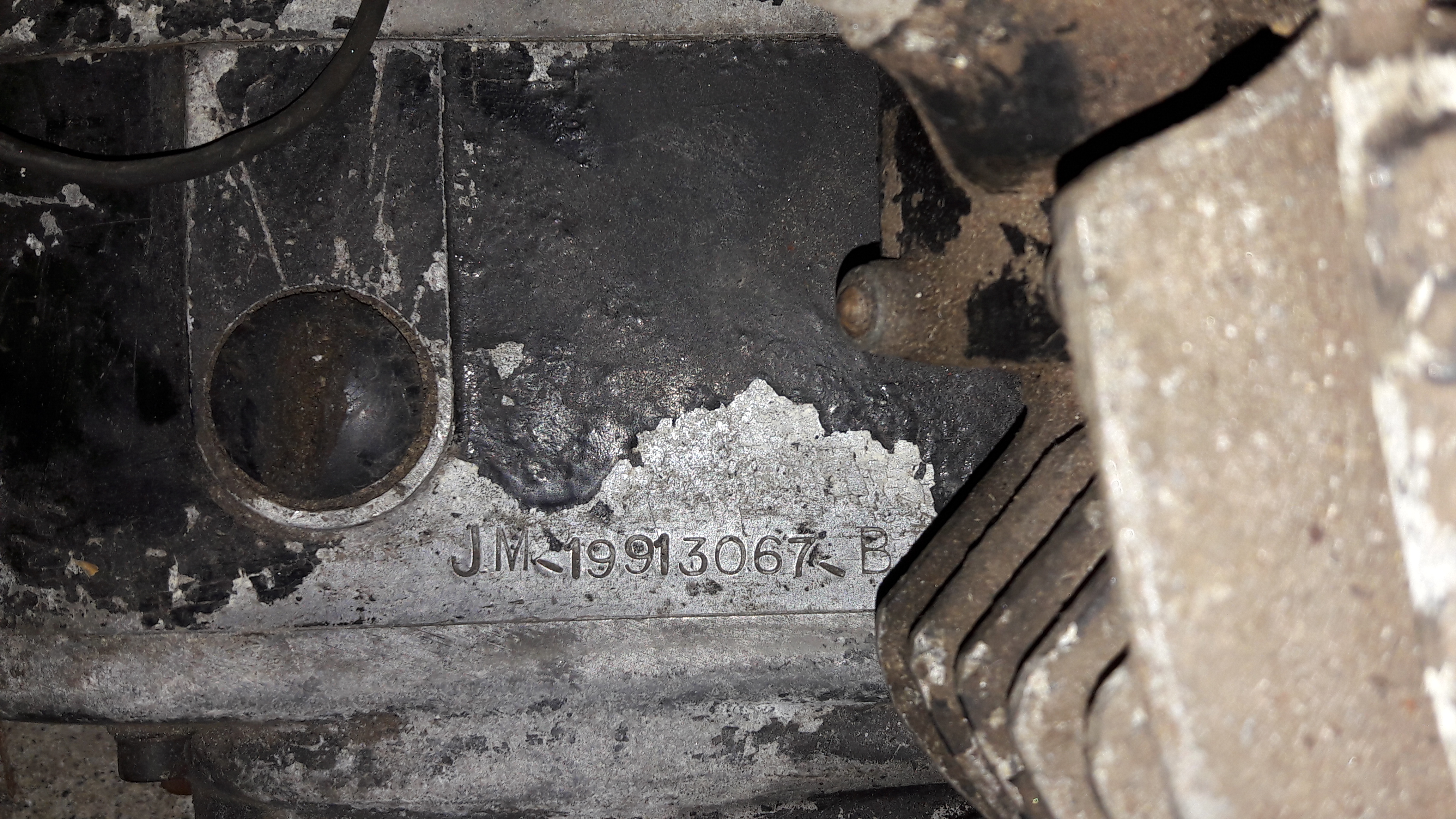

sherpatenzing Posted March 31, 2017 Report Share Posted March 31, 2017 On 3/27/2017 at 11:10 PM, pschrauber said: That is quite an early bike one of the first 200! May the force with you that's a BIG project! Expand My 340 engine number is 199-13040-B. Anyone got anything earlier? Quote Link to comment Share on other sites More sharing options...
