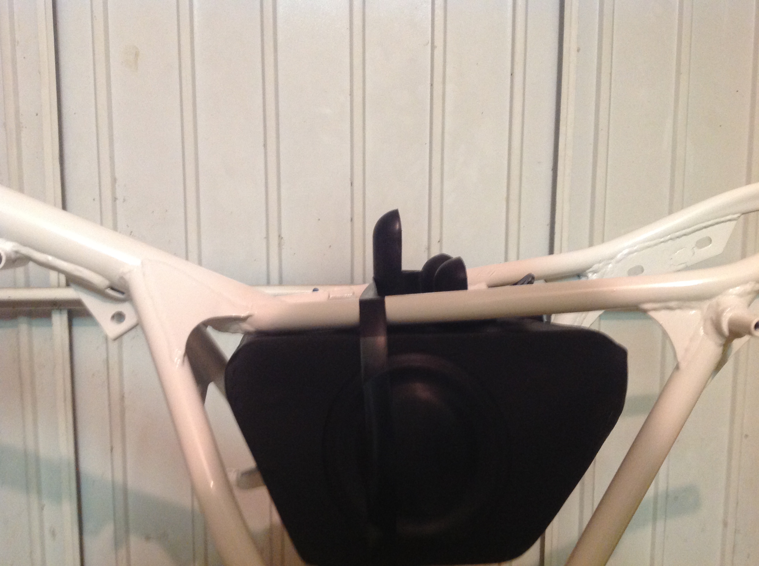

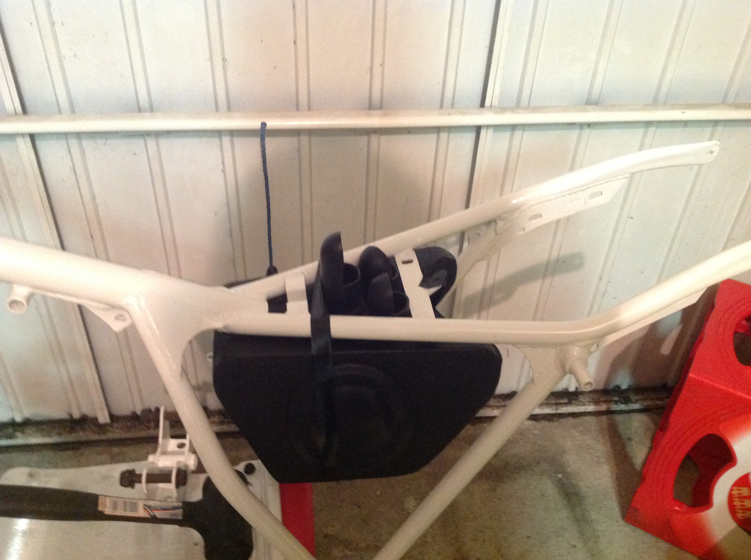

model80 Posted August 17, 2017 Author Report Share Posted August 17, 2017 (edited) Alright lad, I going to go at this from a different angle, as I find your response confusing and I fail to understand it! My dilemma is as follows, I recently purchased a new airbox and when I attempted to bolt the seat on top I cannot get it to fit properly without squashing the tallest snorkel. Many thanks. Pat Edited August 17, 2017 by model80 Quote Link to comment Share on other sites More sharing options...
stevem75 Posted August 18, 2017 Report Share Posted August 18, 2017 They need to be inside the air box. You have them inside out. Steve 3 Quote Link to comment Share on other sites More sharing options...
