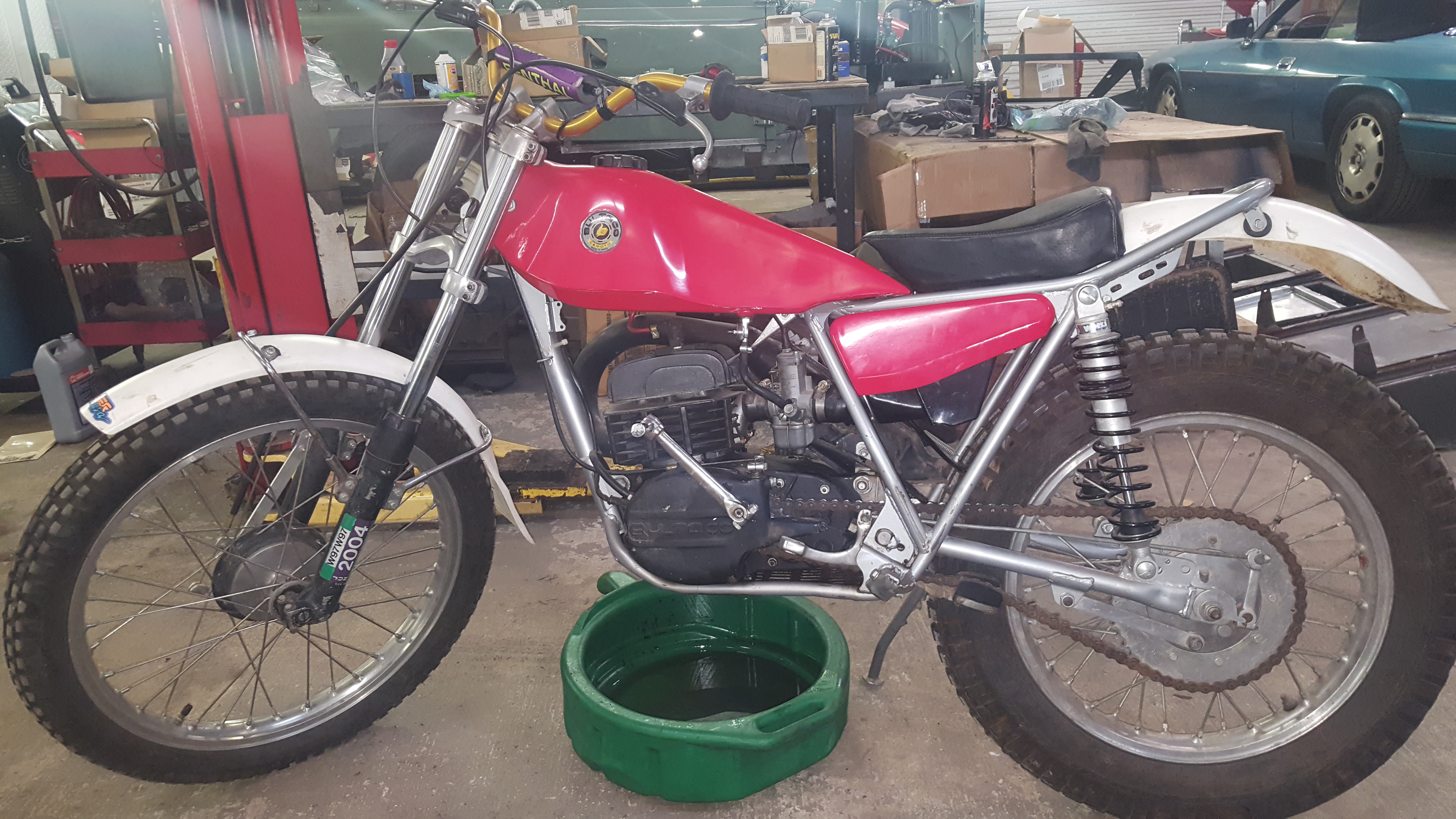

jontribe Posted April 10, 2017 Report Share Posted April 10, 2017 Hi Chaps, I acquired a model 199! I got it back from CA, better condition that I had thought it would be! Looked it over, oiled the cables etc. drained and refilled the oils (what there was of it, not much!) Runs really nice, clutch a bit draggy though, I put in 30 weight, as per the manual, was thinking, is there anything better, thinner perhaps TQF or would that be bad?? Any advice/ideas would be appreciated! TIA 1 Quote Link to comment Share on other sites More sharing options...
pschrauber Posted April 10, 2017 Report Share Posted April 10, 2017 ATF or Elf HTX 740. ATF is cheaper works btw. much better then SAE 30 and too then SAE 140 in the gear box. 1 Quote Link to comment Share on other sites More sharing options...
dadof2 Posted April 11, 2017 Report Share Posted April 11, 2017 SAe 5w - 30 or SAE 10W - 30 mineral or semi synthetic. Castrolite SAE 10W - 30 used to work well. I would think ATF would also - Dexron 2 or 3. More modern grades such as the ELF HTX or dexron 6 may cause clutch slip on older bikes. 2 Quote Link to comment Share on other sites More sharing options...
sherpa325 Posted April 11, 2017 Report Share Posted April 11, 2017 I have been using Elf htx 740 for over 10 yrs now and it is with out a doubt the best oil I have used. Started using it in my Gasgas originally as its the only oil that stops clutch drag and allows me to find neutral easily. Some where years ago someone told me it was developed for motoGP bikes as a low friction oil to increase HP, not sure if that's true but who knows. I also use it in Bullys along with fibre clutch plates and once again, neutral is easy to find, no clutch drag or slip when starting and using the bike. I dont use it in the bully gearbox because it is really thin and if you drop the bike it pours out through the vent hole whereas conventional gearbox oil doesn't. GRO also make a really light oil that is really good also.Hope this helps cheers Greg 3 Quote Link to comment Share on other sites More sharing options...
