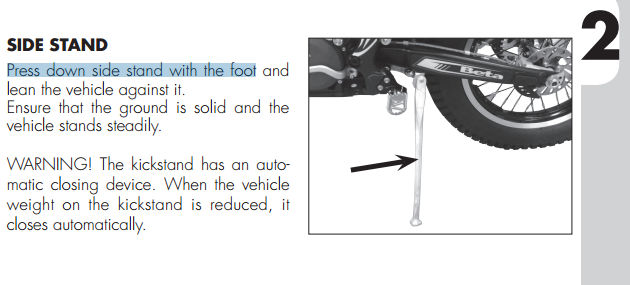

harryharls Posted April 23, 2017 Report Share Posted April 23, 2017 Ha ha great point!! We're tied up in knots with bureaucracy!! I'm beginning to think I might be missing something with my side stand, have a look at the excerpt from my user manual about the side stand: ('press down side stand with the foot')...how?? Quote Link to comment Share on other sites More sharing options...
Frankm7894 Posted June 29, 2022 Report Share Posted June 29, 2022 Thanks for the tip. I just did it to my new evo. I thought I needed to take the spring off and reverse the bracket and that was a bear to do. Then I had to put it back on. Wish I had read your post before all that. It’s a shame the owners manual doesn’t include that info. Thanks again. Quote Link to comment Share on other sites More sharing options...
