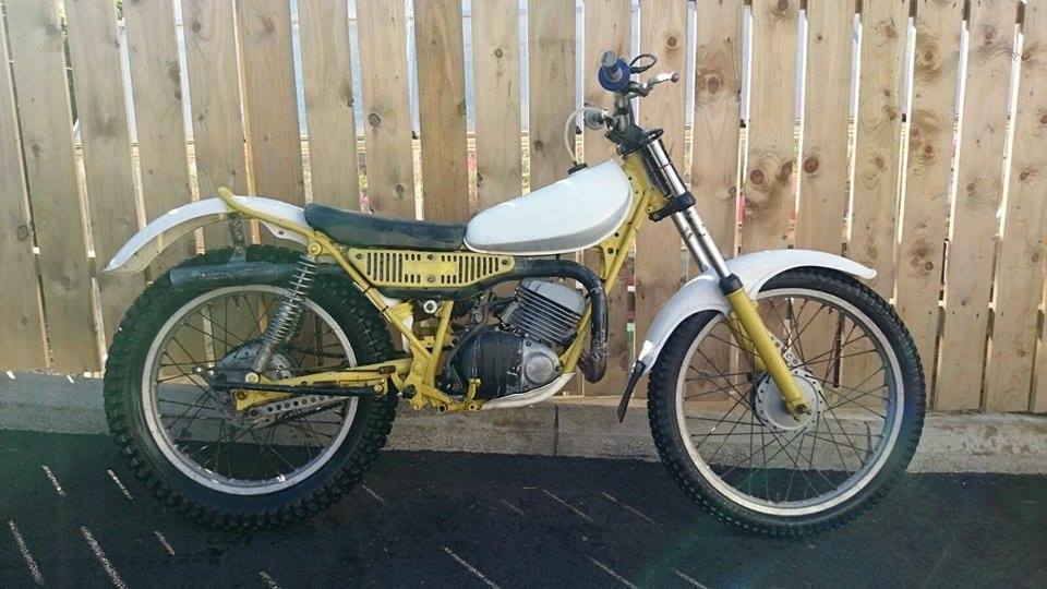

doogle Posted April 25, 2017 Author Report Share Posted April 25, 2017 Its like this one but shorter. I'll just estimate off the picture. Cheers Quote Link to comment Share on other sites More sharing options...
doogle Posted April 25, 2017 Author Report Share Posted April 25, 2017 https://i.ebayimg.com/00/s/NTQwWDk2MA==/z/QMQAAOSw4HVWEmmK/$_86.JPG try again... Quote Link to comment Share on other sites More sharing options...
feetupfun Posted April 25, 2017 Report Share Posted April 25, 2017 (edited) Here is a what a standard stand looks like on a standard swingarm. And thanks to whoever shared this lovely photo on the internet. Edited April 25, 2017 by feetupfun I forgot something Quote Link to comment Share on other sites More sharing options...
feetupfun Posted April 25, 2017 Report Share Posted April 25, 2017 No point you copying the length of a standard stand because your bike is too high for that. Just fit blocks of wood under the stand until you get your bike to stand at the angle you want, then add the thickness of the blocks to the length of the stand 2 Quote Link to comment Share on other sites More sharing options...
