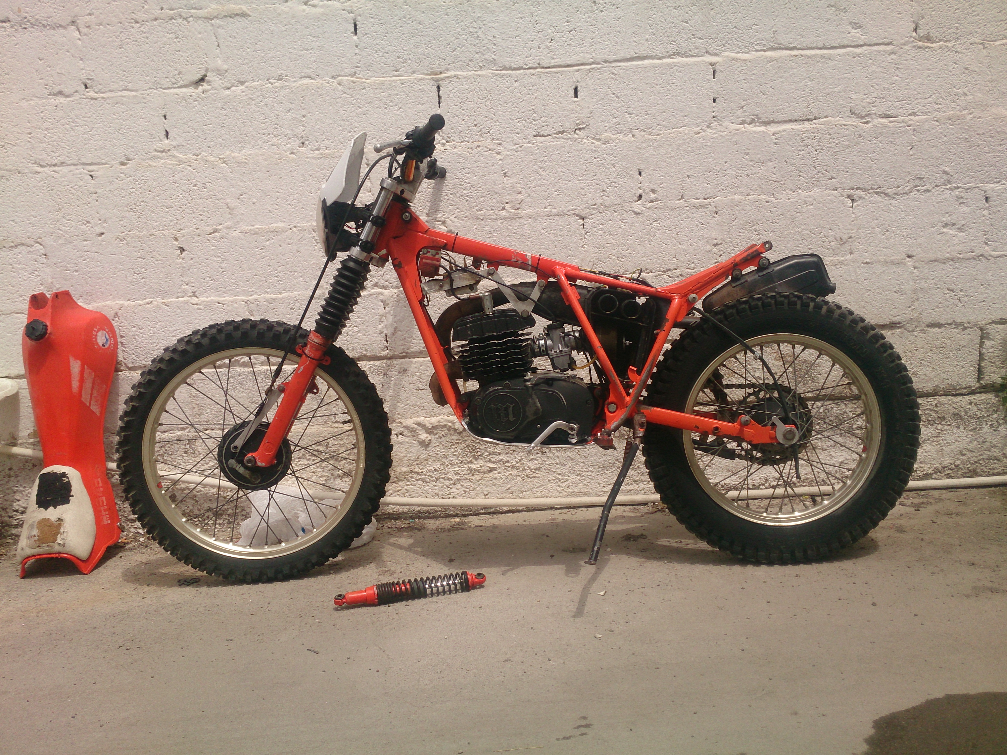

dr770 Posted May 6, 2017 Author Report Share Posted May 6, 2017 Hi Here are few more pics. I couldn't stop myself from taking it apart. It has a broken air box, but luckily ex owner put a kone filter in there bit with a narrow connection about 30 mm Exhaust is leaking heavily from the silencer inlet Take one of the shocks apart. See it can be rebuilt. The valf spring inside is broken. Not sure if the seals are ok. I really need some information on rebuilding these shocks. The fork isn't feeling ok. I couldn't find a clue it is bent, but it doesn't operate smoothly, any info on rebuilding these? Someone has been played.with electrical system. The book i jave.states that cota is 6v system but this one seems to be 12. There is a rectifier and some.relays for headlight and horn. I want to get rid of them anyway but affraid to ruin something before undetstanding what is what Front brake pivot tread is completely gone, i should retap it with m12 i guess That's all for now.... Quote Link to comment Share on other sites More sharing options...
cleanorbust Posted May 6, 2017 Report Share Posted May 6, 2017 Stripping the forks should be fairly straightforward. You'll have to unscrew the allen bolt in the bottom end of each slider, holding the internals to stop them spinning as you turn the bolt. Be sure to fully unweight the front end when you unscrew the fork caps (bike on a box or stand with wheel off the ground) as they have very fine threads which can get damaged if there is much pressure on them from the fork springs just before they come to the end of the thread. 1 Quote Link to comment Share on other sites More sharing options...
dr770 Posted May 6, 2017 Author Report Share Posted May 6, 2017 On 5/6/2017 at 6:30 PM, cleanorbust said: Stripping the forks should be fairly straightforward. You'll have to unscrew the allen bolt in the bottom end of each slider, holding the internals to stop them spinning as you turn the bolt. Be sure to fully unweight the front end when you unscrew the fork caps (bike on a box or stand with wheel off the ground) as they have very fine threads which can get damaged if there is much pressure on them from the fork springs just before they come to the end of the thread. Expand Thanks, where can i find info on refurbing rear shocks. Searching the web for hours but didn't cone by a shock with similar internals. I think this is a twin tube design but base valf system seems to be located on the damping rod :-( i am confused.... Quote Link to comment Share on other sites More sharing options...
2stroke4stroke Posted May 6, 2017 Report Share Posted May 6, 2017 Could be a non-standard coil, that metal plug cap is definitely not original. Gearchange mechanism can be fragile - I'd raise the gear lever to avoid hitting rocks. Posssibly Marzocchi rear suspension? Bits for rebuild should be obtainable even though they stopped making motorcycle stuff a couple of years ago. It won't run at its best with the altered air filtration arrangement, this might be part of your problem. Quote Link to comment Share on other sites More sharing options...
dr770 Posted May 7, 2017 Author Report Share Posted May 7, 2017 On 5/6/2017 at 8:36 PM, 2stroke4stroke said: Could be a non-standard coil, that metal plug cap is definitely not original. Gearchange mechanism can be fragile - I'd raise the gear lever to avoid hitting rocks. Posssibly Marzocchi rear suspension? Bits for rebuild should be obtainable even though they stopped making motorcycle stuff a couple of years ago. It won't run at its best with the altered air filtration arrangement, this might be part of your problem. Expand I have inspected the shocks again, they are betor shocks. The cap is not plugged it is treaded which is good. The seals are far gone and internals seems to be ok except a spring. But i can make new springs, no problem. Will try to find oil seals. Air filtration is terrible, there is only 25 mm air passage behind the cone filter. This can lead to wrong operation of air correctors. There is big repair on fuel valve on the gas tank. The threaded inserts in the plastic tank came out.The air filter box had a big hole. I am repairing them at the moment but i can't share more pics i think there is a limit which i wasn't aware and i have used it all by mistake. The engine seems to be picking up fine but then it loses power when i am expecting it to kick in. After air filter system is ok i will try to deal with the timing. I hope the needle jet is in good shape, that will be difficult for me to source one. Quote Link to comment Share on other sites More sharing options...
