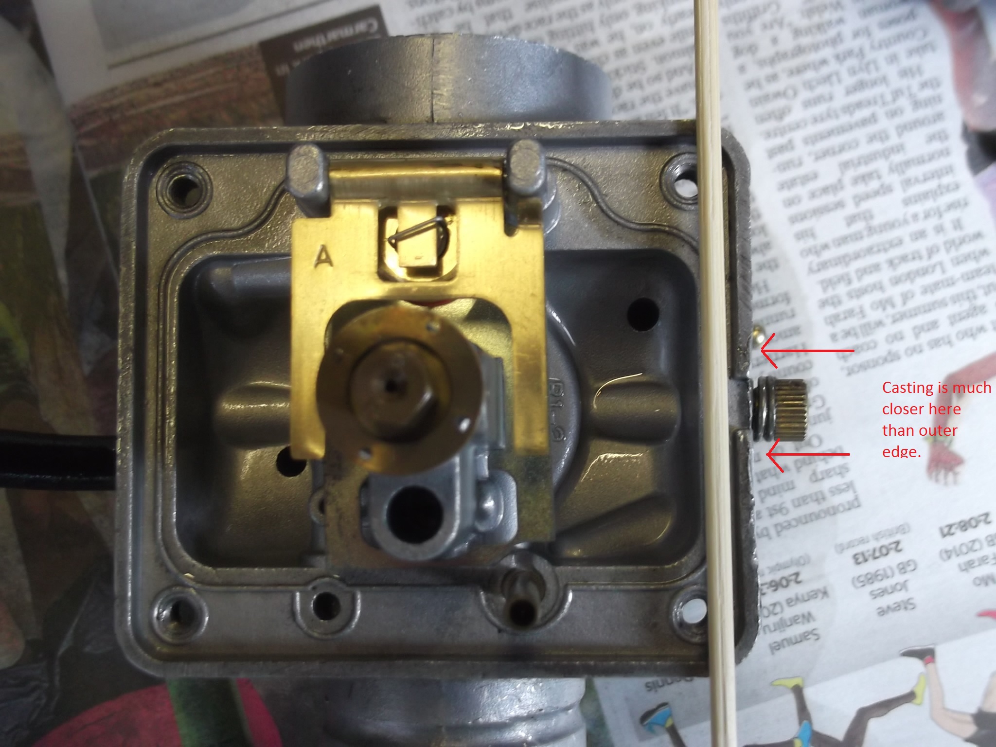

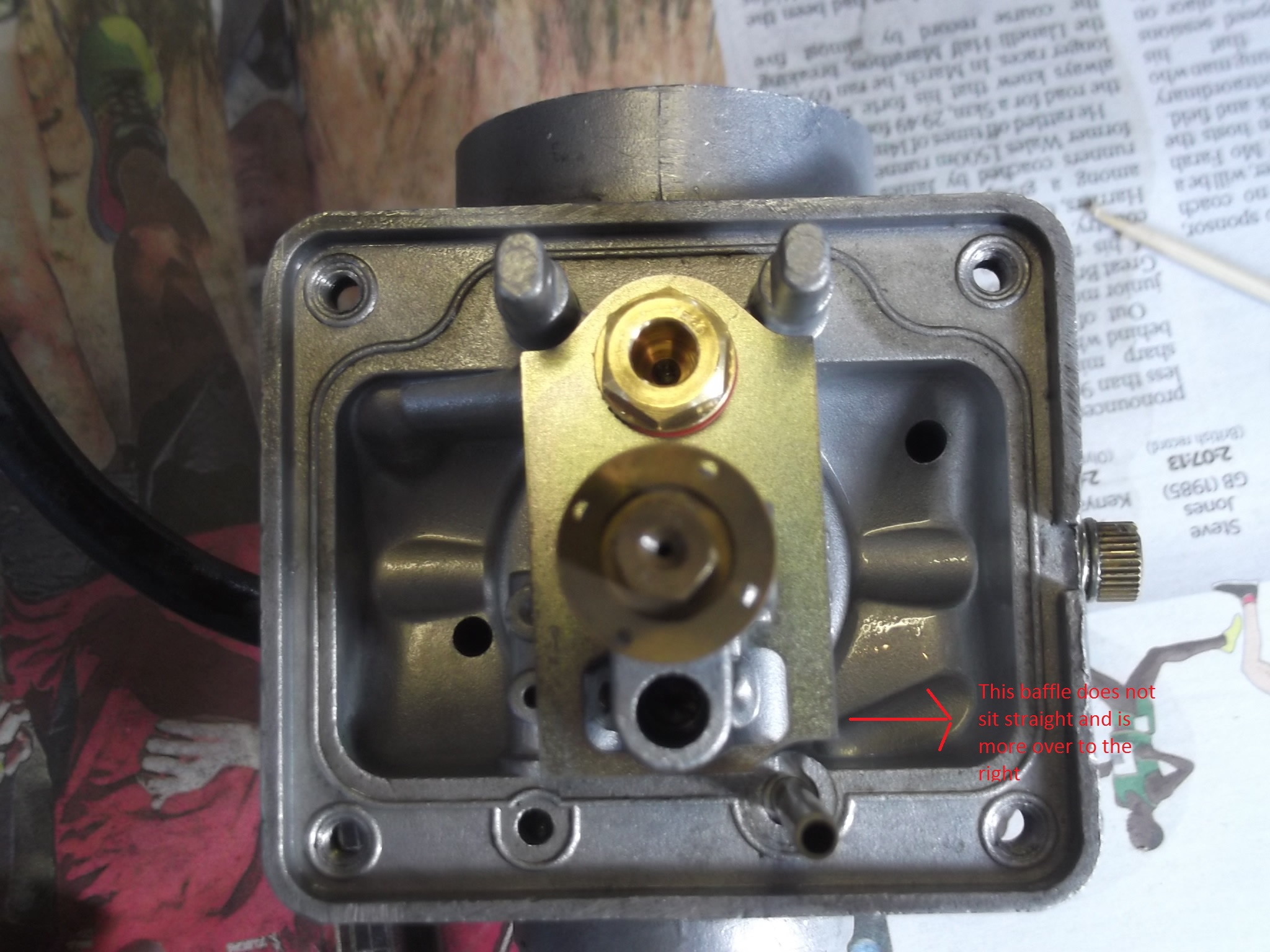

betabell Posted May 12, 2017 Author Report Share Posted May 12, 2017 Hello Billy I will answer all your questions when I have a bit more time, but thanks for all your help. I have a taken a couple of photos prior to seeing you post. My camera is a bit rubbish so I could not get a great photo of the mark in the float bowl that you requested. I will try and borrow a better camera. I have taken a couple of pictures of the side casting that is not straight and also the baffle again that is not straight. I am not sure if they are relevant or not. Maybe the float could rub against the baffle? Quote Link to comment Share on other sites More sharing options...
