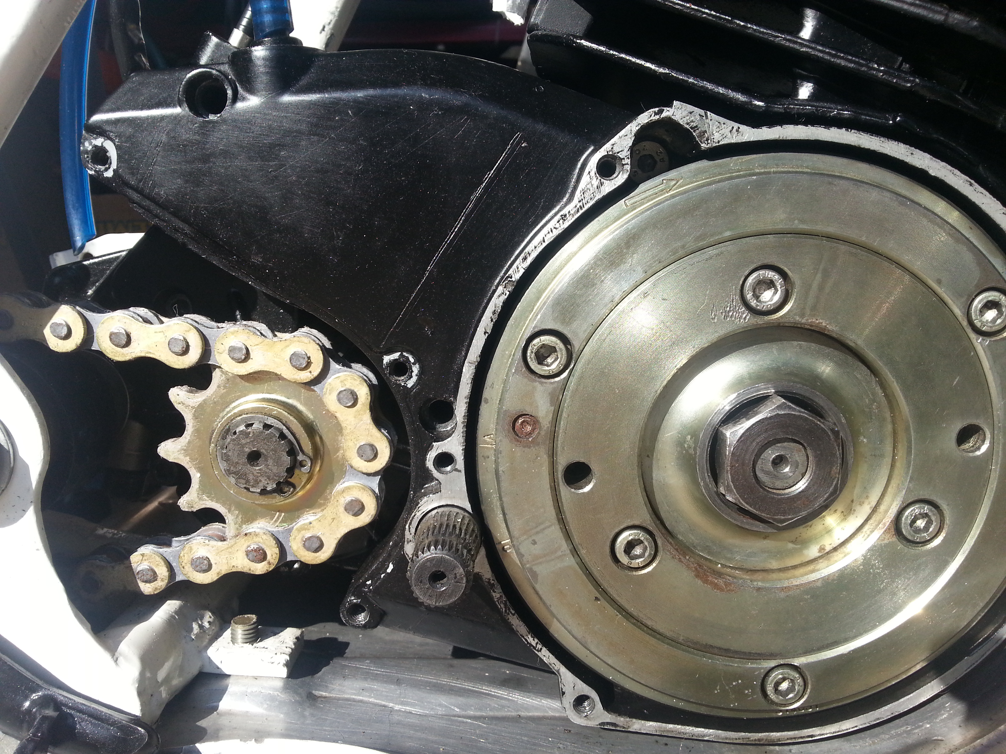

the outlaw Posted May 10, 2017 Author Report Share Posted May 10, 2017 On 5/7/2017 at 7:33 PM, scorpa250 said: ''Remove the flywheel cover and in the top left hand side is a slotted screw remove that and you can now pull out the clutch arm, on the bottom corner is where the push rod makes contact . remove the large center screw in the clutch cover and you can access the push rod this end , you should be able to see if there is a problem'' . Expand Hi scorpa250/ Letting you know I tried your advice and removed the flywheel cover and sprocket guard but it doesn't reveal (unless I'm missing something - see pic) any slotted screw in the top left side. Do I need to remove the flywheel itself and the next layer of engine casing possibly? This presumably entails the need for a flywheel holder and puller? Any advice - if you've had experience of getting to this screw that holds the clutch arm - appreciated. Nigel (theoutlaw) Quote Link to comment Share on other sites More sharing options...
scorpa250 Posted May 11, 2017 Report Share Posted May 11, 2017 Yes you need to remove the flywheel , and the inner case then you can see the screw Quote Link to comment Share on other sites More sharing options...
