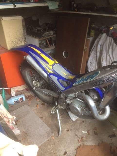

I've never owned a trials bike, but I've done an hour on a 125 at bumpy and it was quite fun.
I've been offered a Gas Gas from a colleague, he said it was running before he put it in the garage a couple of years ago. Possibly a 95.
Is it a good buy for just over £500? What should I be looking for? Common issues?
Thanks

So, I bought the bike. I took the front forks off and got it in the back of my nissan note with ease.
I didn't try and start it when looking it over, it had a good spark, all bearings are good. Fairly new chain and sprockets. Lower suspension has a fair bit of up and down play though. Tyres are fairly new and I was surprised they'd not cracked.
Brought it home. Drained the tank. Pulled the carb and gave the jets a blast with air. The fuel strainer was clogged so I gave that a blast too.
Reassembled and give it a kick and it fired straight up. Exhaust seems to have a few places where it's leaking and it's a little louder than I'd like, but it seems like a good buy. I'll have to research my options with that.
Callipers are a bit gunky so they'll need a clean up, I'll change coolant and brake fluid while I'm at it.
What oil is recommended for the gearbox? Also what ratio is recommended for the fuel?
It's road reg too.
