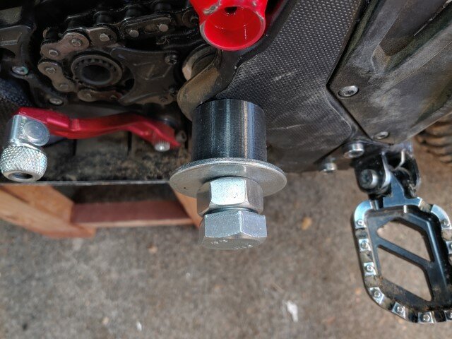

M20 bolt works fine.  You can use a nut / washer and a piece of tubing to use it the same way a flywheel puller works.  This way no need to bang / pull etc...  Works like a charm.
Getting back stuff together is another story tho...  You can't bang the 1/2 axels back in as the edges are not tapered.  What I did was to really carefully visually align everything then gently pushed in the 1/2 axles.  Take a little bit of doing and about 3 hands 😁
Expand
Also, for anyone taking it apart, loosen the 4 screws on the bottom of the skid plate, before removing/installing the Swingarm Pivots.
