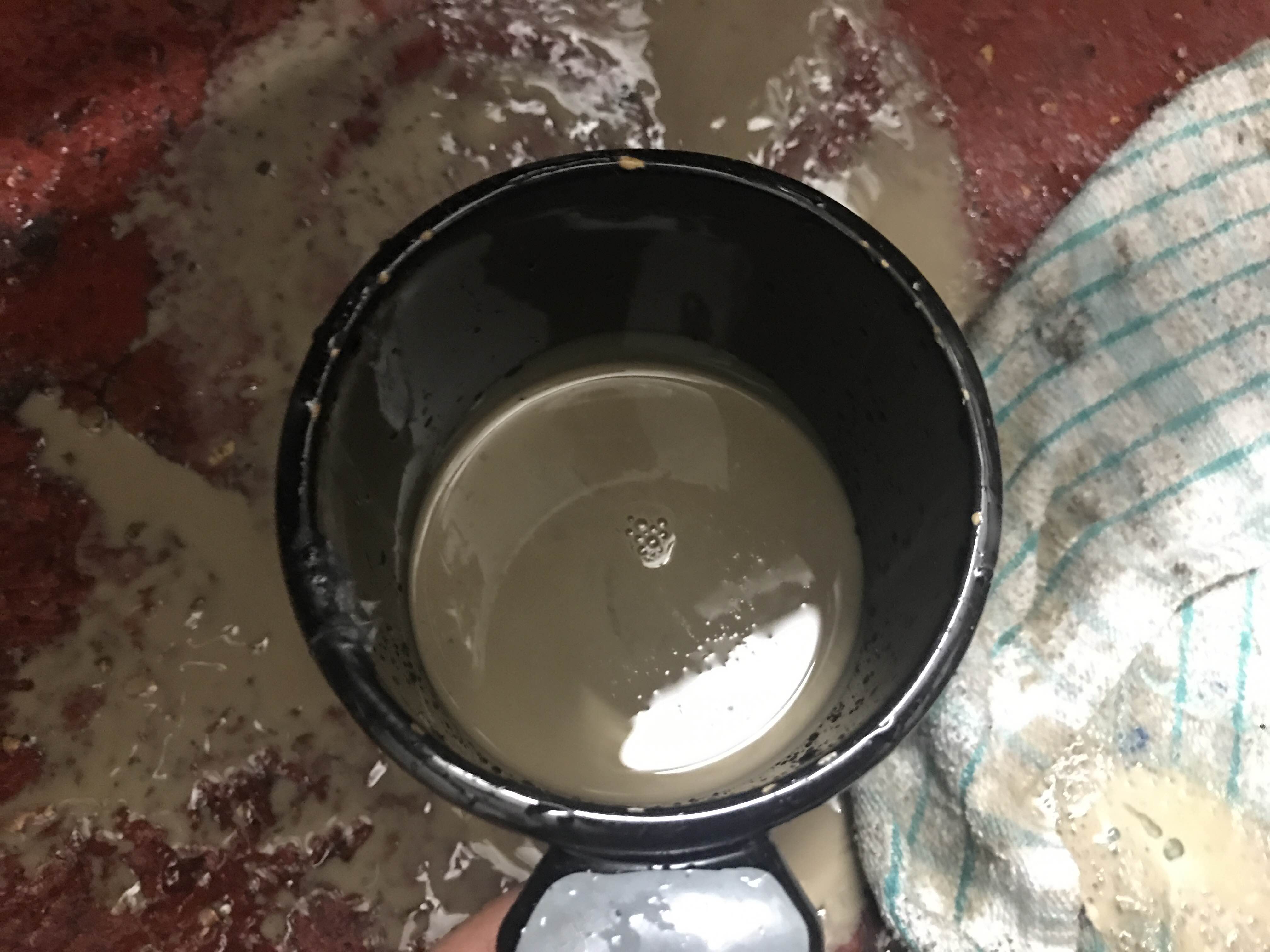

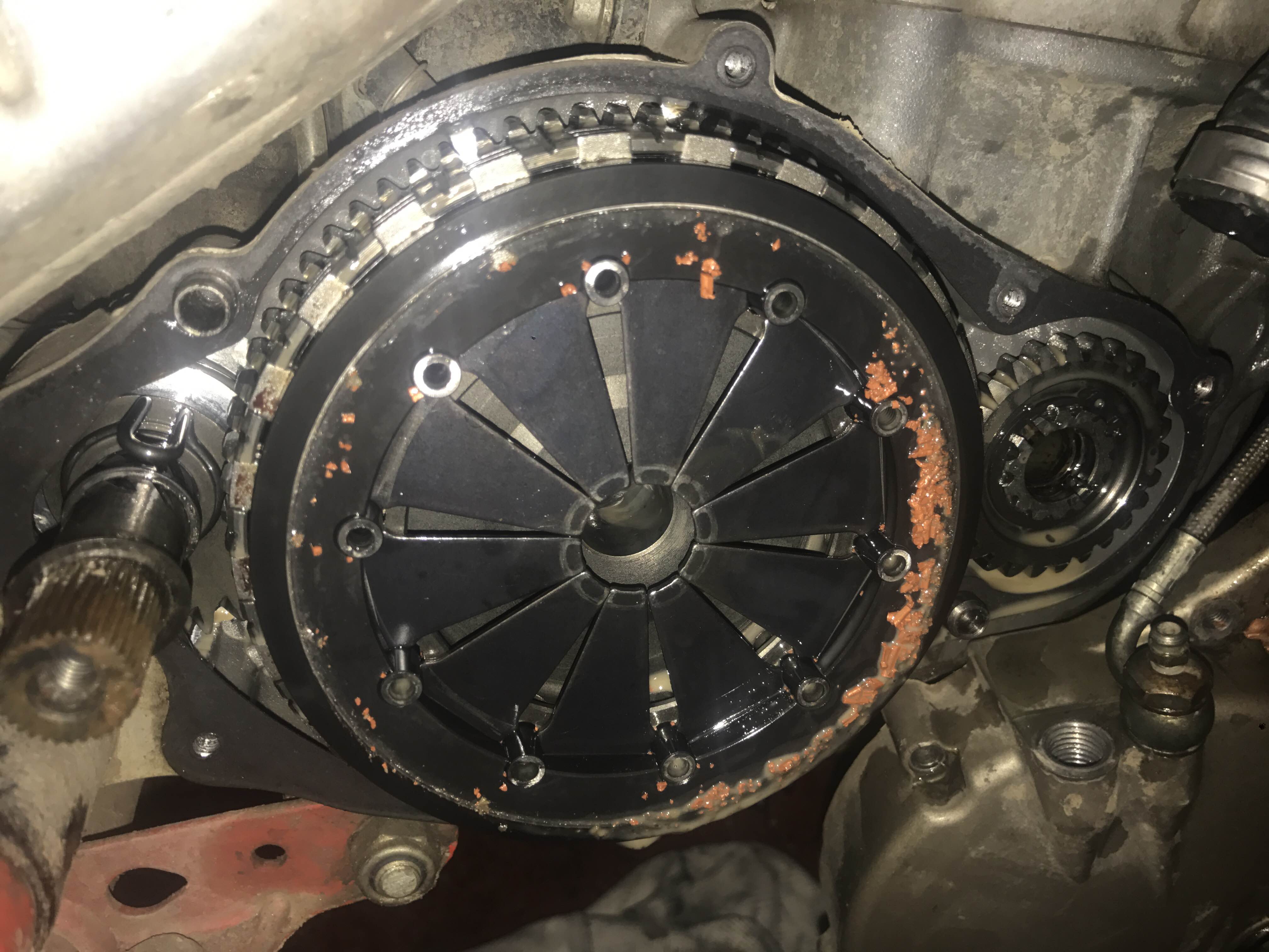

walshy_7 Posted May 28, 2017 Report Share Posted May 28, 2017 Recently purchased a gasgas 300 and I'm made up with the bike but after a few outings I thought it best to do some maintenance It's had a very heavy clutch and this site has been brilliant for finding out how to resolve this issue Also the fork seals have give up so after a great day at hawks nest I decided to pull it apart to sort the heavy clutch when removing the sump plug it let out a lot of loverly emulsified creamy oil so a little research and I'm going with water pump seals whilst removing the engine casing I seen that previous owner has smeared gasket glue all over the face of the water pump housing when I started to remove the couch plates I found loads of gasket glue jammed in every where also in the sump very rough job had been done on the bike so looks like I've got to do abit more than just changing oil I'll try and upload some pictures now All comments and thought welcome Regards chris Quote Link to comment Share on other sites More sharing options...

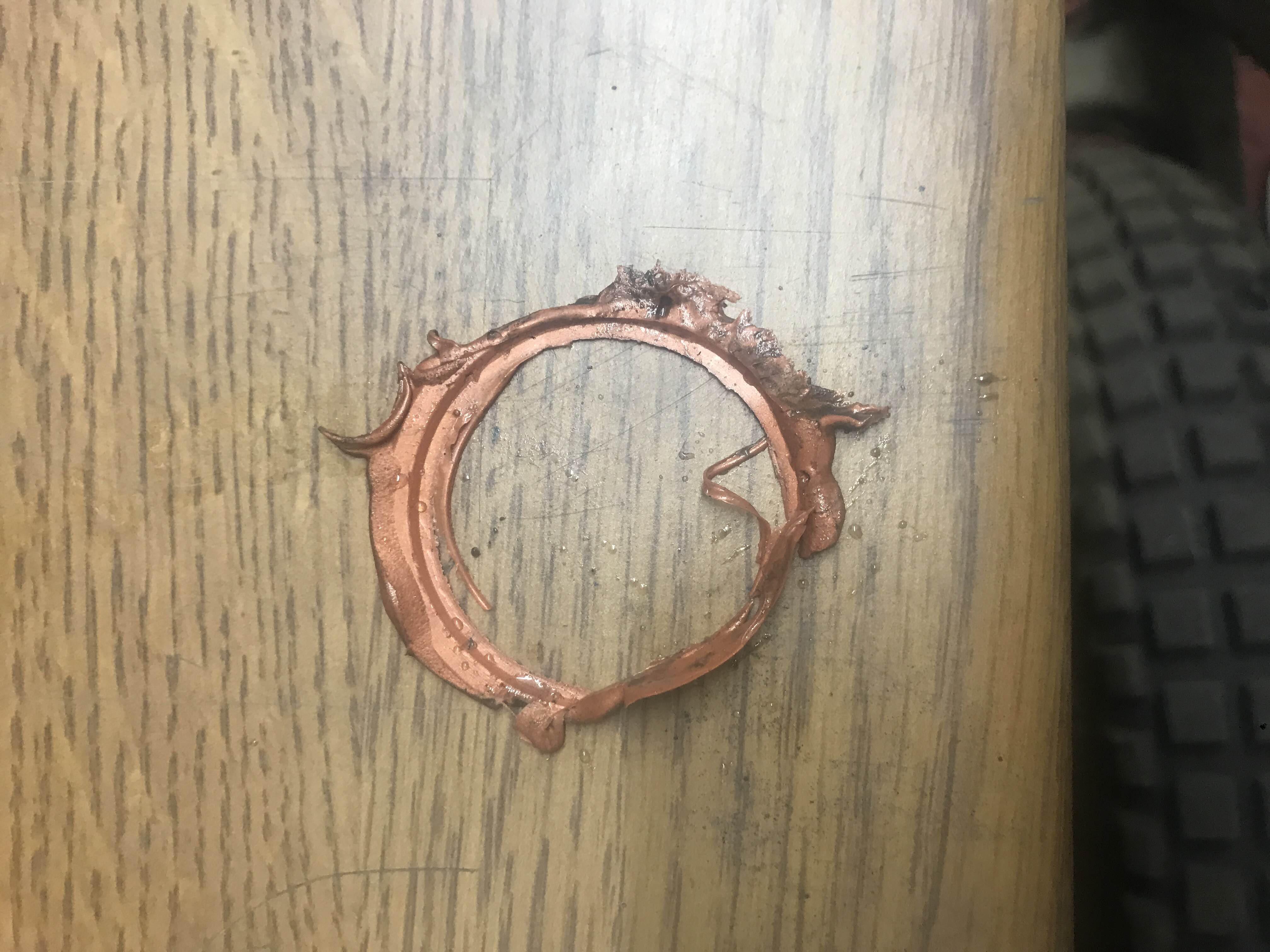

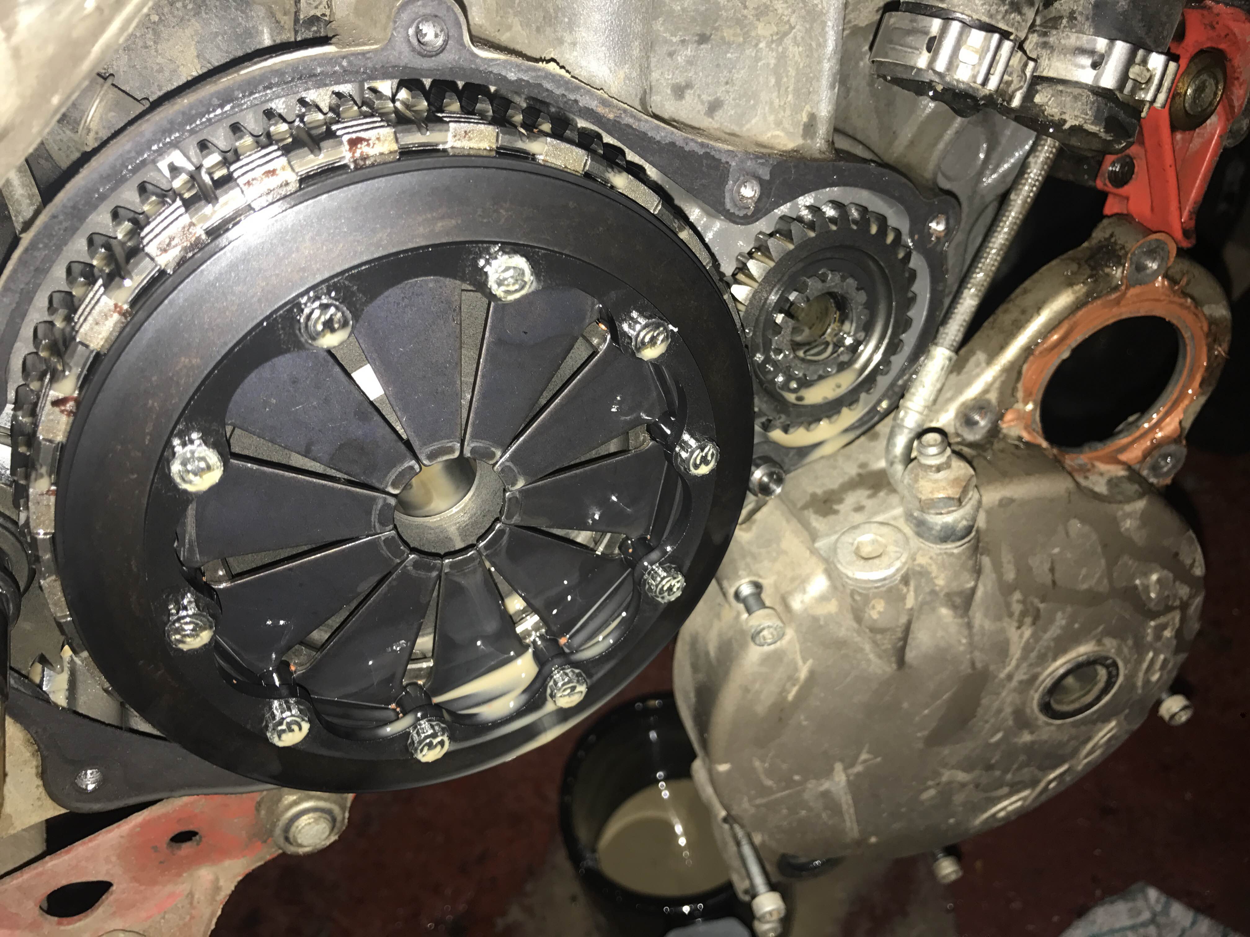

walshy_7 Posted June 13, 2017 Author Report Share Posted June 13, 2017 Thanks for the comments guys and well bikes brilliant again now I've took the cheap option of fixing it and I've done about 10 hours riding now fault free see how long it lasts. I've sanded down the clutch plates and put fresh oil in also fresh oil on the forks and replaced the seals and with the water pump the shaft was worn so looked into replacing the shaft and seal but I settled with using my original seal and shaft and fitted smaller springs on the seal and upto now all is great 1 Quote Link to comment Share on other sites More sharing options...
thats_a_five Posted June 14, 2017 Report Share Posted June 14, 2017 Keep your eye on the transmission fluid. It will get milky when the coolant leaks past that worn shaft. And it will. Replacement shaft and seal are available as a set at a reasonable cost. Remember that the oil lubricatesall the gears, bearings and clutch parts. Water and coolant are poor lubricants. Quote Link to comment Share on other sites More sharing options...
walshy_7 Posted June 14, 2017 Author Report Share Posted June 14, 2017 Yes matey I will be keeping a close eye on it and to be honest mate I'm not expecting it to last long really it was just a temporary quick fix as I had oil there and wanted to be out riding that day Quote Link to comment Share on other sites More sharing options...
paulmac Posted June 16, 2017 Report Share Posted June 16, 2017 Don't forget that on the Pro engine the gearbox oil also lubricates the crank bearing - water in there isn't a great idea. Quote Link to comment Share on other sites More sharing options...
