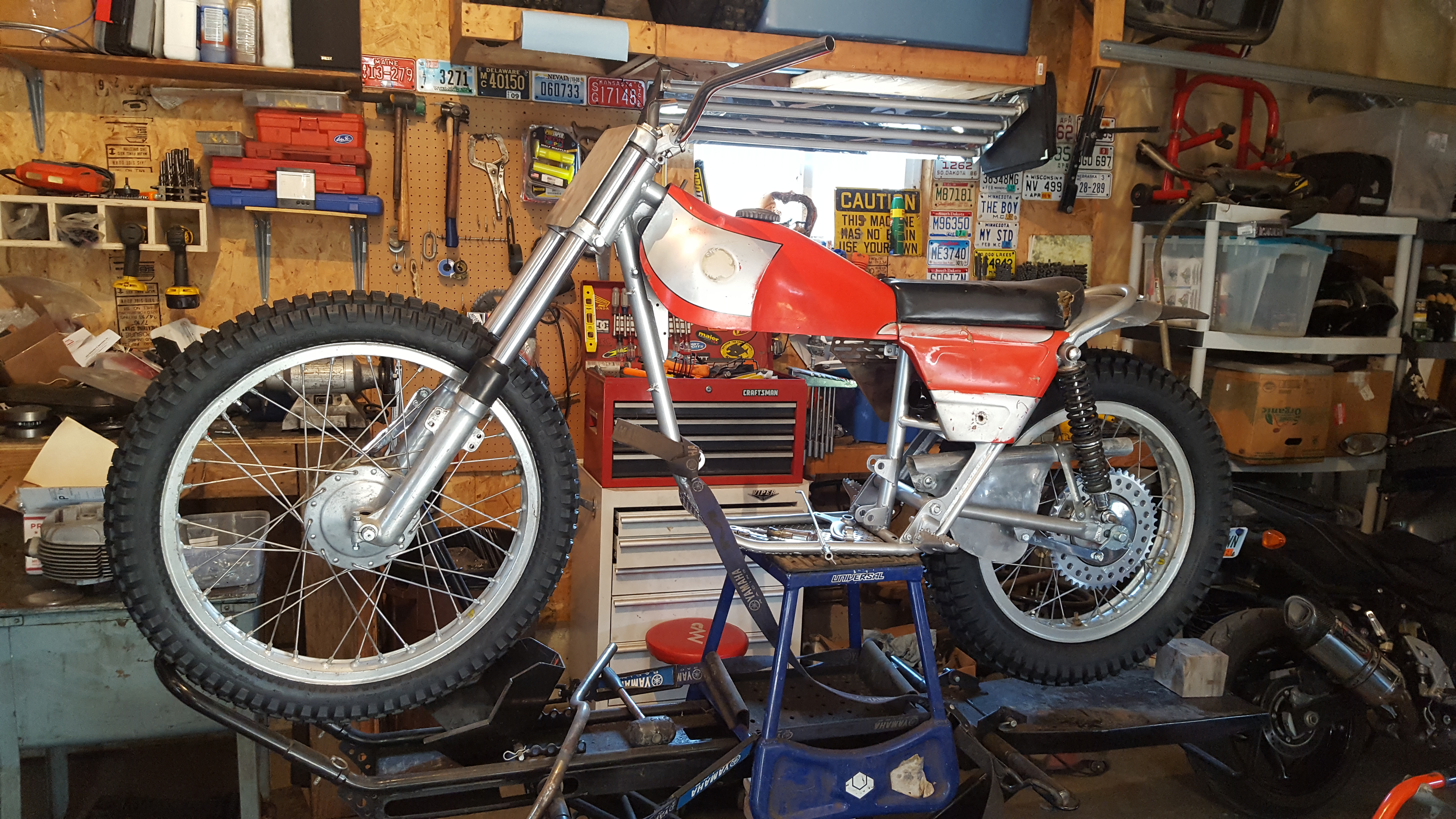

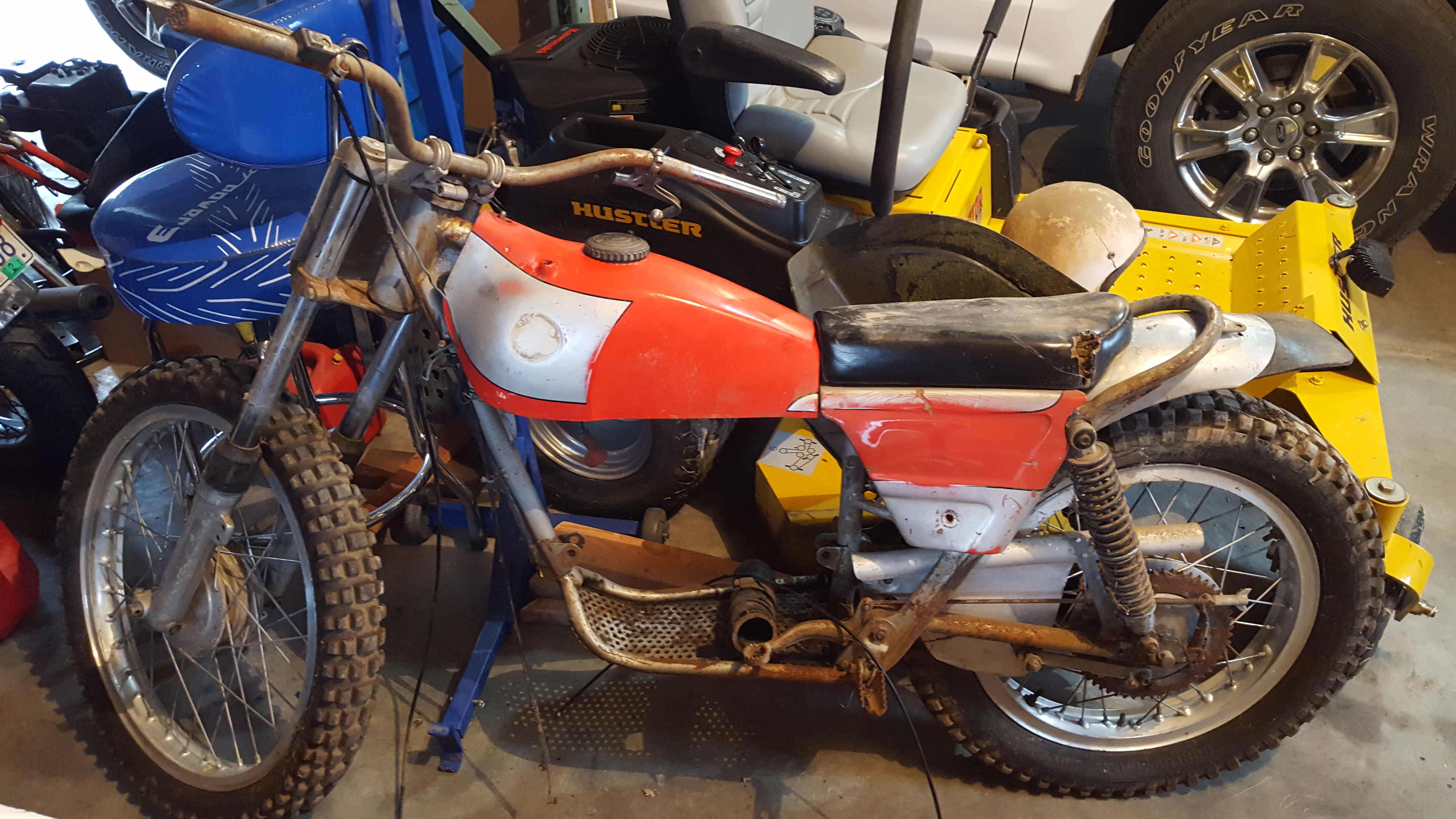

Thanks for the input. I have a manual on the way and am going to try and pull the counter weight off again and make sure the key is seated flat.  I'll try the pliers trick on the clutch springs as soon as I know the counter weight is on all the way.  It is a later #49, M4904488.  Here is a couple of pics of my project, before and after so to speak and one of the old boy that I bought it from ice racing it in the unstudded class back in the day.
