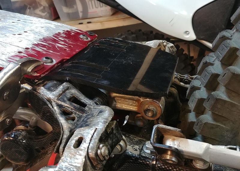

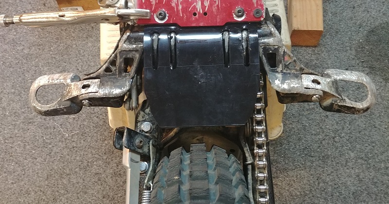

drca Posted July 14, 2017 Author Report Share Posted July 14, 2017 On 7/14/2017 at 1:01 AM, code54 said: Normally bike/atv's/etc... use something called UMHW plastic. https://www.amazon.com/dp/B0070ZASVO/ref=biss_dp_t_asn If it a very tough and slippery plastic that makes a skid plate that will not break, but will slid over an obstruction. If you can find someone that pulled the factory skid plates off a RZR Side by Side for a aftermarket replacement it is this type of plastic and about 1/8 inch and people around here give them away. On UTV's we switch to 1/4 or thicker due to the weight of the machine (1000+ pounds) and the high speed impacts they need to endure. A Rotozip works great for cutting them or even a bandsaw for the outer shape. You can use a heat gun to form it if you need a bit of a bend. Expand I ended up using a Kydex sheet which is pretty tough and thermoformable and available online or locally in the US at any TapPlastic (altho these guys think it's ABS!). I use 1/4" (6mm). The sheet I got came out of the remnant bin and cost $1 but was on the narrow side so I didn't get all the coverage I wanted (width wise). Here is what it looks like: I ended using the same material in 1/8" for doing frame rail protectors: These are held with thin strips of Scotch Extreme Mounting Tape (that stuff is so good that it might peel off the powder coating when I try to pry them off!). Quote Link to comment Share on other sites More sharing options...

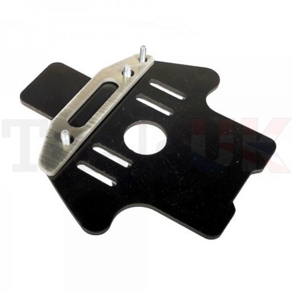

Ryder40BC Posted January 4, 2019 Report Share Posted January 4, 2019 I haven't seen one in person and like to fabricate a slightly larger UHMW version. Could someone that has mounted the Jitsie Linkage Suspension protector tell me where the aluminum spacer is sandwiched and if required or could be improved on. I'm running an "18 TXT 300. Thanks in advance! Quote Link to comment Share on other sites More sharing options...
