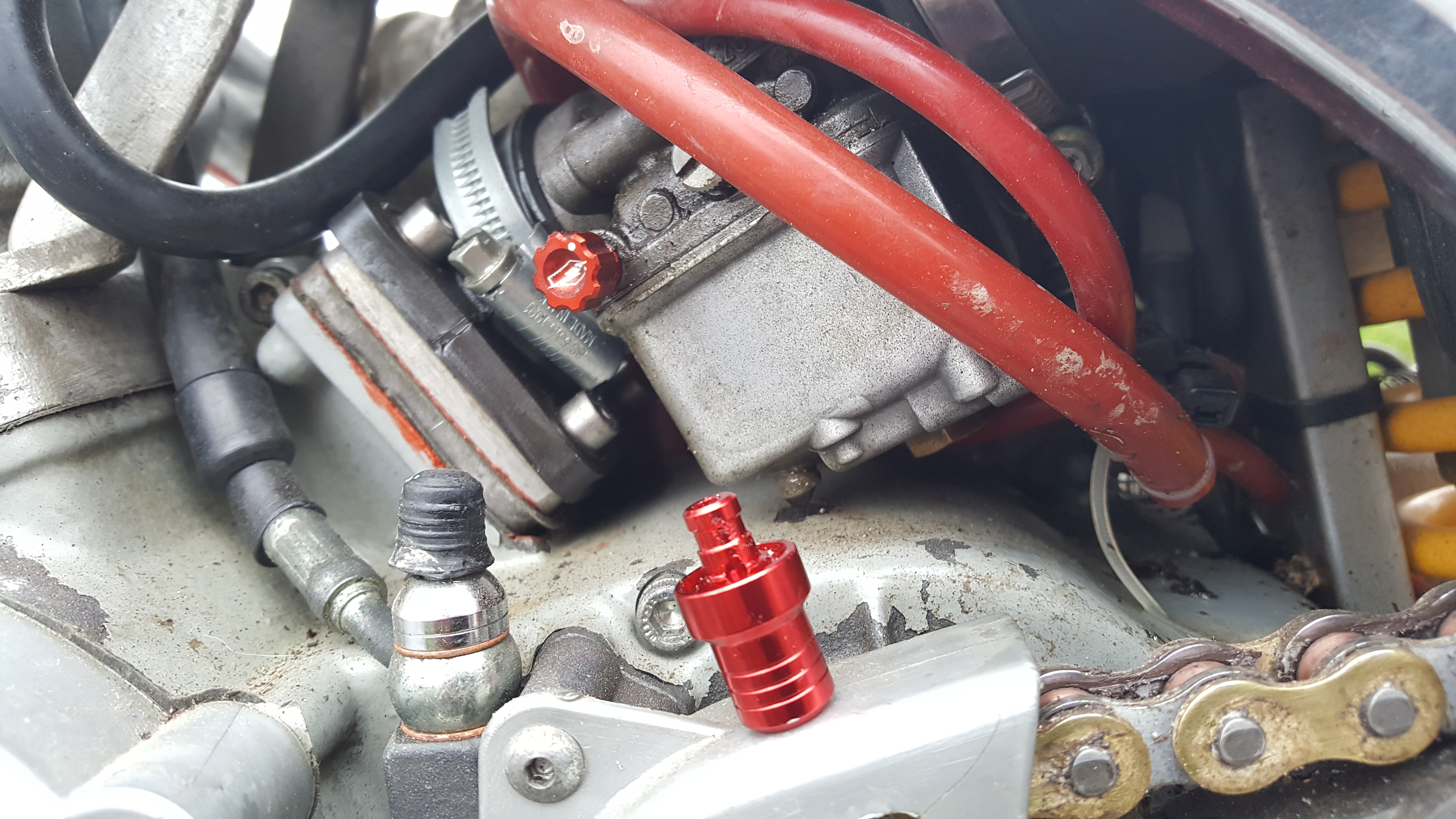

gasgaswobbler Posted June 28, 2017 Report Share Posted June 28, 2017 Hi all, I have an old 2001 txt which seems to be pumping oil out of the crank breather pipe! Thats what I have pictured, right, the thicker tube ? In the end of the thicker red tube was this plug So, tech guys. What is the likely reason it would be pumping oil out and how would one fix it ? Thank you for your time. carl Quote Link to comment Share on other sites More sharing options...

gasgaswobbler Posted June 28, 2017 Author Report Share Posted June 28, 2017 14 minutes ago, faussy said: If you are referring to the clutch centre bolt then no, your bike has a different clutch to a pro I was hoping it was as simple as re routing the breather hose to a higher position . If I need to dig into the engine what should I be looking for if its not the centre bolt ? Quote Link to comment Share on other sites More sharing options...
dadof2 Posted June 28, 2017 Report Share Posted June 28, 2017 Possible reasons for oil pumping out are Wrong grade of oil - unsuitable oil can foam and expand Too much oil - check level Water in oil - this will be accompanied by discoloured oil - usually turns grey / milky / cloudy Leak into gearbox from crankcase - porous casting or faulty gasket. Quote Link to comment Share on other sites More sharing options...
lineaway Posted June 29, 2017 Report Share Posted June 29, 2017 Just drain the oil and if not discolored refill with 650cc. Quote Link to comment Share on other sites More sharing options...
sirdabalot Posted June 29, 2017 Report Share Posted June 29, 2017 6 hours ago, dadof2 said: Possible reasons for oil pumping out are Wrong grade of oil - unsuitable oil can foam and expand Too much oil - check level Water in oil - this will be accompanied by discoloured oil - usually turns grey / milky / cloudy Leak into gearbox from crankcase - porous casting or faulty gasket. Or a crank seal Quote Link to comment Share on other sites More sharing options...
