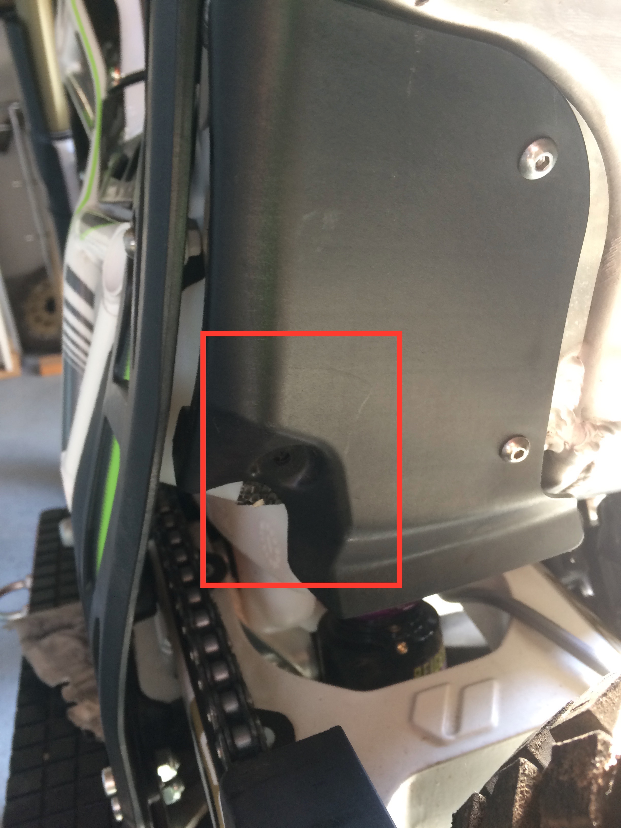

While cleaning the bike (Combat Ice Hell 250) a few weeks ago I noticed that the black plastic muffler cover was rubbing and damaging the fuel tank. When looking from the back of the bike: bottom left corner of the cover.
And to prevent a leaking fuel tank I removed some material from the cover and glued a small piece of rubber (from an old inner tube) to the tank . Just checked and no further damage to the tank, so that's good.
