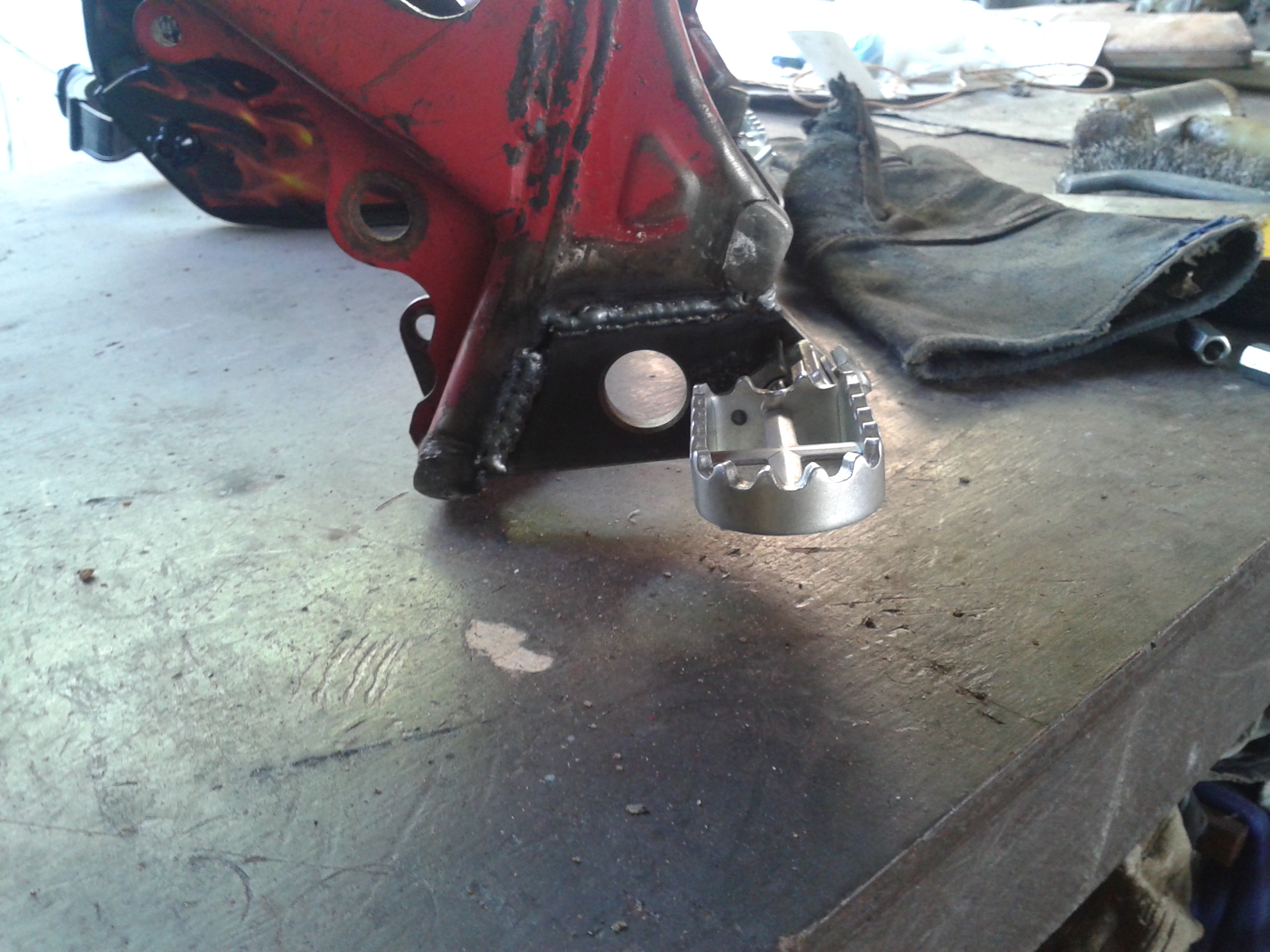

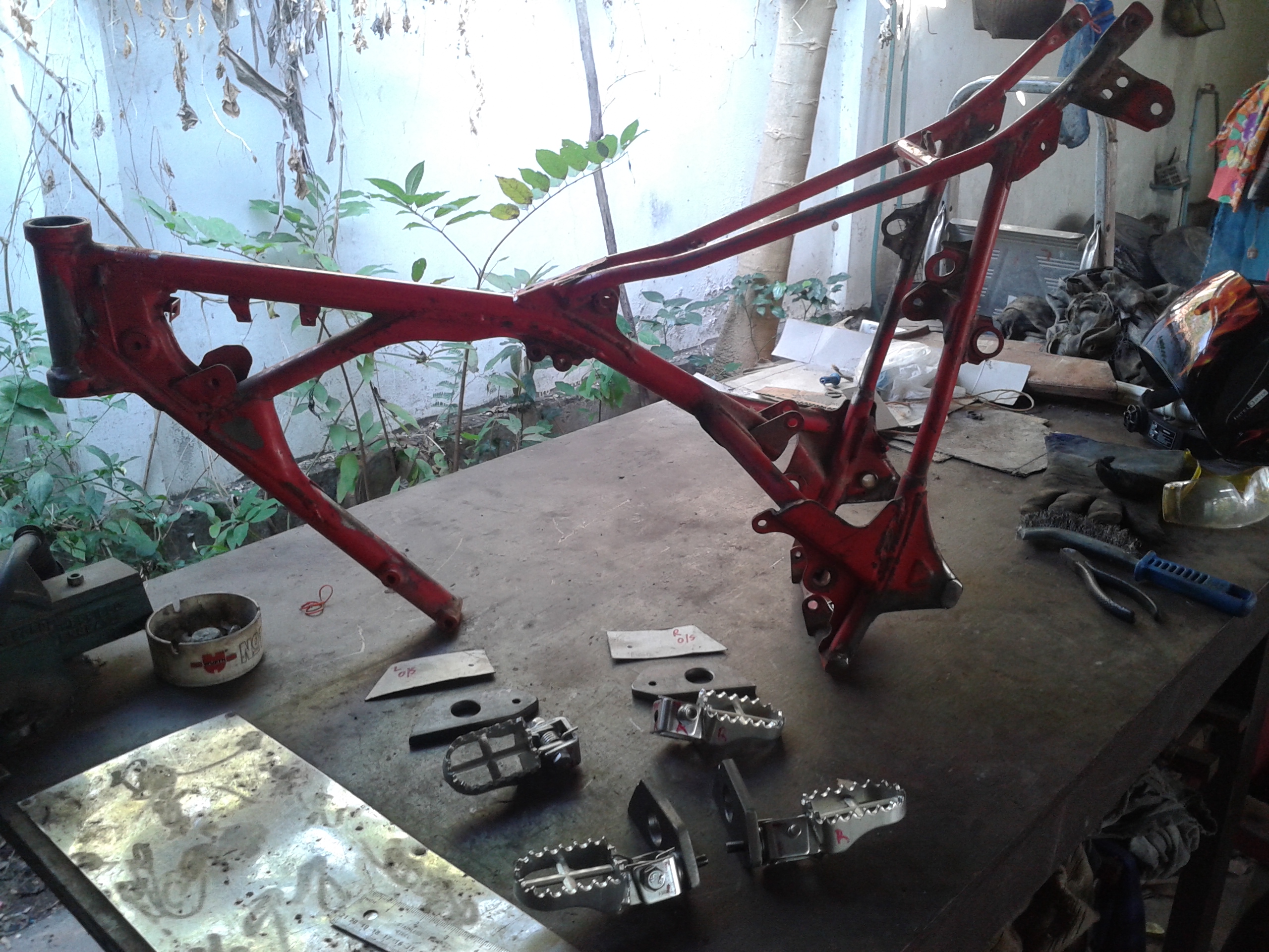

thai-ty Posted July 29, 2017 Author Report Share Posted July 29, 2017 So it was time to strip the bikes out. I'd decided to use 2 of the S frames and copy all the lack of brackets off the one R type frame i had. First job was cut the stock footrest mounts off and throw the narrow stock pegs in the bin. Metaphorically speaking.... Bought some 8mm thick plate, made my cardboard templates, shaped said plates, drilled and tapped, for my modified stock clevis and mig welded them pretty much straight down, maybe 1/4" back, not more. I reckon they are 1.5 - 1.75" down from stock, but still above the sump guard / bash plate. Clevis are held on by 8mm HT c'sunk screws thru the brkts, no welding. So far, held up well, and easily repairable. I'm a lanky bar steward at 6' 3", and before it felt like i was riding on the bike rather than in the bike, that little difference in height made such a difference to me, they are also twice as wide and much more comfortable. Quote Link to comment Share on other sites More sharing options...
thai-ty Posted July 29, 2017 Author Report Share Posted July 29, 2017 So i'd put weight back on with those 8mm thick footpeg brackets, now it was time to get out the hacksaw and 4" angle grinder with cutting discs and remove some weight. Below is everything chopped off two frames including two steering locks.... Two S frames are now identical to my one R frame (bar one small flat bracket that locates the front of the airbox). Quote Link to comment Share on other sites More sharing options...
