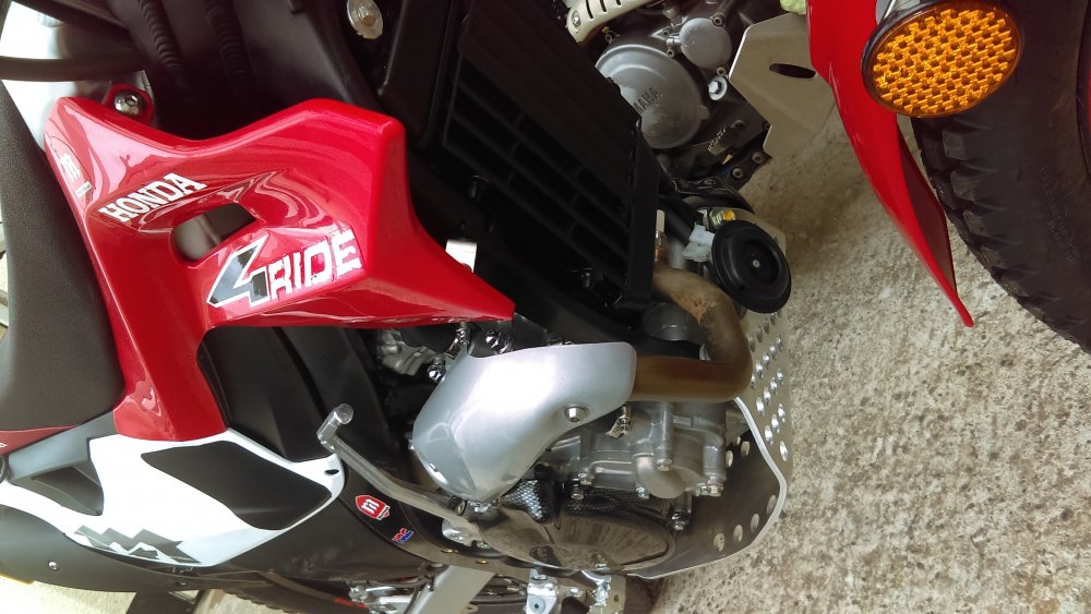

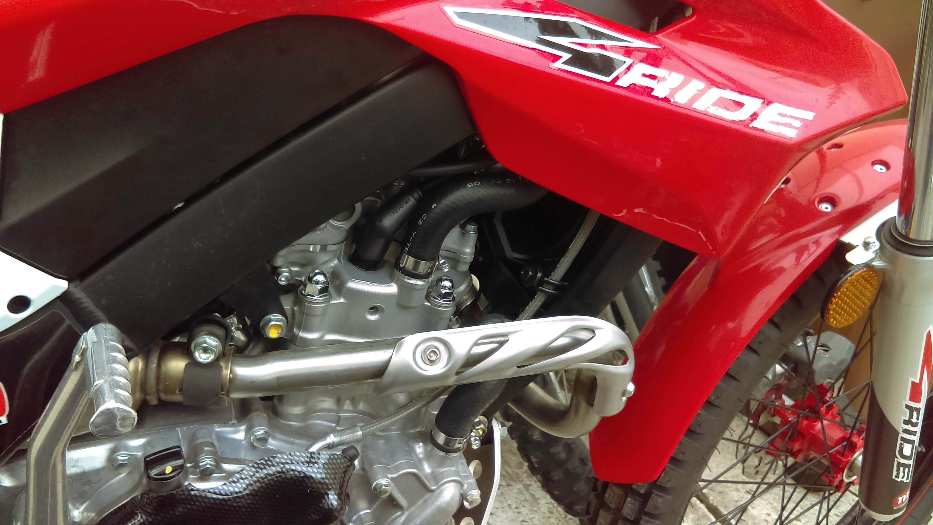

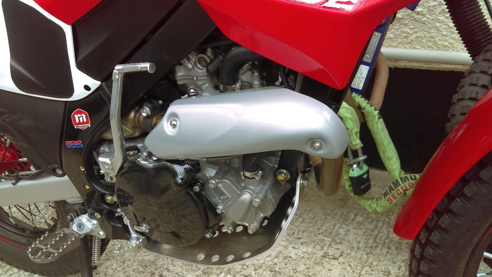

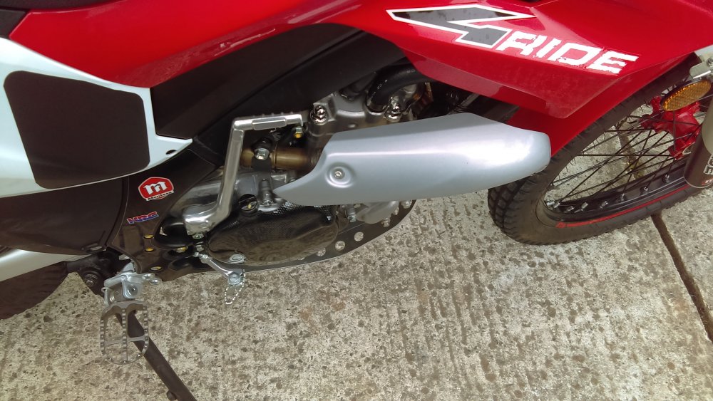

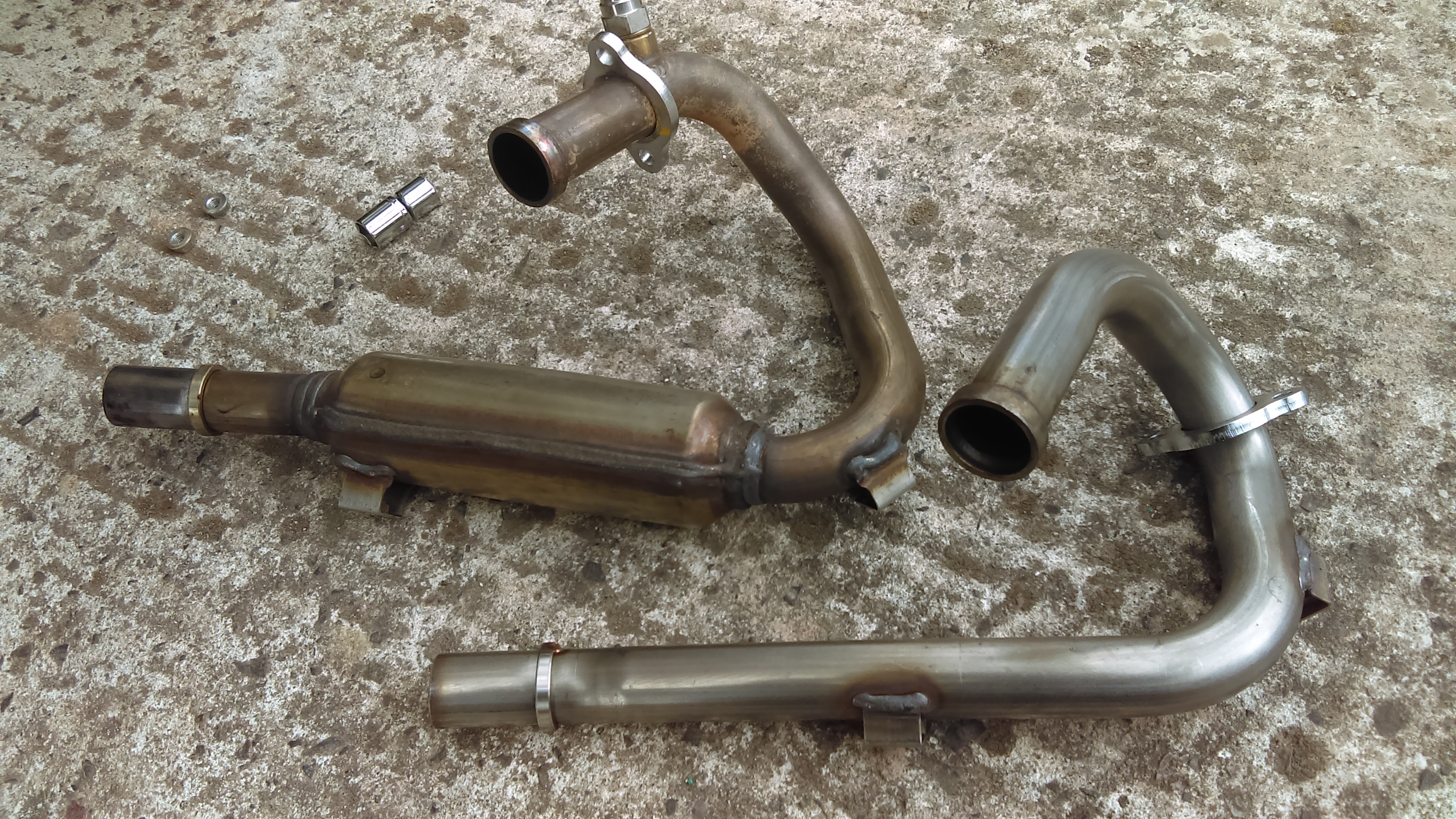

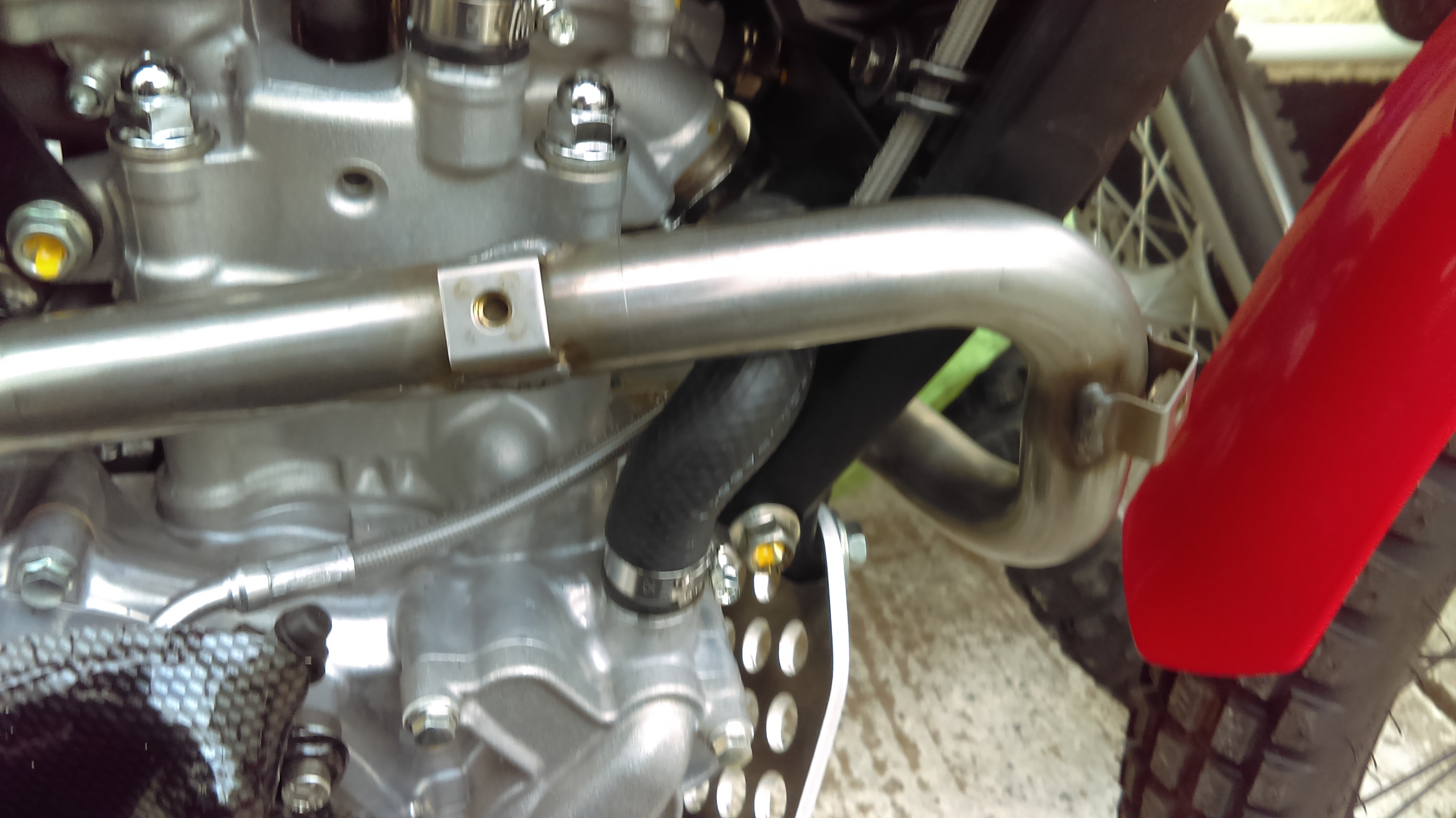

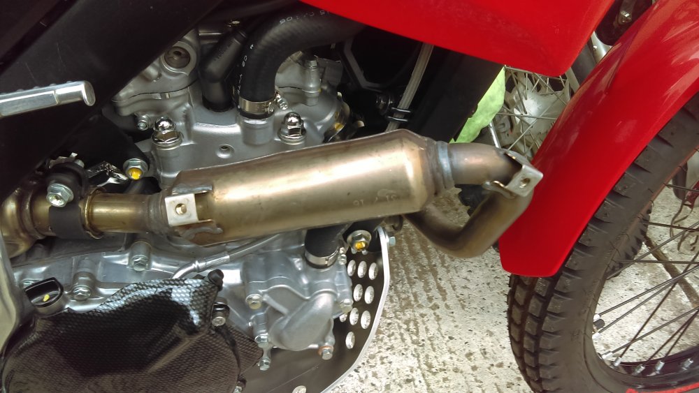

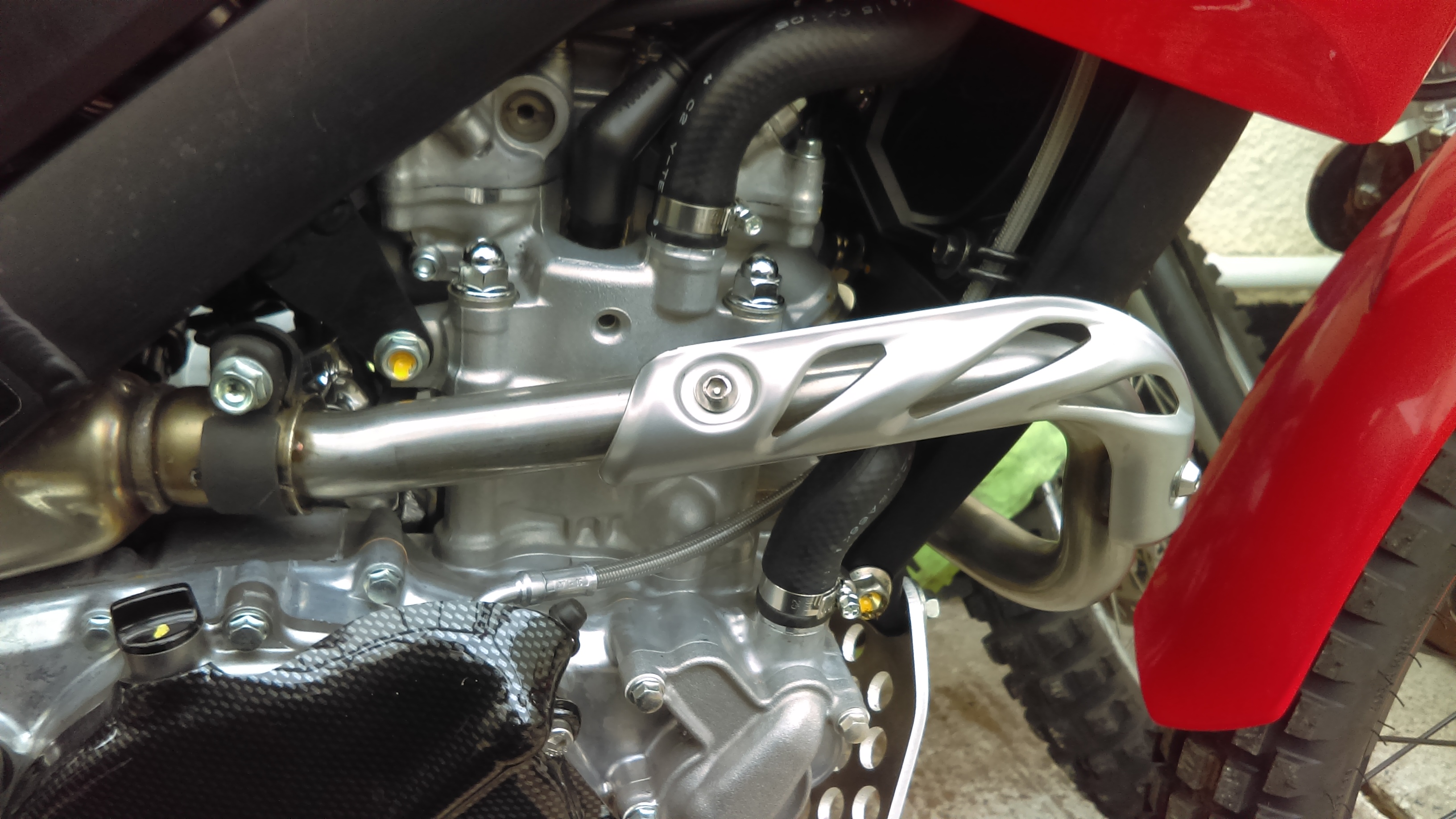

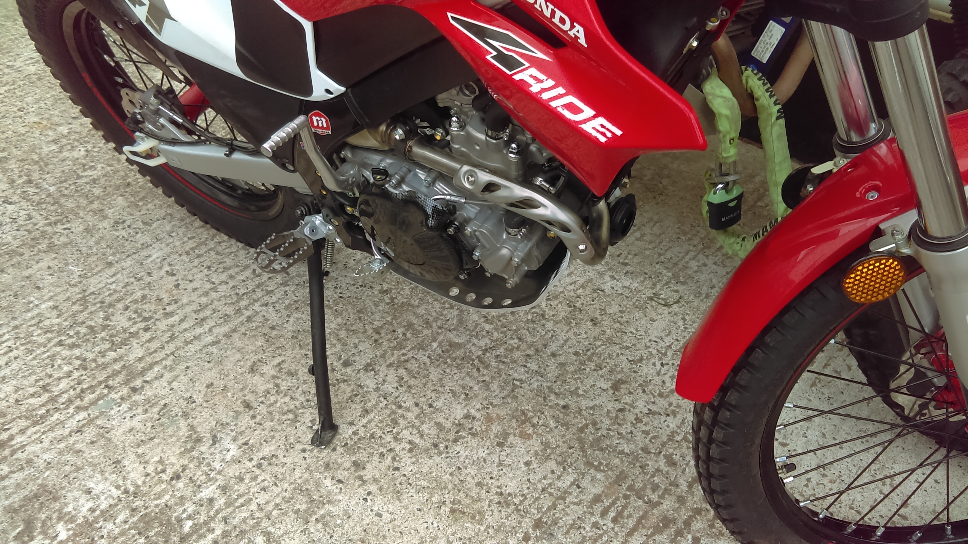

pug Posted August 23, 2017 Report Share Posted August 23, 2017 Montesa 4Ride Cat I'm thinking I don't need that bit Ebay found parts sorted a better look with some standard 4RT Bit's took ten and a coffee to fit looks far better with the s/steel RT cover an Exhaust Motor ran right up quick spin round the block runs fine no flat spots an sounds a bit crisper without the Cat Pug 1 Quote Link to comment Share on other sites More sharing options...

pug Posted August 23, 2017 Author Report Share Posted August 23, 2017 Front pipe and guard cover was sourced on the bay of evil pipe came in at £90 with the post and cover £18 it was just there when I was looking the only one on there. I did see a 30mm bigger bore one in a certain Trials shop don't think you can say names on hear can you but starts with H for a little more but did not know if it would fit for sure into the 4Ride end can and not wanting to p*** around with the gasket. plus not even being sure if the exhaust can is the same as the 4RT so I went for the standard one and it looks like the can is the same as 4RT as it fitted right in. Pug Quote Link to comment Share on other sites More sharing options...
dadof2 Posted August 23, 2017 Report Share Posted August 23, 2017 Is that thing actually a Cat or just a silencer? Quote Link to comment Share on other sites More sharing options...
sportsawyer Posted August 24, 2017 Report Share Posted August 24, 2017 1 hour ago, dadof2 said: Is that thing actually a Cat or just a silencer? It's a catalytic converter. In the 5th photo you can also see an oxygen sensor in the headpipe. The street legal 4RT260 and 300RR bikes also have them, and run closed loop. The 3ED & 4ED models are open loop. Quote Link to comment Share on other sites More sharing options...
muzzman Posted August 25, 2017 Report Share Posted August 25, 2017 Thanks for the info guys. Pug is that an O2 sensor on the original pipe, did you have to disconnect it back to the ECU? I've ordered the de-cated front pipe and heat shield from a dealer in Dewsebury called Craigs (where I bought the 4 Ride) and got them both for £95.00. Should be here Monday for fitting ready for the next LDT's. The Sphinx and then the Moor To Sea. Quote Link to comment Share on other sites More sharing options...
dadof2 Posted August 25, 2017 Report Share Posted August 25, 2017 I had seen the 02 sensor in your photo. It is the position of the CAT that is a bit odd. That far from the exhaust valve it will struggle to get up to working temperature, especially on a single cylinder engine on typical trials use. Probably a bit of a gesture to the green lobby rather than a necessity, unless its for type approval, in which case you may have to refit it for future MOTs. Same problem will apply to the 02 sensor unless it has a heater which i can't tell from the photo. Quote Link to comment Share on other sites More sharing options...
sportsawyer Posted August 27, 2017 Report Share Posted August 27, 2017 On 8/23/2017 at 5:59 AM, pug said: ... Motor ran right up quick spin round the block runs fine no flat spots an sounds a bit crisper without the Cat There's a "Full Power Kit" for the 4RT260 & 300RR street legal versions, and along with the change in headpipe & removal of catalytic converter / O2 sensor, a wire is changed to use a non-O2 sensor / full power ECU map. Look through the "Full Power Kit" instructions for the 2016 4RT260 at this link: http://www.montesa4rt.nl/php/download.php?INFO=../data/2016_cota-4rt260-full_power-uk.pdf Also, note the intake restrictor. The 4Ride parts manual shows this is on the bike. You may need to remove that, as well as check for a restricted air filter cap (and change if restricted) to have all the conditions right for the full power map. On 8/25/2017 at 4:13 PM, dadof2 said: ... Probably a bit of a gesture to the green lobby rather than a necessity, unless its for type approval, in which case you may have to refit it for future MOTs. ... I don't know what your inspections are like, I'm in the US. So that could be a problem depending on how you want to register it. I'm hoping Montesa will start making a 4Ride 3ED model to import into the US. Remove all the lighting except headlight and taillight "enduro" lighting, maybe keep the odometer / speedometer console (or a reduced version with less functionality because it's not needed). Add a spark arrestor to the exhaust. Get rid of the catalytic converter, intake restriction, O2 sensor, kickstand switch, turn signals, horn, and so on. Sell it as an off-road bike and there will be a lot fewer regulatory hoops to jump through and throw money at. Better yet, also change the airbox assembly to use a bigger filter and hinged side-door access along with an aluminum subframe (more like other off-road bikes). Quote Link to comment Share on other sites More sharing options...
