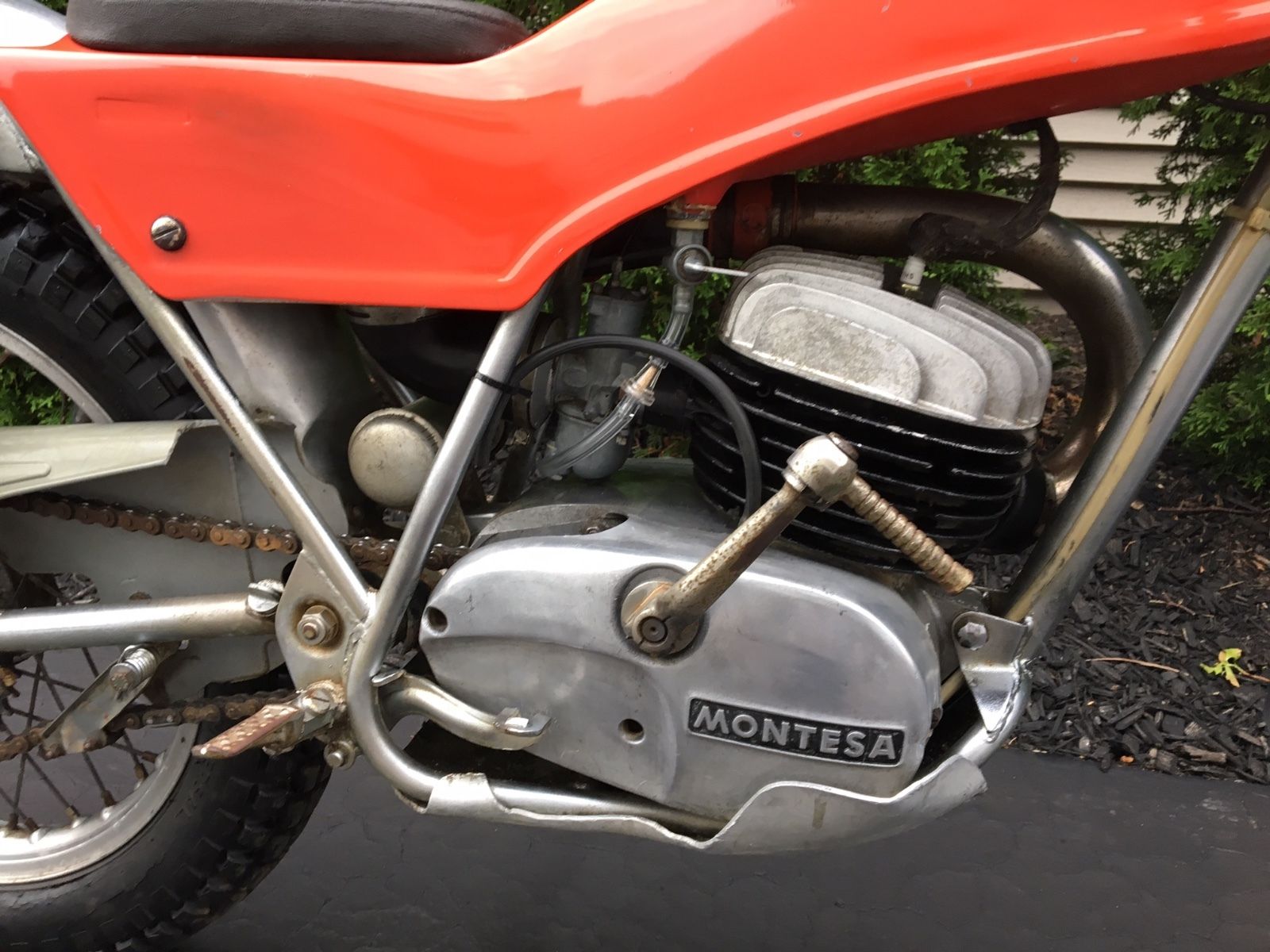

gtowndualsport Posted September 8, 2017 Author Report Share Posted September 8, 2017 cleanorbust, Thanks for the info. I have already ordered a Clymer's manual. I try to only use non-ethanol gas. I have attached a picture or the right side of the bike. Do you guys use regular unleaded or super to mix? We have 87, 89, and 91 octane here. I think that 87 octane is equivalent to European 91MON. The gas station with non-ethanol gas only has 91 octane. I should be good using that. Quote Link to comment Share on other sites More sharing options...
cleanorbust Posted September 8, 2017 Report Share Posted September 8, 2017 (edited) Yes, your 90w for the gearbox should be OK (300cc). I use ATF in the clutch case (200cc). Ethanol-free fuel is the ideal answer but it's rare and expensive here in the UK. 91 octane should be fine. I use regular unleaded, 50:1. I think I run my kick start lever one spline back (anticlockwise) from where yours is. Looks like the standard chain tensioner, so the 520 chain shouldn't be a problem. The original footrests are a bit pathetic, being too small and smooth. I got a pair of modern style Raceline footrests from Motomerlin in England, which fit the U- shaped bracket on the frame with a little grinding of the rests so they sit at the correct angle. Most modern footrests are unsuitable because of course they fit the single bracket design of modern bikes. Looks as though your bike doesn't have the second plug hole to the right hand side of the head, which is handy for fitting a decompressor, a useful addition for some sections and a foolproof way of stopping an over-revving motor. Cylinder heads with the second threaded hole are regularly available on eBay. Enjoy the bike! Edited September 8, 2017 by cleanorbust Quote Link to comment Share on other sites More sharing options...
jc2 Posted September 10, 2017 Report Share Posted September 10, 2017 Very good advice about the position of the kickstarter. I can't remember now whether it's the 1 o'clock or 2 o'clock position for the kickstarter they say not to exceed. From memory its at the bottom of the stroke where the stop tab punctures the case if you have it too far forward. Nice bike by they way. Quote Link to comment Share on other sites More sharing options...
