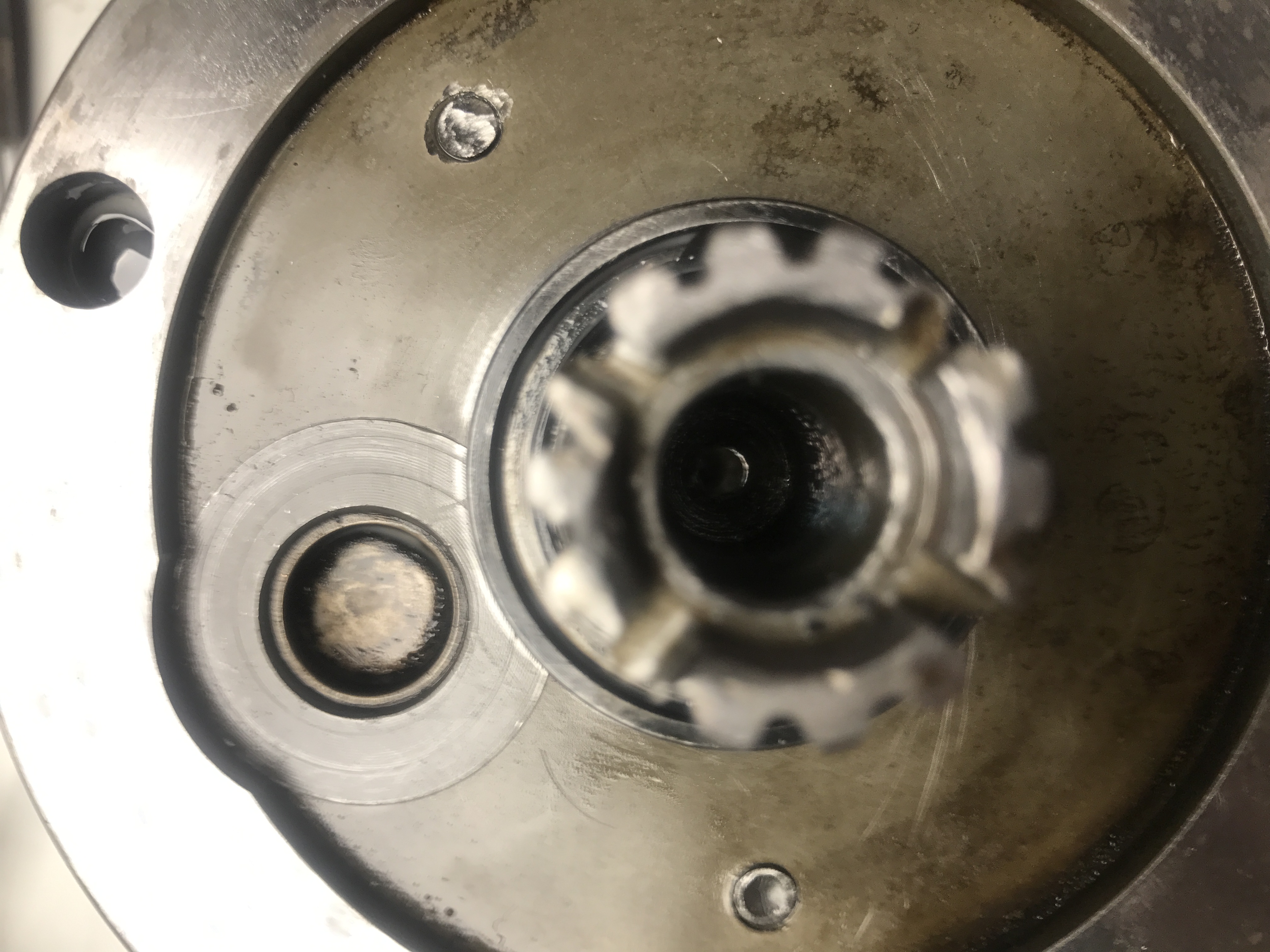

the funny thing that i noticed is when i was spinning the crankshaft and get some compression from the piston in the cylinder i could see some oil being spit out through the crankshaft axel end - where the water pump connects.
Can somebody tell me if my logic is correct, there shouldn't be free passage between the combustion chamber(crankshaft) and the gear oil where the clutch is.

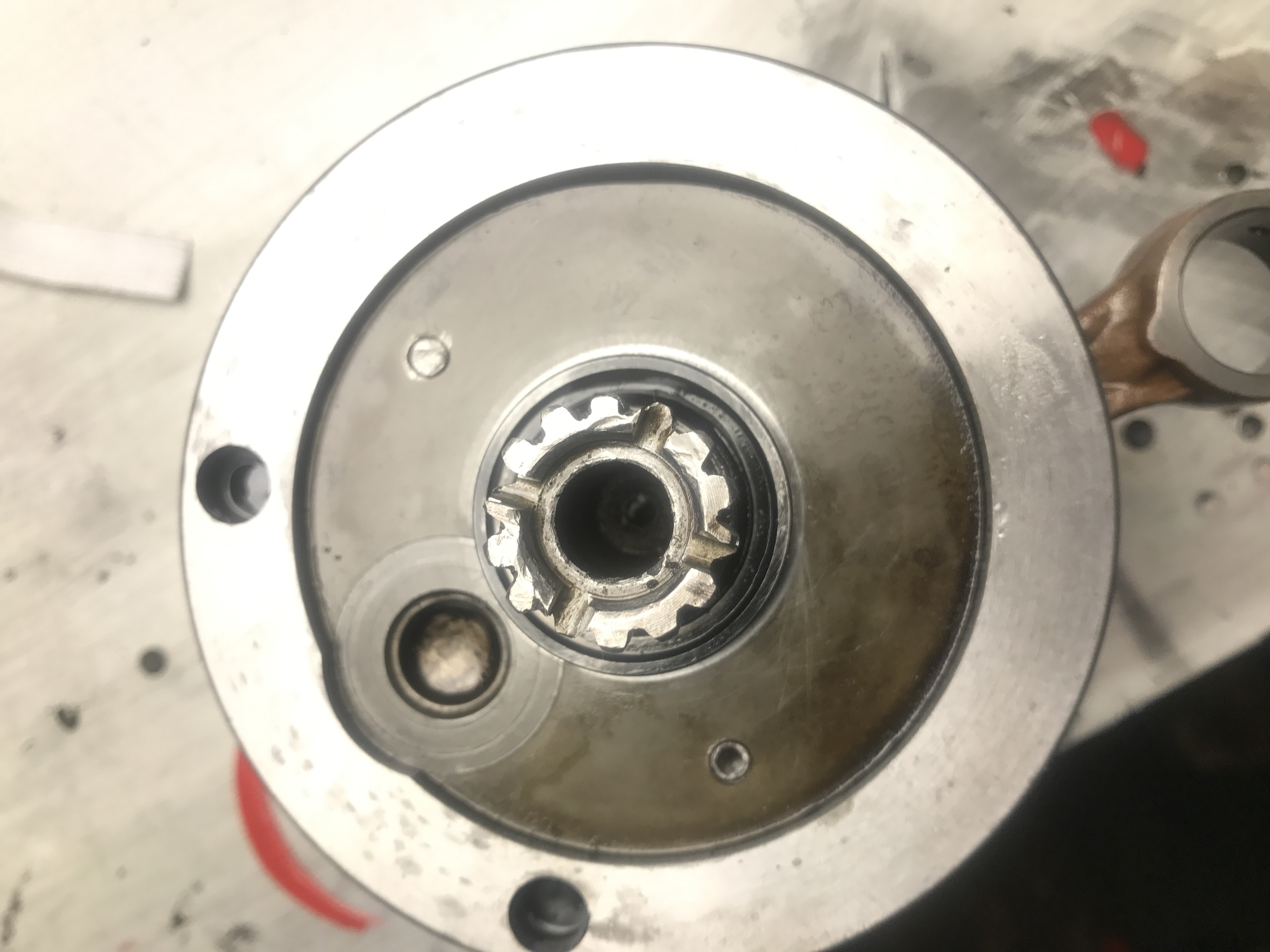

2nd picture i shone some light where the rod is to get an idea about the thickness of the material.

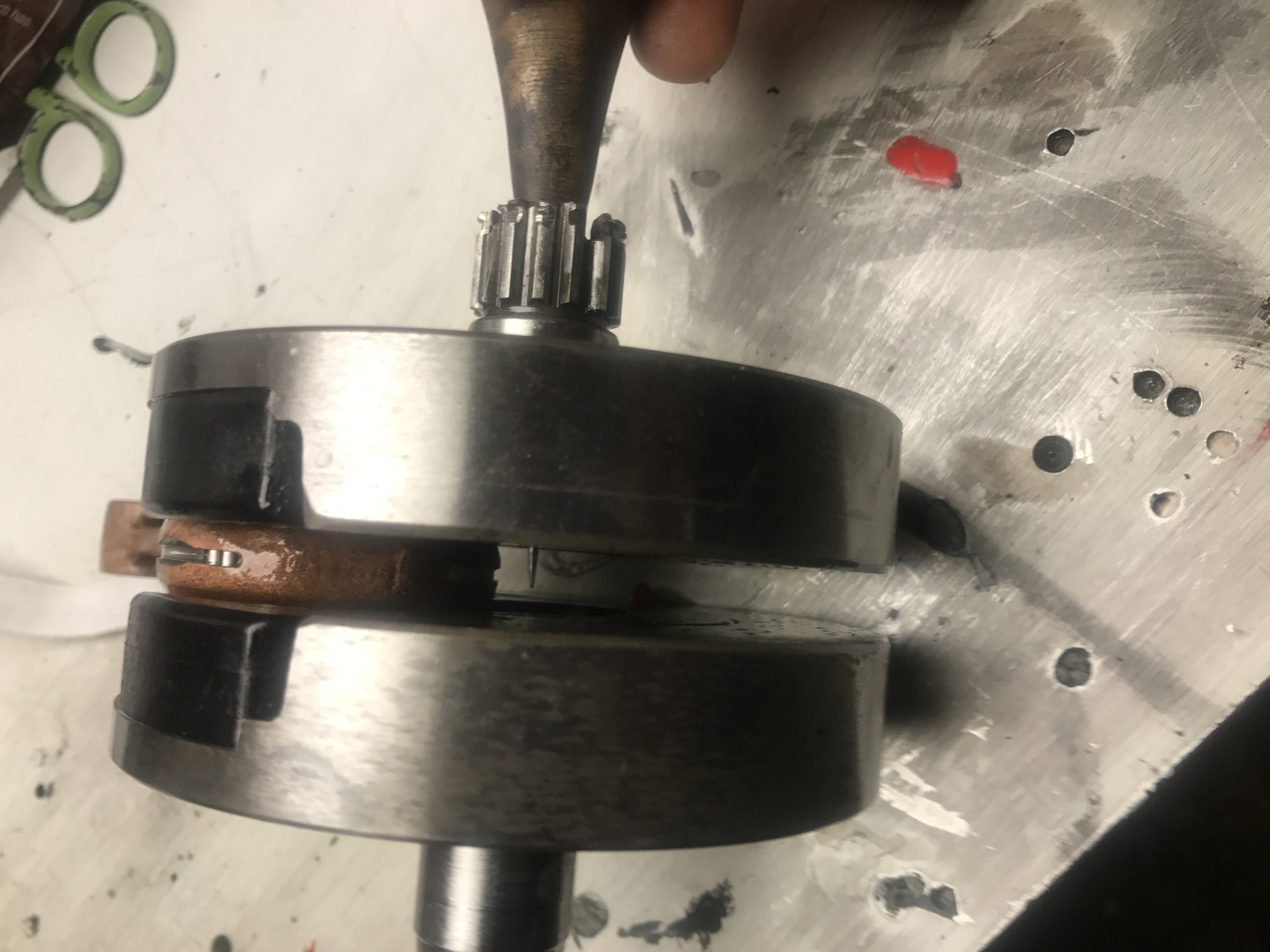

3rd picture - the crack shaft wear and tear is extreme,, makes me believe someone used the hammer or something to get things into place. And similar lack of skill -by using some kind of inadequate extractor- could have penetrated the bottom of the shaft creating this mysterious hole.

as one can see from the picture its a pretty round hole about 3-4mm ø..
The bike might have lost the coolant and also the pump wasn't doing 100% of its task but find it hard to believe the 90-100 degree celsius would have created the hole in the shaft, considering i had 100 psi in compression prior to this happing, something has developed i think there was some prior damage, which left a very weak skin of metal or i wonder if there was a plug from the manufacturer or re-codintioning guys( if ever), i just wanna see other people's opinion about what could be, as it puzzles me baddly.
