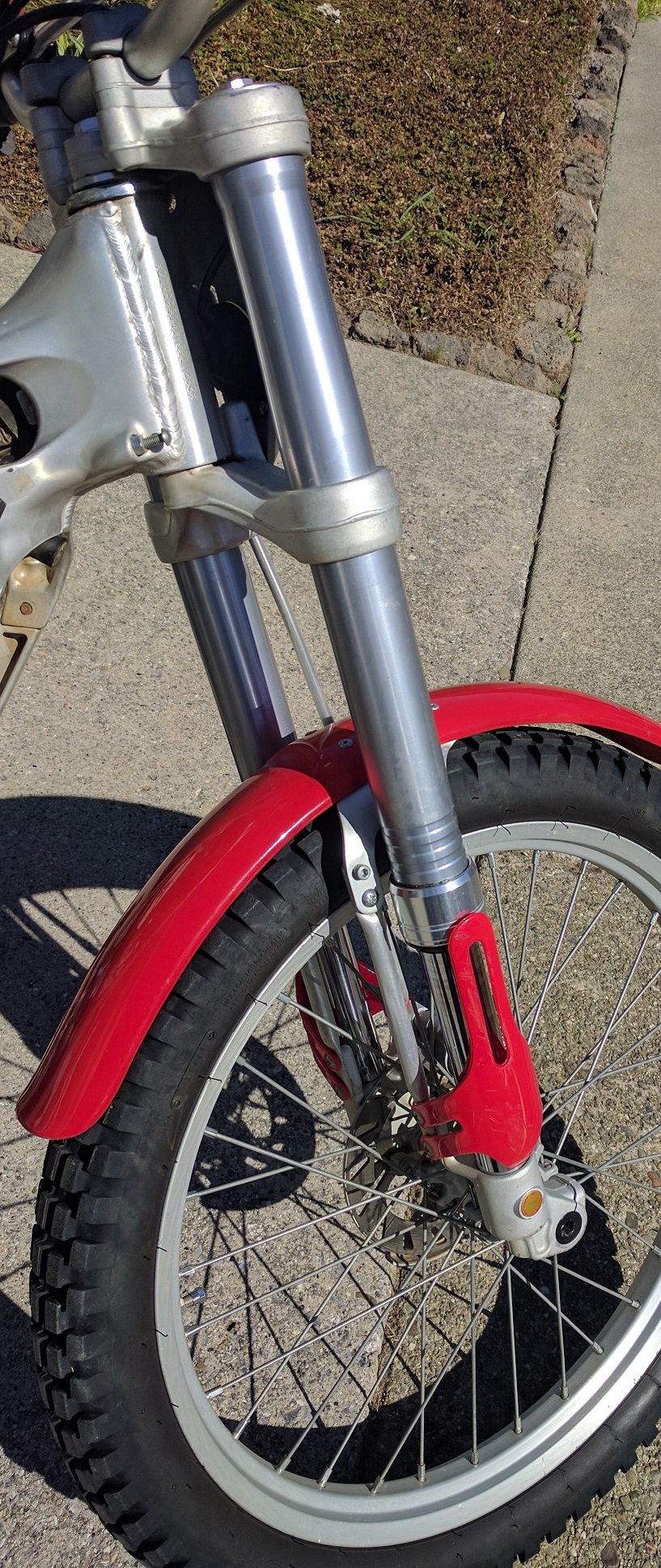

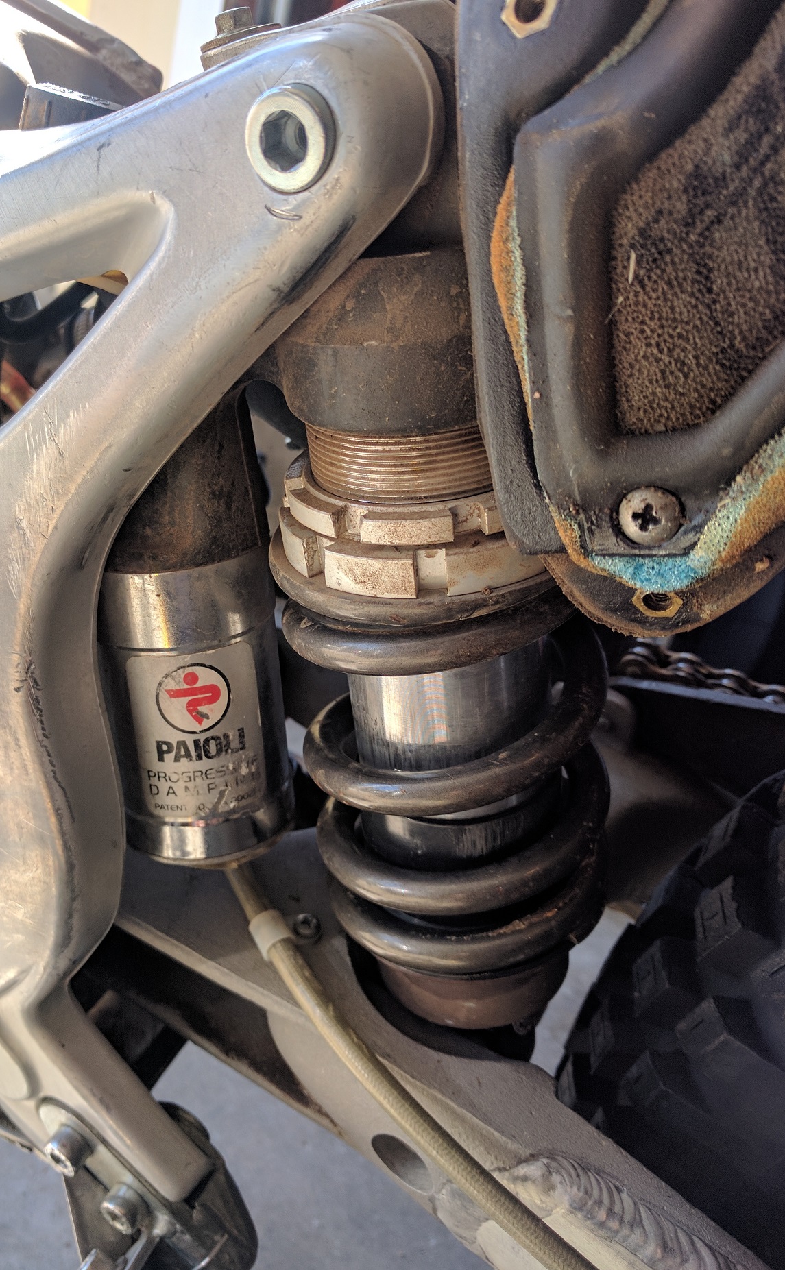

Hello!
Been thinking about servicing front forks and rear shock of 2000 rev3 2T 250, and previous owner had the bike sitting around for probably 4-5 years. I have attached the pictures. The suspension seem to be working ok, but I would like to service and replace needed items to ensure its reliability. Do you have recommendation on what to replace and what tools you suggest I buy? Considering lead times, I would rather have things ready before starting on this project.

@oni nou: Thanks for your inputs. Per your suggestion, I will change fork seals, and will start looking for a spare shock.
One additional question: if I buy a fork seal driver, will it work across other models of trials bikes, or newer beta models?
Link to comment
3 hours ago, oni nou said:
A piece of plastic tubing of the correct size[just a little smaller than the diameter of the seal] obtained from a plumbers merchants or hardware store will do the job.or a suitably sized socket wrench,I have never used a seal driver and have fitted a lot of seals successfully.
sounds like an excellent idea! Fork servicing is new to me so this info will definitely be useful.
