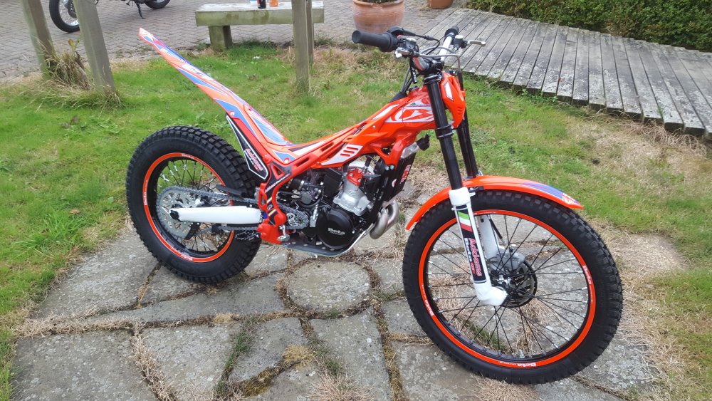

mightychub Posted October 11, 2017 Report Share Posted October 11, 2017 I just got one of the last 2017 300 factory bikes had a 2016 evo 250 for a few months took it back and got the factory. The factory bike is amazing worth the extra few £s much smoother but has the power when needed it also has the slow throttle just to keep it under control. It's a much lighter bike than the 250 and the forks and shock are much better, brakes also seem to be more powerful. The bike is a blast and will go up anything lots of grip too with good throttle control. Am 14.6 stone and the 300 was the right choice for me. 2 Quote Link to comment Share on other sites More sharing options...

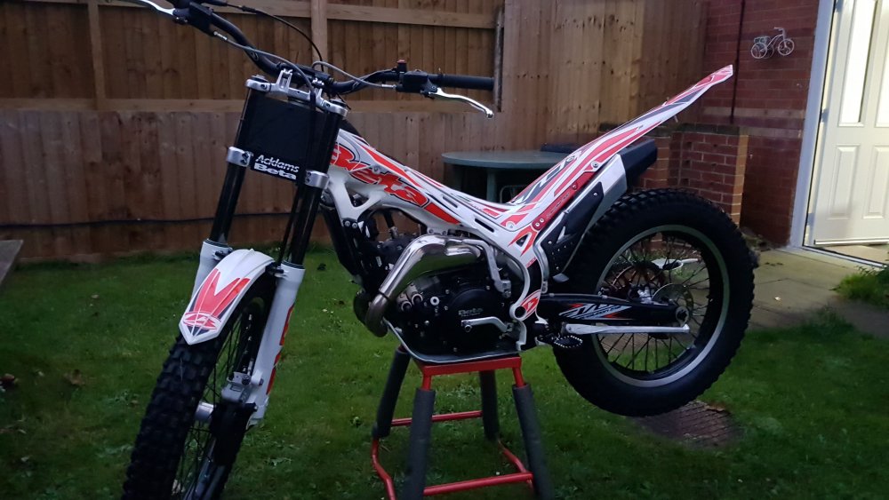

danbillam Posted October 18, 2017 Author Report Share Posted October 18, 2017 Fetched the bike today and all my kit. Very impressed she's lovely. One problem though I bought some s5 bar ends and they're slightly too big for the beta bars. Are thinner diameter ends available or do you usually modify them to fit? Quote Link to comment Share on other sites More sharing options...
danbillam Posted October 19, 2017 Author Report Share Posted October 19, 2017 2 hours ago, oni nou said: Does any one ride their new trials bike these days, that bike looks like its never been out of the garage[they cost so much no one wants to get them dirty or scratched] not a scuff mark anywhere....it seems like its an excellent way of losing £1500.......if any one out there wants get rid of £1500 easily I will take it off your hands ....Dan you have got a new bike at a secondhand price congratulations! You don't need bar ends anyway; so that's that sorted....by the time you've reached the third time you see the bike catapulting off a 6ft rock step and dropping into a jumble of rocks below you wont be bothered about stuff like that anyway.....enjoy yourself. Lol cheers mate it is indeed like new. One old chap and still on original grips like new etc. Bar ends are fitted and I've been reading about suspension set up today. Test riding yesterday it was very very soft just riding in the car park. I've wound the rear preload up 3 turns as per the manual but I have a feeling i may need a stronger spring. I had 105mm of sag in riding position and after the 3 turns it was at 90mm. Which I think is still too much. 1/3 of the travel is 60mm. Should I add a few more turns preload or get the stronger spring? There's still alot of thread left to go on the shock. I haven't altered the forks yet. Quote Link to comment Share on other sites More sharing options...

danbillam Posted October 19, 2017 Author Report Share Posted October 19, 2017 19 minutes ago, oni nou said: New spring costs around £80....the one you have will probably be approx. 70Nmm to suit rider weights of 80-90kg if you weigh around 85-95kg then you can get a 75Nmm spring or 80Nmm one if you are 95kg or over.......you can wind up the spring; it will not change the spring rate by doing so but it will change the compliance of the rear,as in the back end will be more skittish over the ground and so lead to less grip in very slippery conditions but is good for trick riding eg hopping around,also jacking up the back end steepens the steering making it more likely to tuck on tight turns but nothing that you would not get used to ;so do not be put off ......you need to experiment any way to find what suits you personally ......If it were my bike I would just wind it up abit and save the £80 quid and spend it on some spare parts .....take the bolts out of your rear mudguard and use cable ties to hold it on or when you loop it out/it goes flying off down a hillside after you bail then your mudguard will snap in half. Regards. cheers mate ill take it to the max preload 6 turns and just ride it for now. ive done the forks tonight with full preload I have an inch and a quarter of sag so should be fine. I'm going to go out for a ride tomorrow locally just having a plod and do some balancing etc. cant do much yet as my shoulder isn't back upto scratch. Quote Link to comment Share on other sites More sharing options...
lineaway Posted October 20, 2017 Report Share Posted October 20, 2017 Go for the spring. I rode my 16 250 factory for a month till I changed it. Made a world of difference. Foolish not to set the bike up correctly. 1 Quote Link to comment Share on other sites More sharing options...
