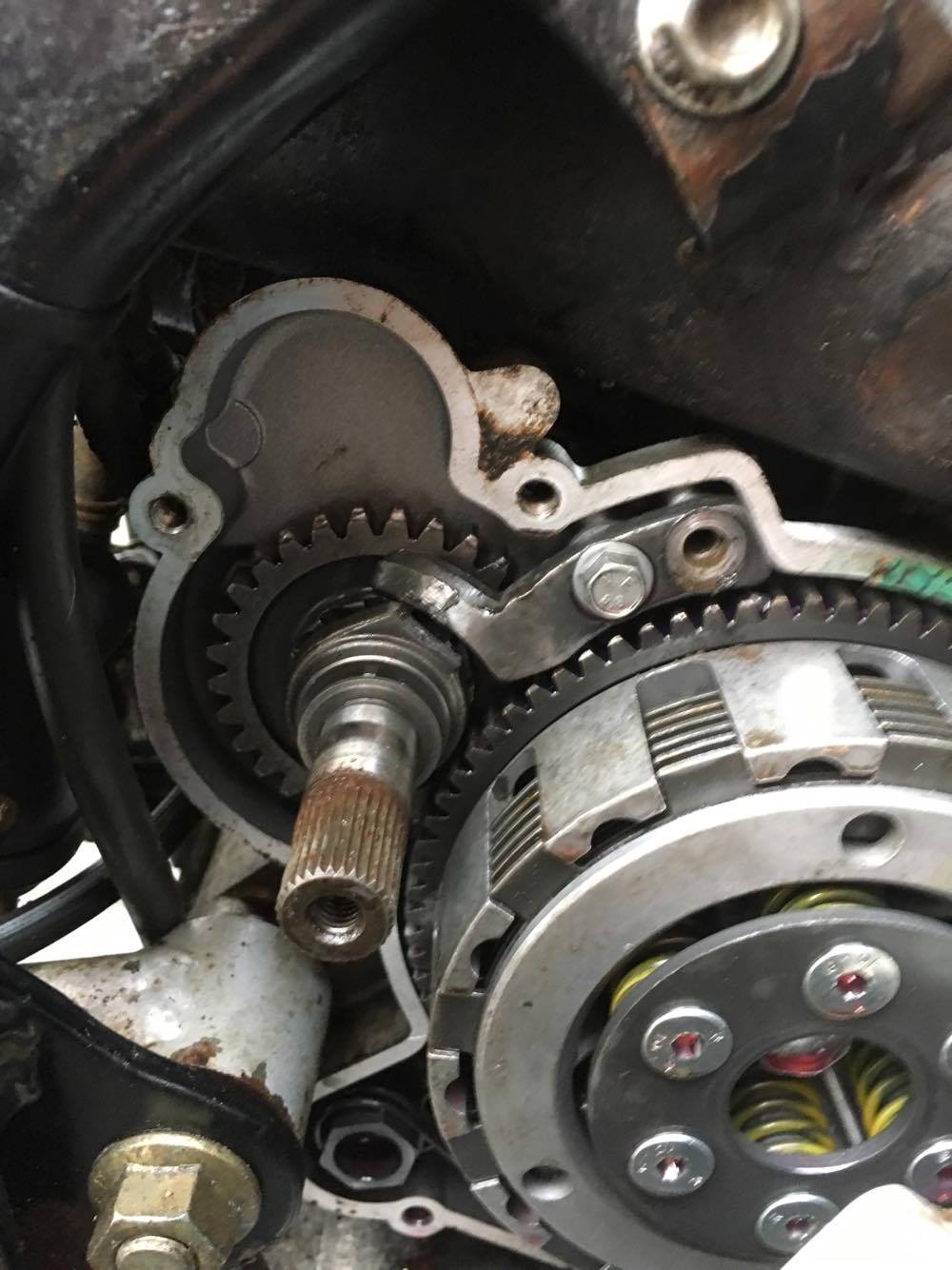

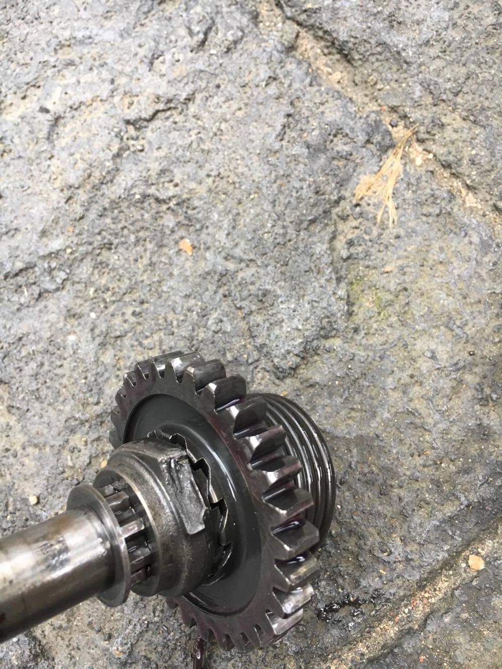

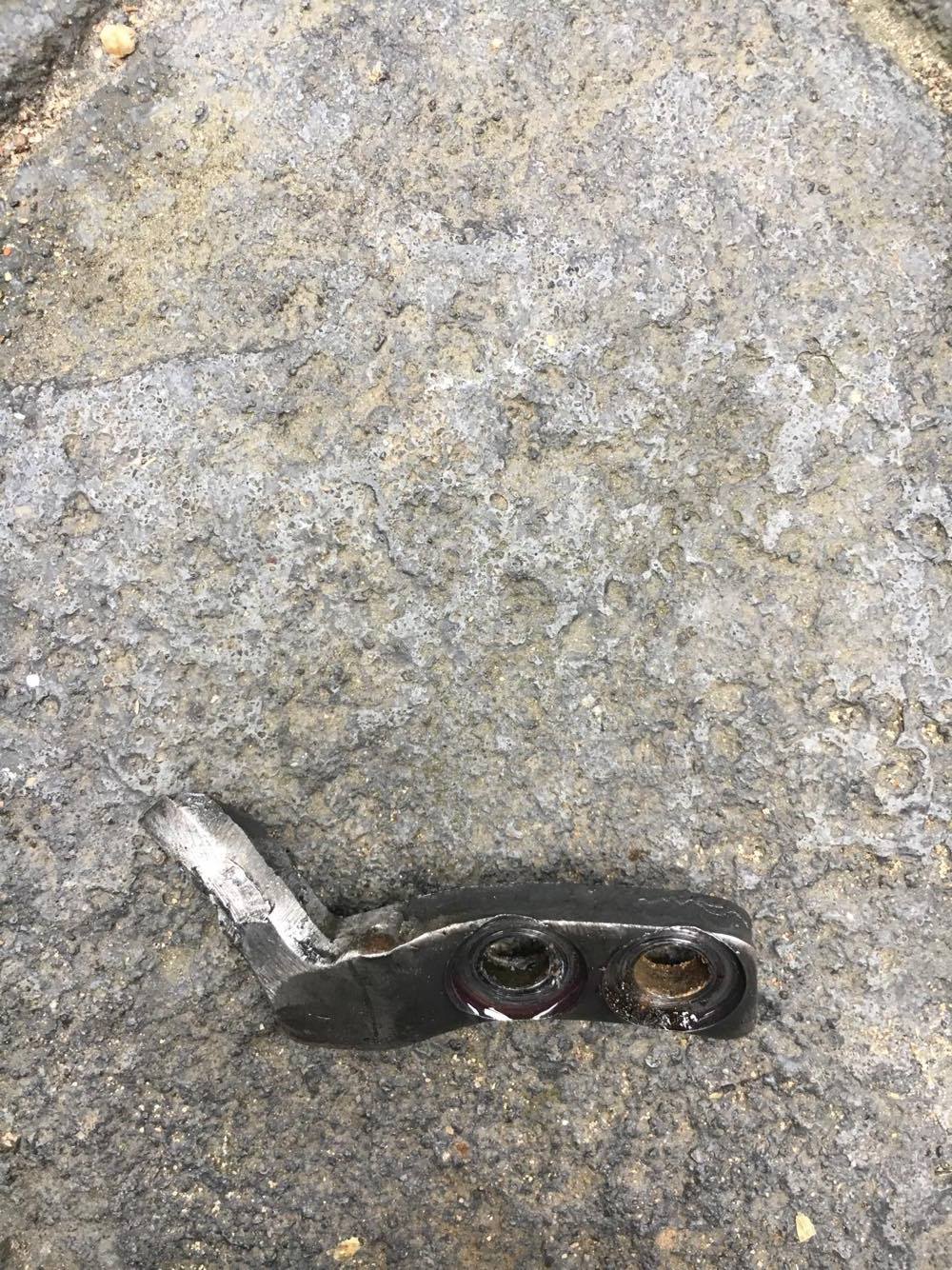

scotthewitt Posted October 15, 2017 Report Share Posted October 15, 2017 hello.. can anyone help we out here and tell me what these parts are called and where i can purchase them thanks scott Quote Link to comment Share on other sites More sharing options...
lineaway Posted October 15, 2017 Report Share Posted October 15, 2017 Kick start gear pawl and the stop. Need location to recommend where to buy. Quote Link to comment Share on other sites More sharing options...
scotthewitt Posted October 15, 2017 Author Report Share Posted October 15, 2017 im in the uk northeast and thanks Quote Link to comment Share on other sites More sharing options...
overdale Posted October 16, 2017 Report Share Posted October 16, 2017 Go to the Beta UK website, then downloads, look for the year of your Beta 80, and download the parts drawings. You should be able to identify the kickstart mechanism parts you need, then just phone Beta UK ( which is John LAmpkin imports) they are the source of bits in the U.K. IF you don't know the year, I don't think it matters as the 80 engine has been pretty standard over the years. Quote Link to comment Share on other sites More sharing options...
