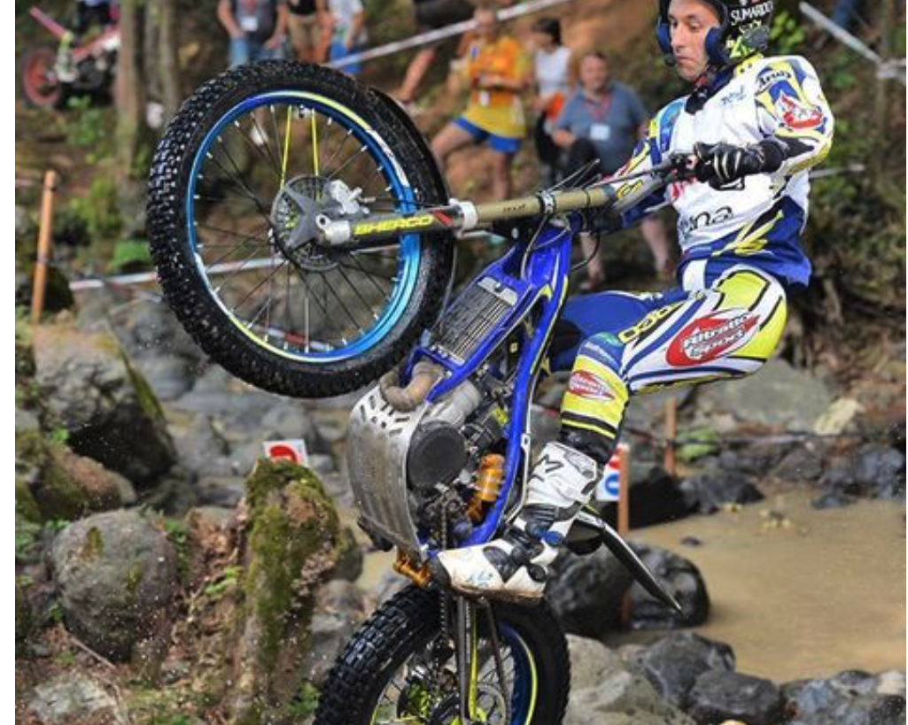

greski Posted October 15, 2017 Report Share Posted October 15, 2017 Hi There / New to the Forum I have been searching the web for details on Pro Trials rider setups to see what You can do to modify or improve Your Trials bike / After searching all I can seem to find is a little information of Cabestany's Preference for an Enduro Clutch on his Sherco Factory 300 ST. I have noticed theres a Golden Cylinder attached to the Chain Side of Cabestany's bike in pictures from various Competitions / Does anyone know what this is ??? I thought it might have been a special Ohlin's external Oil Shock ? Any ideas Guys n Girls ?? Also if anyone has anything to Add to this Topic or has any Pro setup questions themselves please add and hopefully the community will help us mere mortals out Delighted to be a member / Hope to hear from You soon Quote Link to comment Share on other sites More sharing options...

nigel dabster Posted October 16, 2017 Report Share Posted October 16, 2017 The cylinder on the side is a reservoir for the rear shock, an ohlins engineer said its imposible to work properly without this, us mere mortals excluded. The clutches (until changed to diaphragm) on both Shercos and betas (similar design) were not up to the techniques of the WTC so from dougies time at Beta onwards you will see the works bikes often have different casings and therefore internals. Be careful what you wish for as I saw Cabbys fourstroke was tuned so much so it blew up in Sweeden in 08(?) in the warm up. Not quite sure how he even competed that day but thats another story of different rules for the Spanish I guess. Regardless as above if you have a current bike set up to perfection it will be far better than you unless youre Bou. 1 Quote Link to comment Share on other sites More sharing options...
hgas Posted October 16, 2017 Report Share Posted October 16, 2017 The list is endless , arnau farre's gasgas has some sort of strange cooling system fitted where as the coolant is fed through red tubes all over the machine , dabills bike has got the rear brake master cylinder back in the old position by the carb instead of the new integrated brake pedal design on the standard gasgas , raga used to run an electronic water pump on his old gasgas , the factory betas have first gear removed and various internal weights removed , like others have said us normal riders just wouldnt benefit from any of these things ,nice to know what they get up to though ? 1 Quote Link to comment Share on other sites More sharing options...
cascao Posted October 17, 2017 Report Share Posted October 17, 2017 Old ALP clutch master cylinder. Bigger shock PU bumper stops. Bigger carb float bow. Increased capacity radiator. Lead at bash plate to met FIM minimum weight 1 Quote Link to comment Share on other sites More sharing options...
