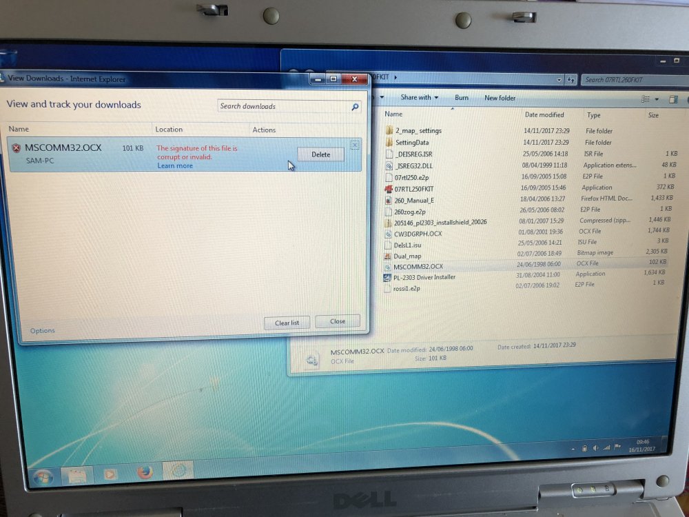

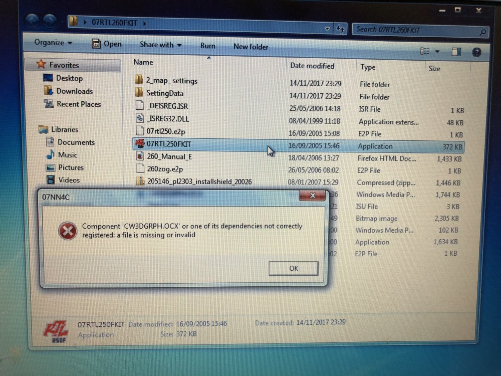

sando994 Posted November 16, 2017 Author Report Share Posted November 16, 2017 Hi Jimmyl, what windows system do I need to be running? I have tried it on windows 7 32bit but it I’m struggling to install the software. This is is all the files on the disc that I bought. also in the pics are the problems I’m having when trying to open the 07 application. So I’ve potentially been sold the wrong stuff, using the wrong version of Windows or need to install some sort of software to be able to open these files....... anyone that could point ne in the right direction?? Quote Link to comment Share on other sites More sharing options...

boringac Posted November 16, 2017 Report Share Posted November 16, 2017 Whats in the compressed folder (205146_pl2303_installshield_20026) P.s. I've never used the software! Quote Link to comment Share on other sites More sharing options...

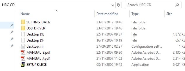

teddybattye Posted November 16, 2017 Report Share Posted November 16, 2017 Your CD hasn't got the right files showing. you should have a setupex.exe to install the software Quote Link to comment Share on other sites More sharing options...
teddybattye Posted November 16, 2017 Report Share Posted November 16, 2017 you also need to run the PL-2303 driver installer on your machine to install the drivers Quote Link to comment Share on other sites More sharing options...
sando994 Posted November 16, 2017 Author Report Share Posted November 16, 2017 All sorted now, with thanks to teddybattye ?? Much appreciated Quote Link to comment Share on other sites More sharing options...
