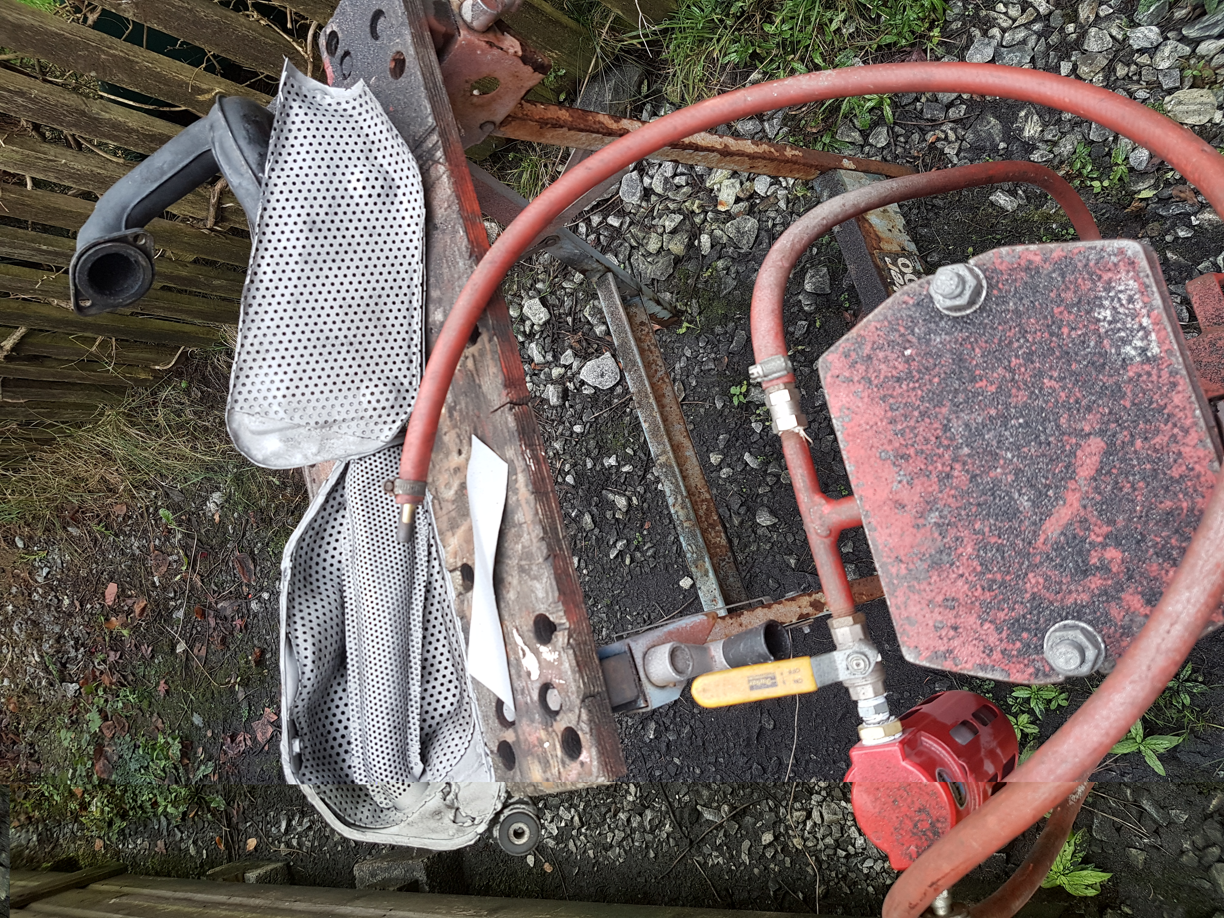

Hey! That's my mid box! Looks identical!
Actually one of mine was even worse as all the holes at the header end were closed up with hard carbon.

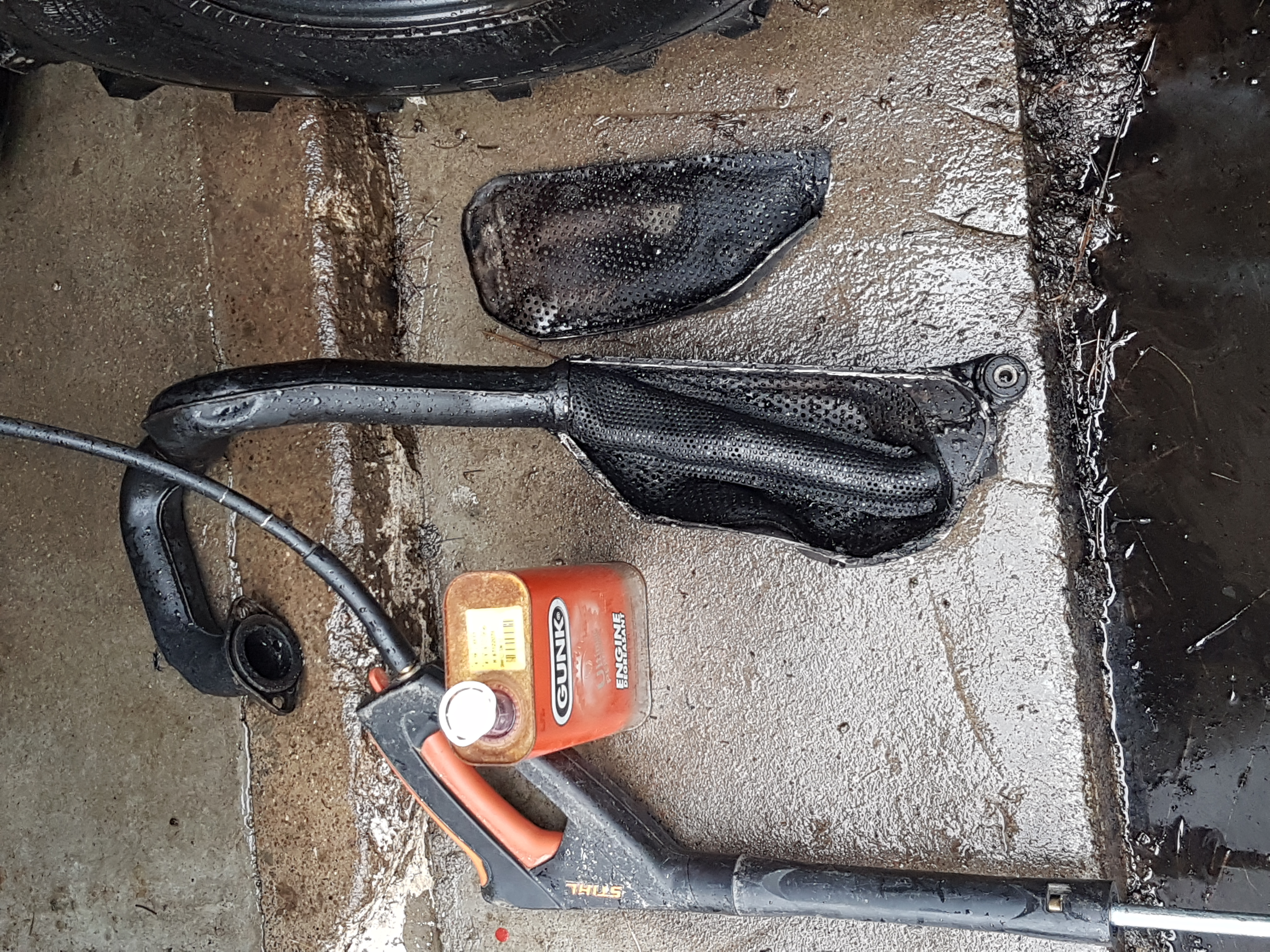

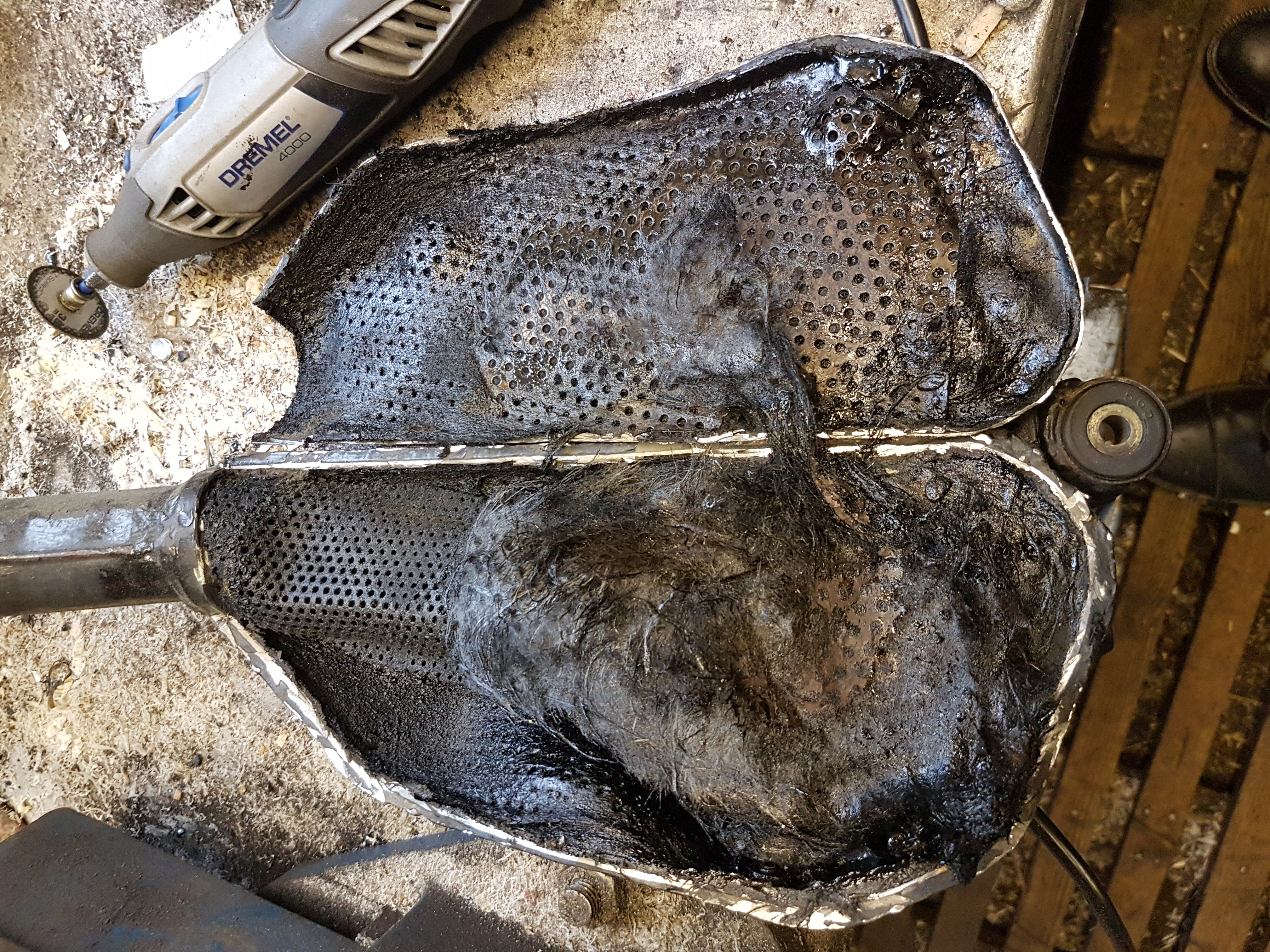

Now, pics of it once finished and cleaned, and prior to repacking and welding up. Then.... tell us how many hours you spent on it....

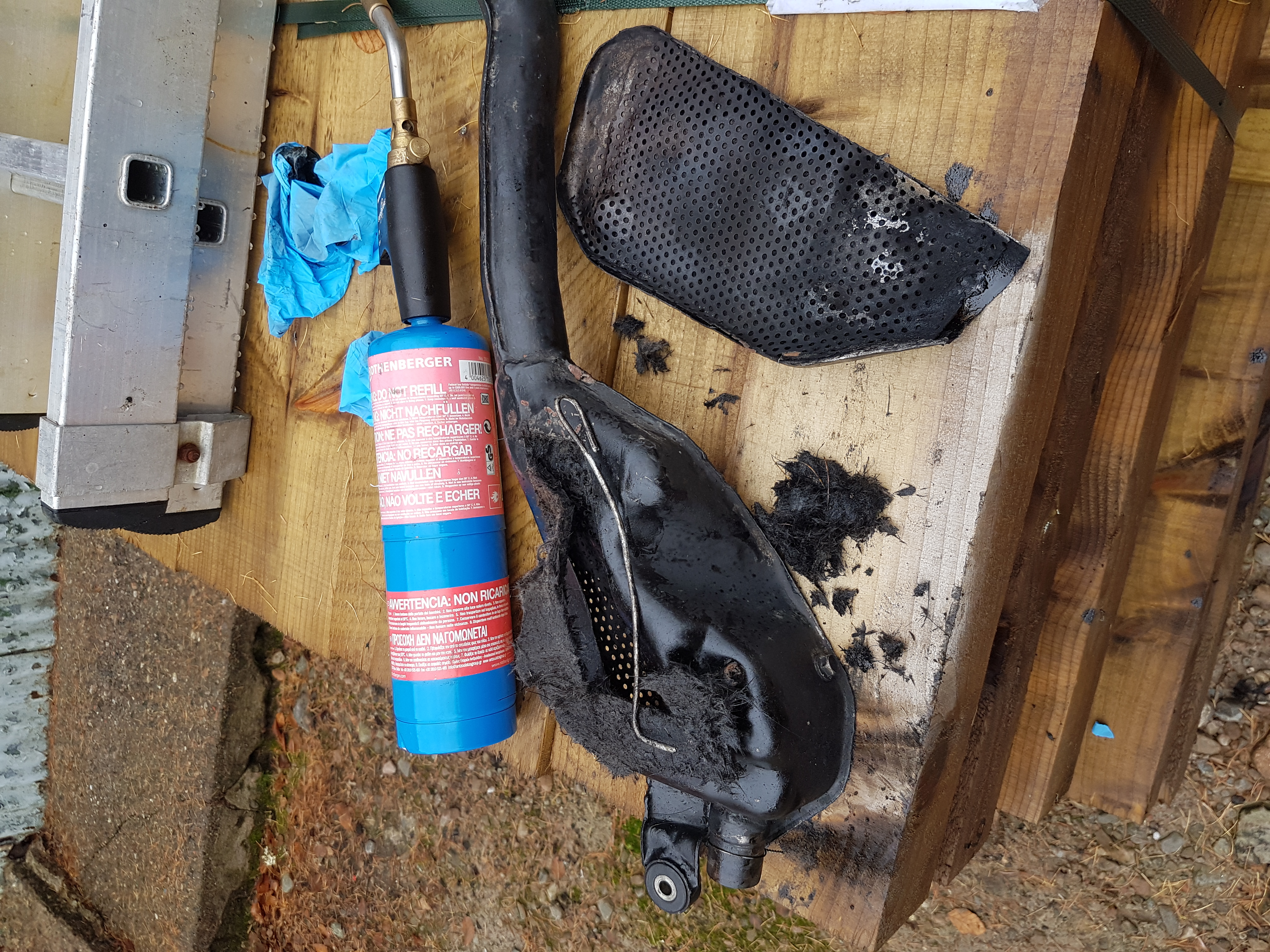

Three hours including lunch !!!.But I did have a high-tech piece of bent wire.
