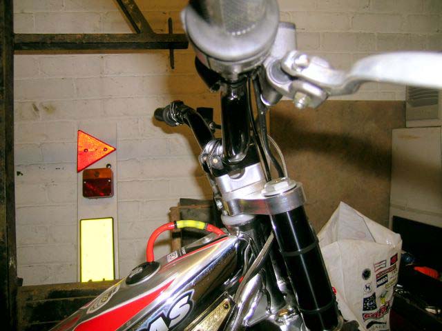

spud Posted December 26, 2005 Report Share Posted December 26, 2005 Done this to mine i'm 6.0 foot and 13 stone Quote Link to comment Share on other sites More sharing options...
uhoh7 Posted December 26, 2005 Author Report Share Posted December 26, 2005 Done this to mine i'm 6.0 foot and 13 stone <{POST_SNAPBACK}> How much of a rise is that? TY for pics Quote Link to comment Share on other sites More sharing options...
spud Posted December 29, 2005 Report Share Posted December 29, 2005 Done this to mine i'm 6.0 foot and 13 stone <{POST_SNAPBACK}> How much of a rise is that? TY for pics <{POST_SNAPBACK}> 1.5inch's. The bars have also now been pushed forward to a more upright position. I Quote Link to comment Share on other sites More sharing options...
trial_master Posted December 30, 2005 Report Share Posted December 30, 2005 SPUD. Are they 20mm conduit sadles you have used as your raisers? If they are that is a good idea! Ryan Quote Link to comment Share on other sites More sharing options...
spud Posted January 4, 2006 Report Share Posted January 4, 2006 SPUD.Are they 20mm conduit sadles you have used as your raisers? If they are that is a good idea! Ryan <{POST_SNAPBACK}> Not sure what conduit saddles are. My bike as handlebar clamps used as spacers of a 04 Gas Gas. The spacer below them was made by my neighbour from alloy, and he also sourced two longer bolts for the clamps. The four standard bolts for the clamps have two sizes. What I did was use the original (long ones) to fit in place of shorter standard bolts and then fitted the new two extra long bolts in their place. You'd be hard pushed to visual see this mod on the bike if I didn't point it out, which is what I liked because the Raga bars are tops. Quote Link to comment Share on other sites More sharing options...
