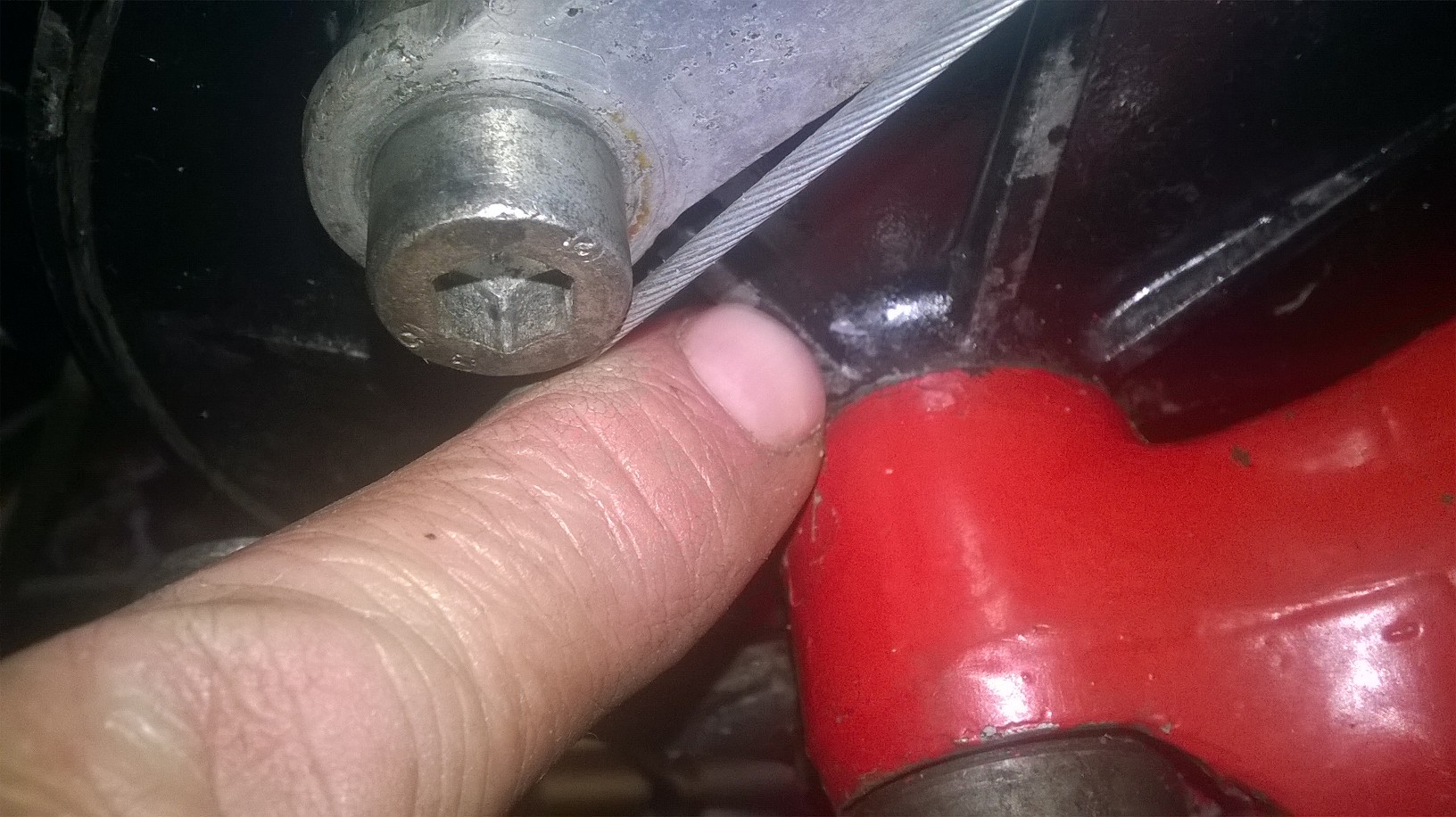

fiona Posted November 19, 2017 Report Share Posted November 19, 2017 My husband recently bought a Cota 349. He has noticed that the front wheel does not sit central within the front forks. If he tries to use shims/spacers on the axle to centralise the wheel then the front suspension doesn't seem to work properly (stiff and not return properly). There isn't any speedo fitted. Does the wheel normally sit slightly towards the right hand fork, or anyone suggest how to rectify this. Thanks in advance. Quote Link to comment Share on other sites More sharing options...
feetupfun Posted November 20, 2017 Report Share Posted November 20, 2017 The rim and tyre should be in the centre between the forks. The rim can usually be moved left or right by adjusting the spokes. It's possible that it has a non-standard wheel so if you post up photos, you will get help with that. Quote Link to comment Share on other sites More sharing options...
fiona Posted November 20, 2017 Author Report Share Posted November 20, 2017 (edited) Thanks feetupfun. I'll get my husband to take some pictures and post here. And he went for the easiest fix. Ground off 4mm from the brake sit of the drum and used a 4mm shim on the opposite side. All square now. Edited November 20, 2017 by fiona update post Quote Link to comment Share on other sites More sharing options...
