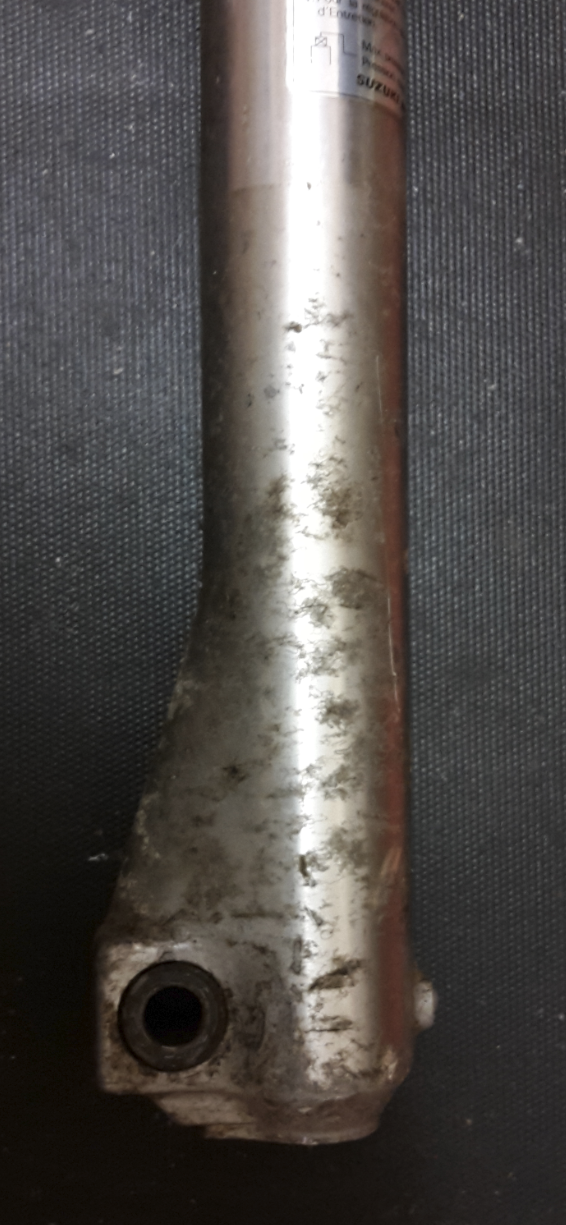

bultacorock Posted November 27, 2017 Report Share Posted November 27, 2017 Im Rebuilding a black engine Beamish Suzuki and i was trying to work out the best way to clean up the fork legs, has any one got any tips please on the best way to clean them so the look a bit better ? Quote Link to comment Share on other sites More sharing options...
tony27 Posted November 27, 2017 Report Share Posted November 27, 2017 The legs are generally clear coated which needs removing fully if you want to make them look better so it's not really just a cleaning thing 1 Quote Link to comment Share on other sites More sharing options...
vanman1950 Posted November 28, 2017 Report Share Posted November 28, 2017 As stated covered in lacquer from new, best option use paint stripper to remove said lacquer and use Peek metal polish to restore then rely on polish from then on. 1 Quote Link to comment Share on other sites More sharing options...
