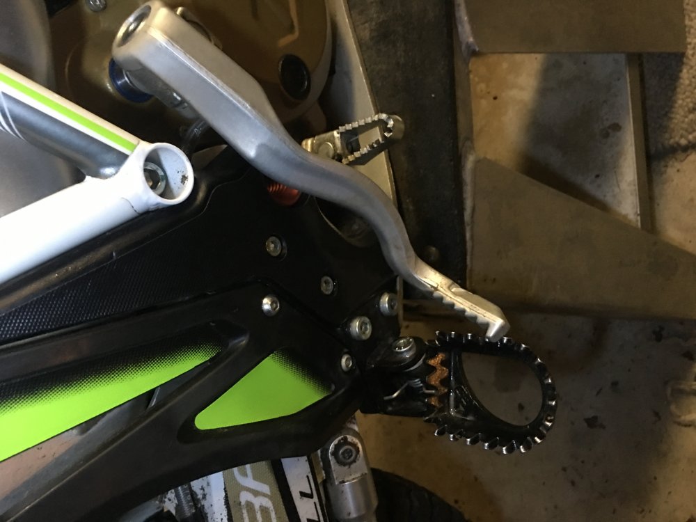

patracing Posted November 29, 2017 Report Share Posted November 29, 2017 Has anyone had a problem with their kick starter catching on their foot peg? Quote Link to comment Share on other sites More sharing options...

danbillam Posted November 29, 2017 Report Share Posted November 29, 2017 my brothers had a 16 ice hell for a few weeks and its caught up on the footpeg exactly like this loads of times. Quote Link to comment Share on other sites More sharing options...
cackallacky Posted December 1, 2017 Report Share Posted December 1, 2017 Yes, even on the 17 Ice Hell! Quote Link to comment Share on other sites More sharing options...
heffergm Posted December 1, 2017 Report Share Posted December 1, 2017 I can only remember having it happen a handful of times... Quote Link to comment Share on other sites More sharing options...
patracing Posted December 1, 2017 Author Report Share Posted December 1, 2017 Yes, I have a 2017 Ice Hell too. No fix? Quote Link to comment Share on other sites More sharing options...
heffergm Posted December 1, 2017 Report Share Posted December 1, 2017 I suspect you could just file down the trailing edge of the kicker a little to get it to clear the peg. 1 Quote Link to comment Share on other sites More sharing options...
patracing Posted December 2, 2017 Author Report Share Posted December 2, 2017 Thanks for all your help! Quote Link to comment Share on other sites More sharing options...
evo boy Posted December 2, 2017 Report Share Posted December 2, 2017 I wonder if different Pegs would help only a thought tho. 2 Quote Link to comment Share on other sites More sharing options...
tcrhino Posted December 2, 2017 Report Share Posted December 2, 2017 1 hour ago, evo boy said: I wonder if different Pegs would help only a thought tho. No, they don't. I have S3 pegs on mine and occasionally the kickstarter catches the peg. What does help is to stop the kick earlier. On an Ossa the kickstarter damages the footrest mount (which I didn't like...). I learned to kick hard at the start of the stroke and stop before hitting the mount. Same technique on the Vertigo prevents catching the peg. 1 Quote Link to comment Share on other sites More sharing options...
