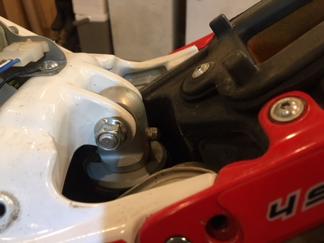

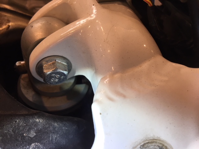

markbxr400 Posted December 2, 2017 Report Share Posted December 2, 2017 Have done searches, and can't find much on the way of getting to the rear shock assembly on an EVO 4T to replace the spring. I've read where some have had to pull the air boot, pull the exhaust, kick stand and the entire shock linkage assembly to get the shock out. I'm just wanting to replace my spring. If I pull the exhaust, pull the top bolt and then spin back the large spring lock nuts, 1. Does the large slotted washer at the top of the shock simply slide out? 2. Would it then be possible to let the swingarm fall a little more after removing the top shock bolt and wiggle the spring out from the top? If not, what is the simplest way to get at the rear spring? I'll measure where the shock lock nuts are to get the pre-load back close to where it was with the other spring, but then I plan to adjust my static and rider sag anyway when I'm done. Any help is appreciated. Mark Quote Link to comment Share on other sites More sharing options...

danbillam Posted December 2, 2017 Report Share Posted December 2, 2017 Ive changed the spring on 16 and 17 without removing the shock although they was 2 strokes so could be different. Doesn't take long at all. Pull airbox off Exhaust silencer off undo top shock bolt and take the preload off the spring then the collar clips out and pull off the spring. 1 Quote Link to comment Share on other sites More sharing options...
markbxr400 Posted December 3, 2017 Author Report Share Posted December 3, 2017 3 hours ago, danbillam said: Ive changed the spring on 16 and 17 without removing the shock although they was 2 strokes so could be different. Doesn't take long at all. Pull airbox off Exhaust silencer off undo top shock bolt and take the preload off the spring then the collar clips out and pull off the spring. Thanks, will give it a whirl. 1 Quote Link to comment Share on other sites More sharing options...
