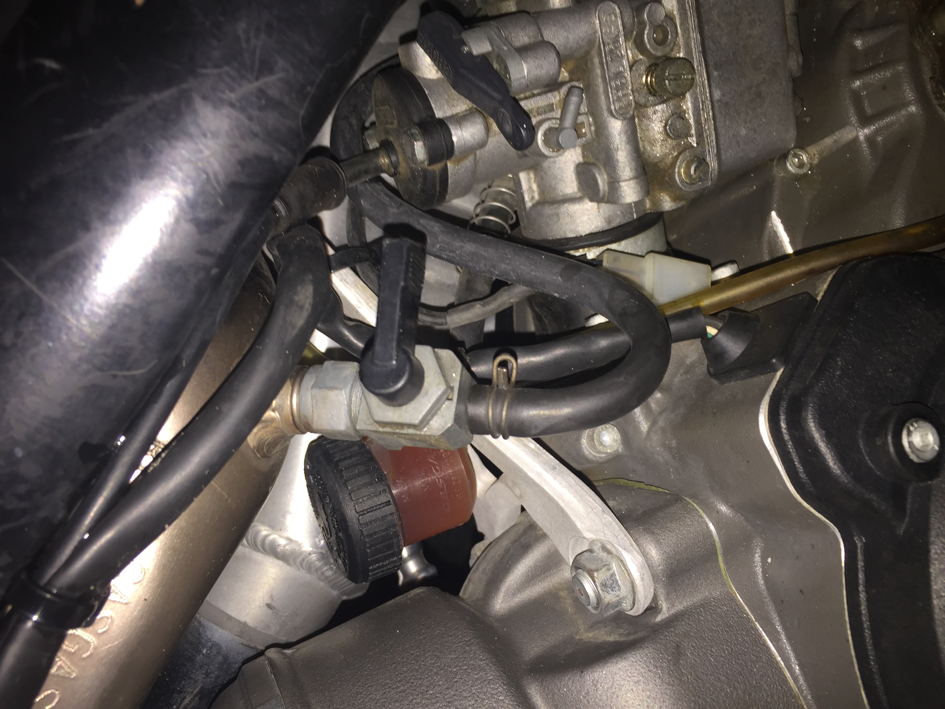

miner Posted December 11, 2017 Report Share Posted December 11, 2017 Assume these are similar / same for all? Serviceable? Or bin them and replace? I noticed what I thought was fuel from the overflow.... then I noticed it dripping (into the pulser coil as well - nice!)... pushed it in and it stopped.... put it on reserve and it started dribbling out. Let me know about the above.... going home in a couple of weeks, can get spares by pony express. Cheers. Quote Link to comment Share on other sites More sharing options...
basil Posted December 11, 2017 Report Share Posted December 11, 2017 Complete tap only about 50 Dinar or £15 and available at many trials outlets PSbring some sun back with you its snowing here 1 Quote Link to comment Share on other sites More sharing options...
code54 Posted December 12, 2017 Report Share Posted December 12, 2017 Yep -splat shop or others have them. There are 2 versions so make sure you get the one for your year TXT. Takes about 10 minutes start to finish to replace including grabbing your tools. 1 Quote Link to comment Share on other sites More sharing options...
miner Posted December 12, 2017 Author Report Share Posted December 12, 2017 Can’t change the o-rings? To be fair the KTM ones aren’t serviceable... Quote Link to comment Share on other sites More sharing options...
