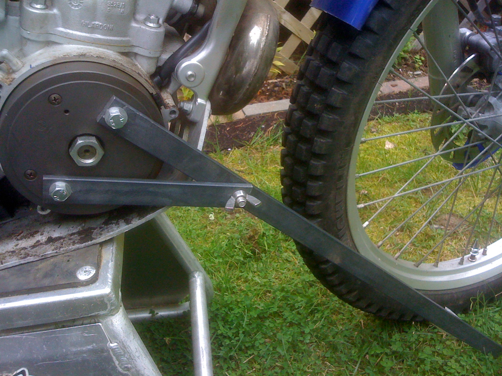

dan williams Posted December 16, 2017 Report Share Posted December 16, 2017 Sorry late to the party on this but here is the flywheel holder I cobbled together for use on Betas. Actually I've made a few since they keep getting borrowed then disappear. Works like a charm. Piece of bar stock. One cut, three holes. Can even make a handle on the far end. Vitally important to not screw in the bolts on the flywheel deeper than the flywheel or you destroy the stator. Short bolts or washers/nuts as shims is a good idea. 1 Quote Link to comment Share on other sites More sharing options...
danbillam Posted December 16, 2017 Author Report Share Posted December 16, 2017 On 12/16/2017 at 4:36 PM, dan williams said: Sorry late to the party on this but here is the flywheel holder I cobbled together for use on Betas. Actually I've made a few since they keep getting borrowed then disappear. Works like a charm. Piece of bar stock. One cut, three holes. Can even make a handle on the far end. Vitally important to not screw in the bolts on the flywheel deeper than the flywheel or you destroy the stator. Short bolts or washers/nuts as shims is a good idea. Expand cheers mate managed fine with a strap wrench. Quote Link to comment Share on other sites More sharing options...
dan williams Posted December 16, 2017 Report Share Posted December 16, 2017 As long as you got it to the correct torque it’s all good. I was thinking about it and I would imagine you want it to move and shear the key under unusual loads rather than twist the crank. Quote Link to comment Share on other sites More sharing options...
