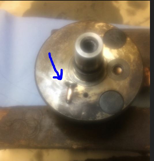

guidobetaevo300 Posted December 14, 2017 Report Share Posted December 14, 2017 (edited) Hello, on my Beta Evo 300 2 stroke 2012 a bolt came loose and blocked my crankshaft. The bolt came out my crankshaft itself, we think a production issue, bad use of locktide product or even no locktide used while crankshaft parts were merged See picture from the bolt who came loose from the inside of crankshaft Does anyone had this problem in the past or heared about ? Thanks Guido Edited December 14, 2017 by guidobetaevo300 Quote Link to comment Share on other sites More sharing options...

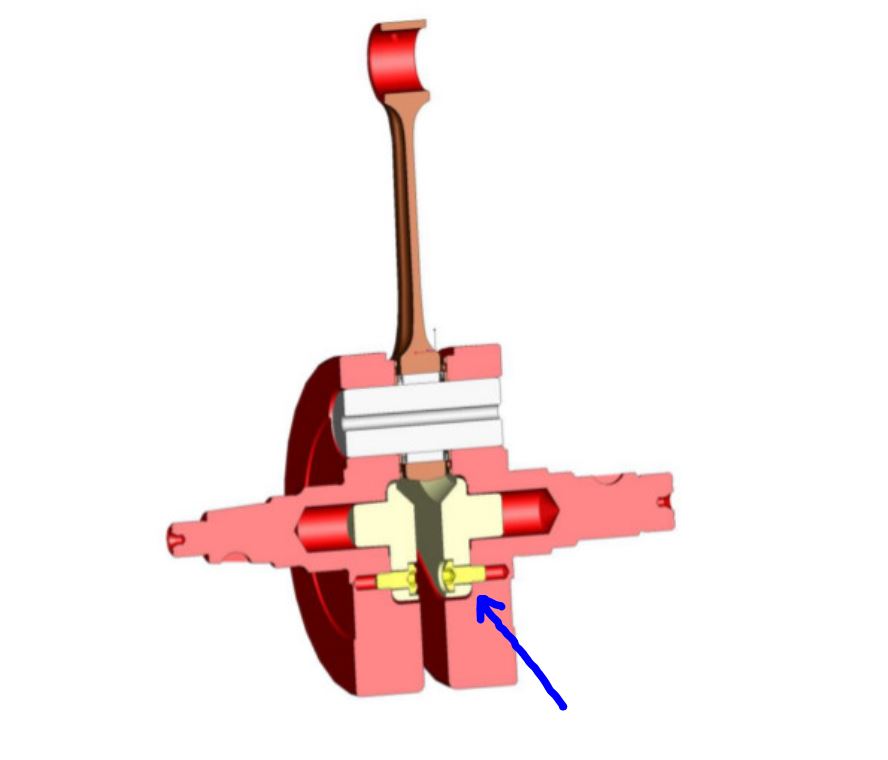

peterb Posted December 15, 2017 Report Share Posted December 15, 2017 Buongiorno Guido, most, if not all of the current 2T trial motors use this type of fixing screw to hold a plastic plug in place, to the inner side of each crankshaft flywheel. The flywheels are machined opposite the crank pin to reduce weight there, in order to provide a balancing effect. As the steel is machined away, the volume removed is replaced with the lighter weight plastic so as to maintain maximum primary compression. Bye, Peter B. 1 Quote Link to comment Share on other sites More sharing options...
guidobetaevo300 Posted December 15, 2017 Author Report Share Posted December 15, 2017 On 12/15/2017 at 9:00 AM, peterb said: Buongiorno Guido, most, if not all of the current 2T trial motors use this type of fixing screw to hold a plastic plug in place, to the inner side of each crankshaft flywheel. The flywheels are machined opposite the crank pin to reduce weight there, in order to provide a balancing effect. As the steel is machined away, the volume removed is replaced with the lighter weight plastic so as to maintain maximum primary compression. Bye, Peter B. Expand Hello Peter, Thanks for this info, but do you think its normal that one of these screws come loose and start to block and dammage the engine Inside ... ? Did you ever heared about it ? Quote Link to comment Share on other sites More sharing options...

guidobetaevo300 Posted December 15, 2017 Author Report Share Posted December 15, 2017 On 12/15/2017 at 2:51 PM, lineaway said: Pretty simple, It`s an old bike now no matter how much time is on it. Either put a new bolt back in with sealant or buy a whole new crank. I just hope my 2016 never does it! Expand of corse we'll fix it with a new bolt and new conrod, my question was either the fact that this can happen, and can happen on any model of year i am afraid so Quote Link to comment Share on other sites More sharing options...
