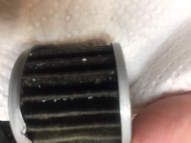

markbxr400 Posted June 7, 2019 Report Share Posted June 7, 2019 Just did my new 17 4RT260 and new 17 300RR (well, sort of). The 260 went like clockwork, case came off easily with gasket intact, after tapping around the edges with a small dead blow hammer. While the filter was a little bit of a pain, I just kind of flattened about 1/2" of the edge of the hat with my needle nose pliers, lined it up with where it needs to rub the outside edge of the case, and it came right out. Grease was the trick on the spring for reinstall. Going in, I found if I spun the flywheel slightly to where the filter lined up with one of the longer slots on the side/round edge of the flywheel, I could press the filter down under the lip on the case, then it popped right in. On the 300RR, I managed to strip the allen head on one of the rear skidplate bolts, so that took me out of the game as far as replacing the filter. So I just changed the engine and transmission oils. Have ordered 10 of those skid plate bolts, and will drill/easy-out the stripped one at the next oil change. Used the HTX740 for the transmission and Honda Pro HP4 10W40 for the engine. Cleaned and oiled the air filters as well. Thanks for all the help on this forum. Took a little time, but was pretty straightforward. Quote Link to comment Share on other sites More sharing options...

markbxr400 Posted June 7, 2019 Report Share Posted June 7, 2019 I also installed hour meters on every bike, lawnmower, tractor, generator, etc that I own. I like to know where I'm at on all of this. Regarding the filters, New 2017 4RT 260 purchased in January - 3.7 hours: When I drained the engine oil from the 260, it was pretty clear amber. I let it run over my fingers and noticed very little dark streaks but some fine metal flecks. When I pulled the oil filter, I also noticed metal flecks and noticed darker coloration. The bottom screen also had some metal flecks. When I drained the tranny oil, it was also mostly a clear amber color, but I noticed some black streaking (very fine particles). New 2017 300RR purchased in May - 1.22 hours: Surprisingly, the engine oil was much darker than I found on the 260. I think the dealer ran the bike more than he claimed. It wasn't black, but definitely dirtier than the 260. About the same amount of metal flecks as the 260 when I let it run over my fingers. I wasn't able to pull the oil filter or screen due to stripping the head on one of the rear slid plate bolts, and my not wanting to try to get the side cover off with the skid plate in tact. The tranny oil looked about the same as the 260 - clear amber with some black streaking. I will definitely be changing the oil and filter again when I get back from Michigan and my replacement skid plate bolts arrive, as I want to get a baseline on that filter. My plan going forward, now after initial break-in: Change the engine oil every 15 hours Change the oil filters every 30 hours (but still will do the 300RR in the next couple of weeks) Change the tranny oil every 30 hours Clean the air filters as needed, probably every couple of trials, depending on dust. To me, oil changes, air filter cleaning and valve adjustments are the most critical maintenance things to get long life out of these motors. While I don't send samples off for analysis as some do, my taking the time to look at them periodically gives me a good indication of whether I should expect any looming problems. Here's a pic of the 260 oil filter that was pulled at 3.6 hours: 2 Quote Link to comment Share on other sites More sharing options...
