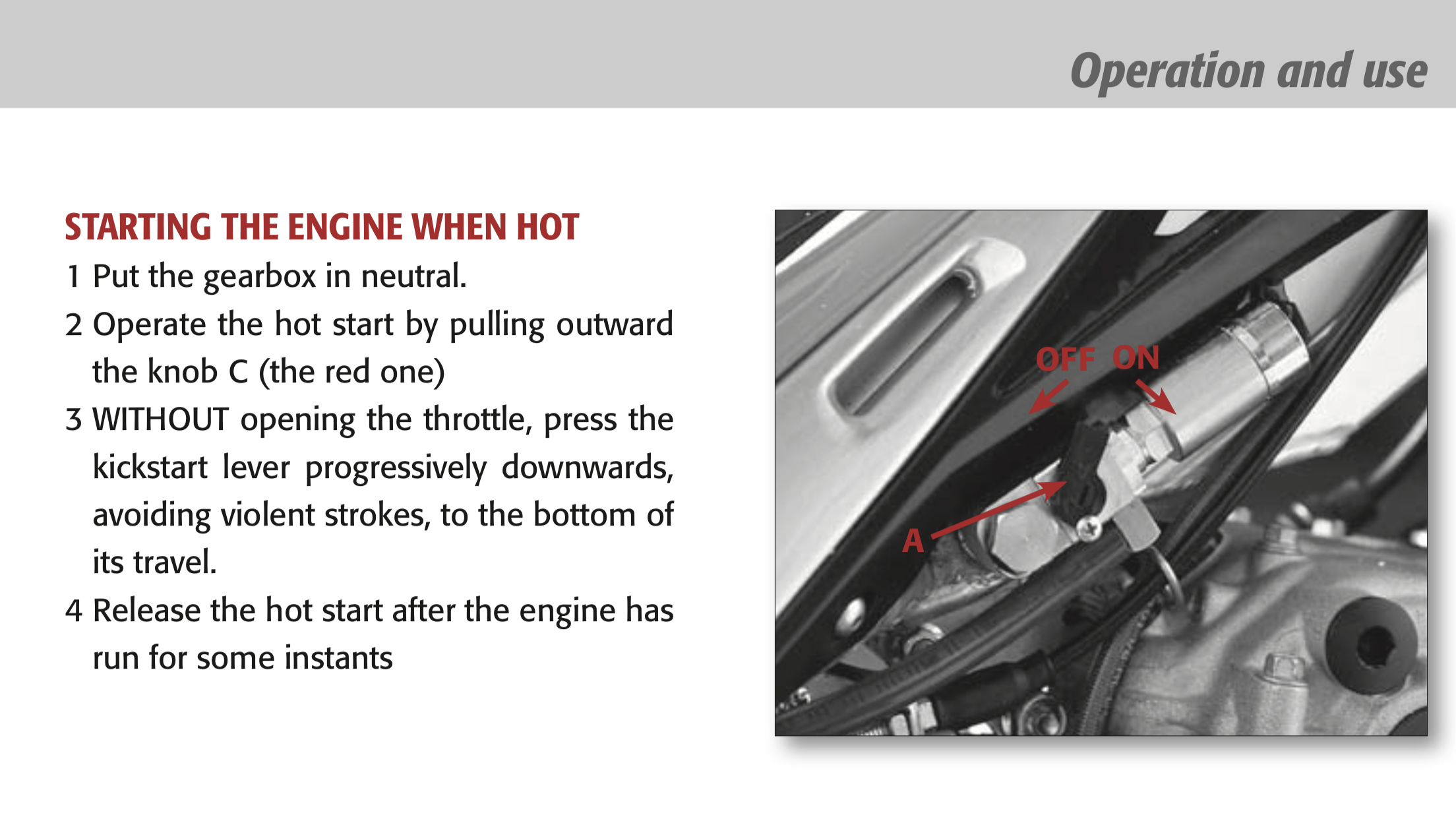

petert Posted December 29, 2017 Report Share Posted December 29, 2017 Is the electric fuel tap OK? Quote Link to comment Share on other sites More sharing options...
bonito Posted December 29, 2017 Author Report Share Posted December 29, 2017 On 12/29/2017 at 4:22 PM, petert said: Is the electric fuel tap OK? Expand I was wondering that too. How does that thing work anyway? Previous owner told me just leave it and its ok, I haven't touched it since I got the bike. I have tried various positions on the first day, but can't see any difference Quote Link to comment Share on other sites More sharing options...
portman Posted December 29, 2017 Report Share Posted December 29, 2017 I suggest you also check the tank cap to make sure it is allowing air in to replace the fuel flowing out to the carb. The cap incorporates a one-way valve to ensure fuel does not escape when the bike is upside down/on its side. You can check two ways. If the bike is misbehaving again, undo the tank cap completely and it it runs OK that's probably your problem. Alternatively, remove the cap and let the air get to it to evaporate any fuel or vapour. Then alternatively suck/blow on the tiny black breather pipe on the cap to see if allows air through one way (as if into the tank) but not the other way. 4 Quote Link to comment Share on other sites More sharing options...
portman Posted December 29, 2017 Report Share Posted December 29, 2017 On 12/29/2017 at 4:37 PM, bonito said: I was wondering that too. How does that thing work anyway? Previous owner told me just leave it and its ok, I haven't touched it since I got the bike. I have tried various positions on the first day, but can't see any difference Expand The tap has a solenoid (an electrical coil which generates a magnetic field which attracts the centre core causing it to move and open the tap). As soon as the engine turns over sufficient electrical energy flows to the tap to open the fuel flow. The tap also includes an alternative setting to allow the carb to be filled with fuel (primed) in those situations such as where the bike has been out of use for some time and the carb contains no fuel. Can't remember which position is the priming one but the owners manual shows it clearly. If you search the Beta forum on this site there's some more info to be gained. 1 Quote Link to comment Share on other sites More sharing options...
bonito Posted December 29, 2017 Author Report Share Posted December 29, 2017 On 12/29/2017 at 6:01 PM, portman said: The tap has a solenoid (an electrical coil which generates a magnetic field which attracts the centre core causing it to move and open the tap). As soon as the engine turns over sufficient electrical energy flows to the tap to open the fuel flow. The tap also includes an alternative setting to allow the carb to be filled with fuel (primed) in those situations such as where the bike has been out of use for some time and the carb contains no fuel. Can't remember which position is the priming one but the owners manual shows it clearly. If you search the Beta forum on this site there's some more info to be gained. Expand found it Quote Link to comment Share on other sites More sharing options...
