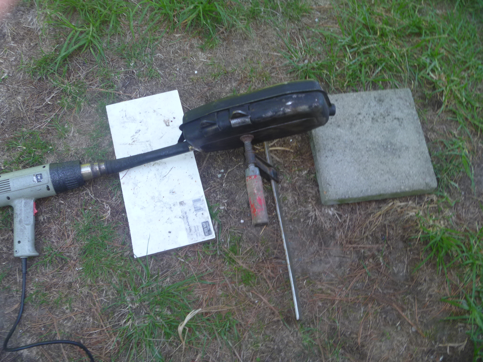

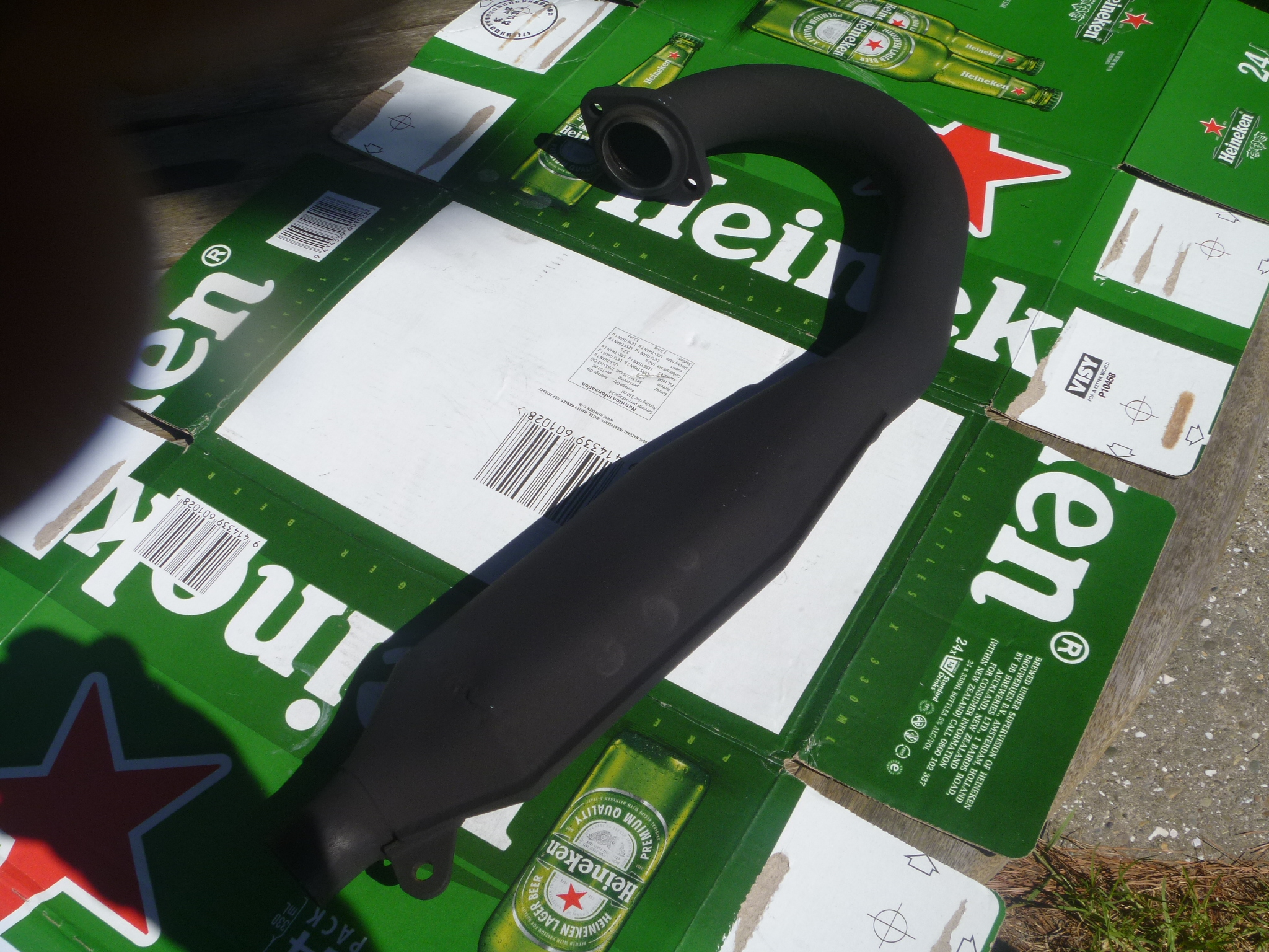

potto Posted January 27, 2018 Author Report Share Posted January 27, 2018 On 1/24/2018 at 8:57 AM, collyolly said: Are they the correct rear shocks with regard to length ? The rear wheel looks a long way down from the mudguard, somethings not right there I think. All good checked on that ,old shocks were infact 320mm ,swingarm has been chopped @ some stage,you are correct my bike is a like high....appears around 5mm more that factory manual,honestly not worried. Stripped old paint and rust off front pipe and painted with VHT flat black 1300 degree exhaust paint. Did a burnout on the rear muffler cause it was heavy and dropping lumps of carbon everywhere,results were great it smoked like a bugger for 20mins and then came clear...my hillbilly setup; Quote Link to comment Share on other sites More sharing options...

potto Posted January 28, 2018 Author Report Share Posted January 28, 2018 Then I had a rethink and decided what I thought was just an expantion area in the front pipe appears to be a primary muffler which I'am sure will be full of crap like the rear muffler....don't know but I might burn it out also. The rear muffler still has rust in in but know that won't burn out so it stays,the method I used for the rear muffler is really good so hoping similar results. Put an order into InMotion but had to limit it due to brutal shipping rates and of course Kiwi $ to UK pounds is another issue. Quote Link to comment Share on other sites More sharing options...

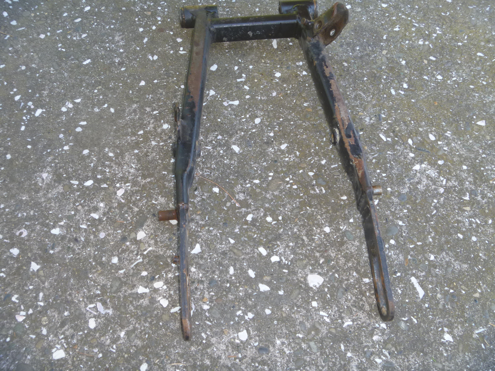

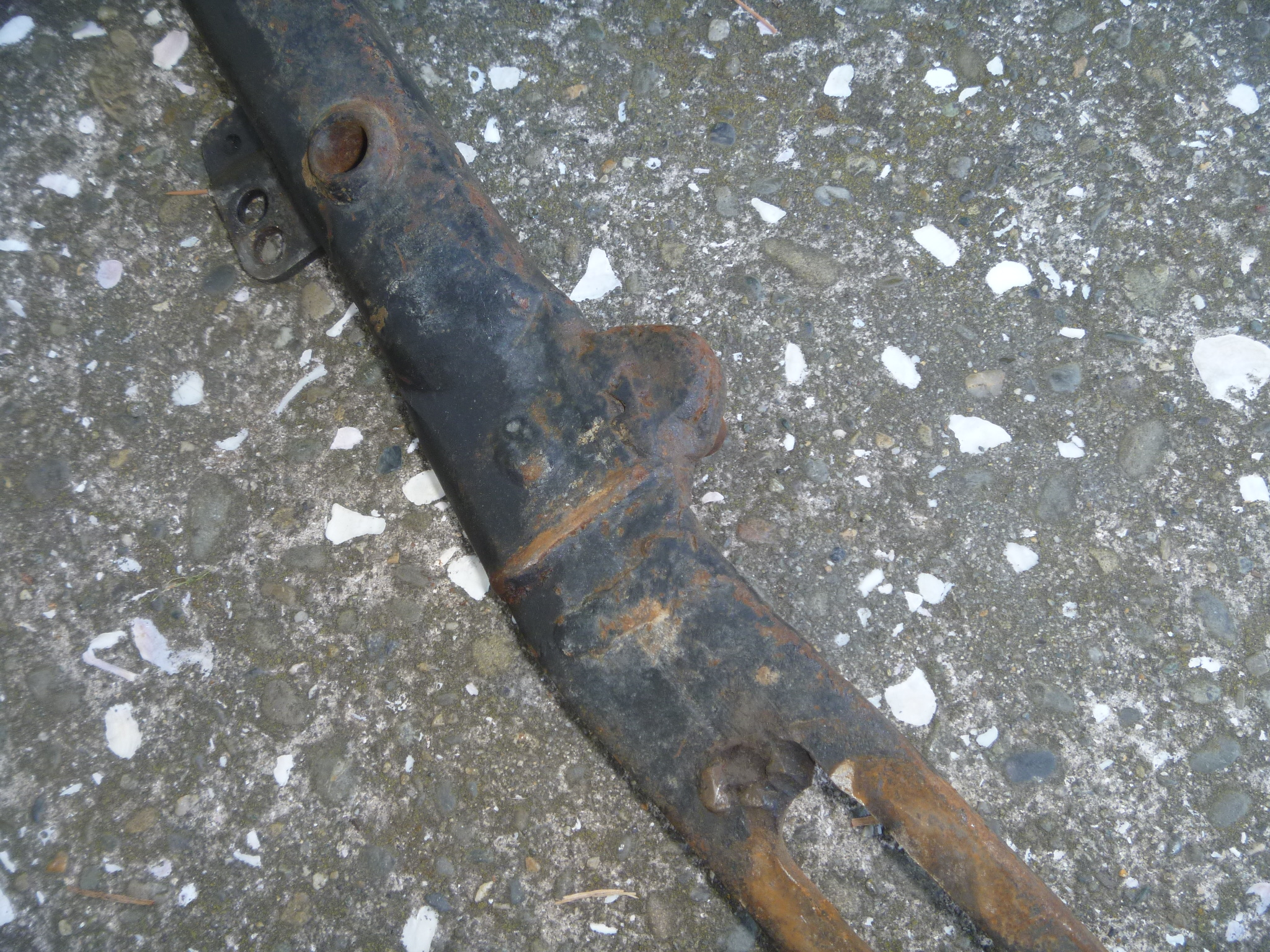

potto Posted February 8, 2018 Author Report Share Posted February 8, 2018 On 2/4/2018 at 8:23 PM, feetupfun said: Yuk Yuk and double yuk ok,insurance company aren't answering my calls/email think they are swamped....a bit like my boat . I suspect my 4 stroke Honda is now a total loss,least its not the house Porsche or my bike. Remove swingarm today to sort previous cock-ups done in the past,its a real mess as is the frame. Quote Link to comment Share on other sites More sharing options...

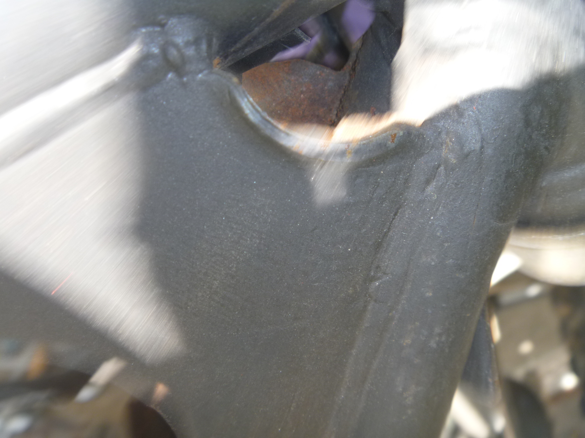

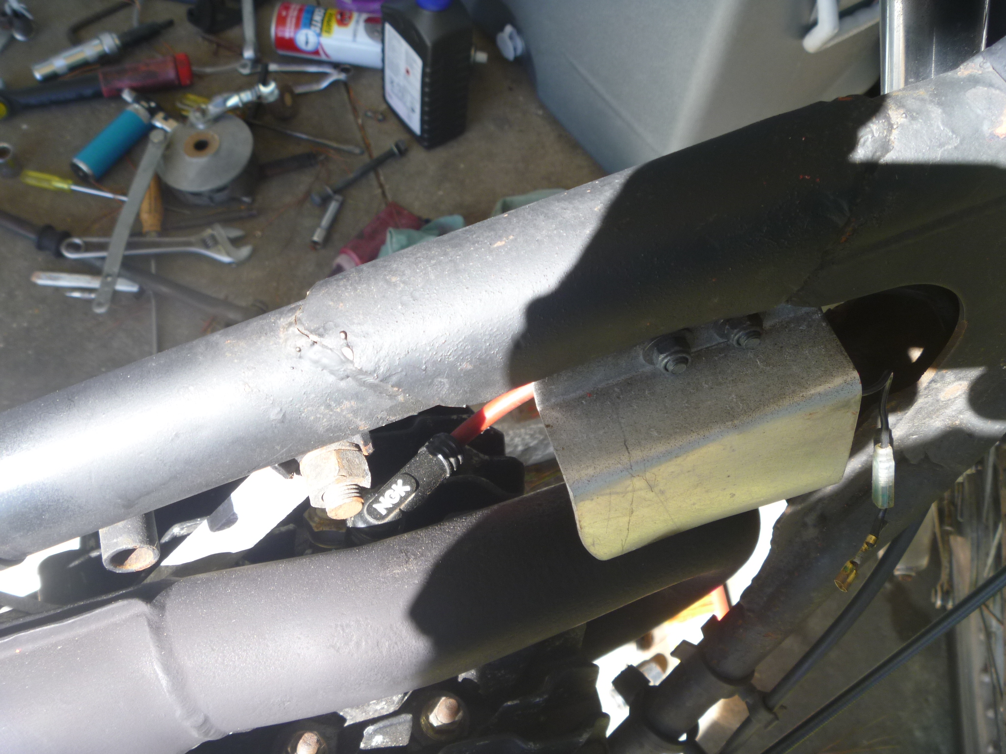

potto Posted February 8, 2018 Author Report Share Posted February 8, 2018 More crap stuff....top frame cracked so some monkey put a thick wall pipe sleeve over it,other pic is cracks around the upper steering head tubes. The swingarm is totally out of square and mods done are shocking....will be busy tomorrow . 1 Quote Link to comment Share on other sites More sharing options...
2stroke4stroke Posted February 8, 2018 Report Share Posted February 8, 2018 The front box is indeed a silencer and, like the rear one, will need to be repacked once you have done the burning. This means cutting a flap in the back of it then welding up again. I did this with my 348 all those years ago and it made a big difference to the running of the motor - smoother bottom end meaning I could pull a higher gear in marginal conditions. 1 Quote Link to comment Share on other sites More sharing options...
oldaz Posted February 8, 2018 Report Share Posted February 8, 2018 7 hours ago, potto said: Remove swingarm today to sort previous cock-ups done in the past,its a real mess as is the frame. Welcome to my world. Currently working through the power unit, surprisingly only a few "modifications" to correct. My exhaust system still to be tackled, good hints above for me. Quote Link to comment Share on other sites More sharing options...
