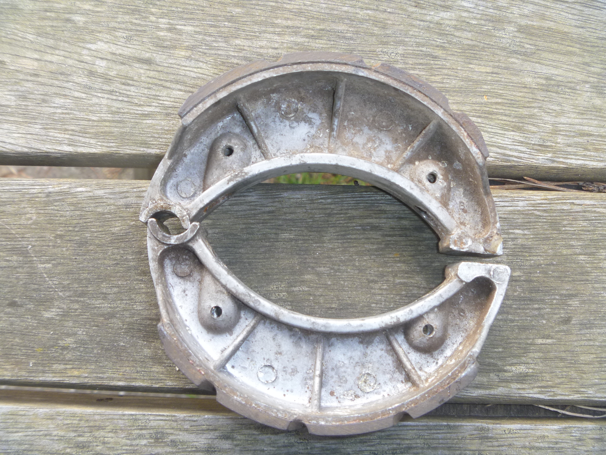

potto Posted February 28, 2018 Author Report Share Posted February 28, 2018 On 2/18/2018 at 6:45 PM, potto said: Thanks you are correct just looked @ my manual and see them,the lining aren't too bad so I will make replacements,cheers. Expand Well I did find after further inspection the brake shoe cam was in poor condition....looks like someone had taken a grinder to it,hunted through my hoard of bike parts and found a near new set of 100mm brake shoes,they had the metal slips bonded on them and due to the thicker linings a test fit revealed a great working rear brake.....happy camper. My alloy brake pedal was in a poor state and cracked so I fabbed one out of steel with a hardened steel pivot bush,a bit of work but works good. My leg is fully healed so I fired up the bike which took a little more kicks than expected,appears it only starts on the choke where before it didn't need it.....not sure whats changed???. Engine ran much crisper and after a ride it felt like it had more power,I can only assume burning out the rear muffler had the desired result. Few bugs to sort but happy with the results . 1 Quote Link to comment Share on other sites More sharing options...

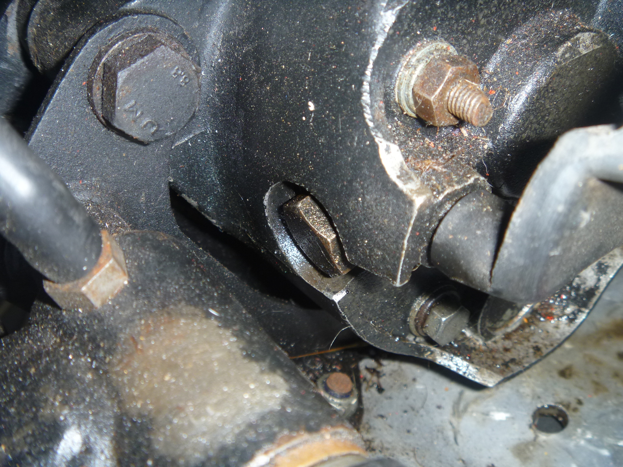

potto Posted March 11, 2018 Author Report Share Posted March 11, 2018 Starting to put bike together again,it was pointed out to me sometime back the shocks I purchased were too long,this is true and not only caused the rear height to be wrong but caused the shock to be "firmish",machined up some 12mm bolts up and mounted them on the swingarm which resulted in the bike setting correctly and the shocks now feel right. While removing the swingarm I noticed an oil leak which turned out to be @ a recessed plug in the engine case ...can anyone tell me what its function is and how it sealed,thanks Quote Link to comment Share on other sites More sharing options...
feetupfun Posted March 12, 2018 Report Share Posted March 12, 2018 I'm pretty sure that inside that hollow "bolt" is a spring loaded plunger that holds the shift drum in the right spot for each of the gears. There is a cam on the shift drum with multiple indentations, one for each gear. Normally there's a copper washer under the head of that "bolt" to seal it. If you want to pull it out to fix the leak, you can pull it out and put it back in without causing any problems with the shifting mechanism. The plunger and spring will be able to fall out of the "bolt" though. May need to take the swingarm out to give clearance to get it out or maybe not. I have only had that "bolt" out with the engine out of the bike. Quote Link to comment Share on other sites More sharing options...
potto Posted March 12, 2018 Author Report Share Posted March 12, 2018 It is rather hard to get to even with the swingarm out ,thinking its leaking for that reason....too hard to get to ? The only solution I can see is to put a thin wall socket in there with a piece of flat or bar welded to it as there is no way a ratchet will fit in,the rear engine mounts in the way also . I'am not removing the engine until I do frame repairs and repaint so hope the above method works,thanks for the reply feetupfun. Quote Link to comment Share on other sites More sharing options...
