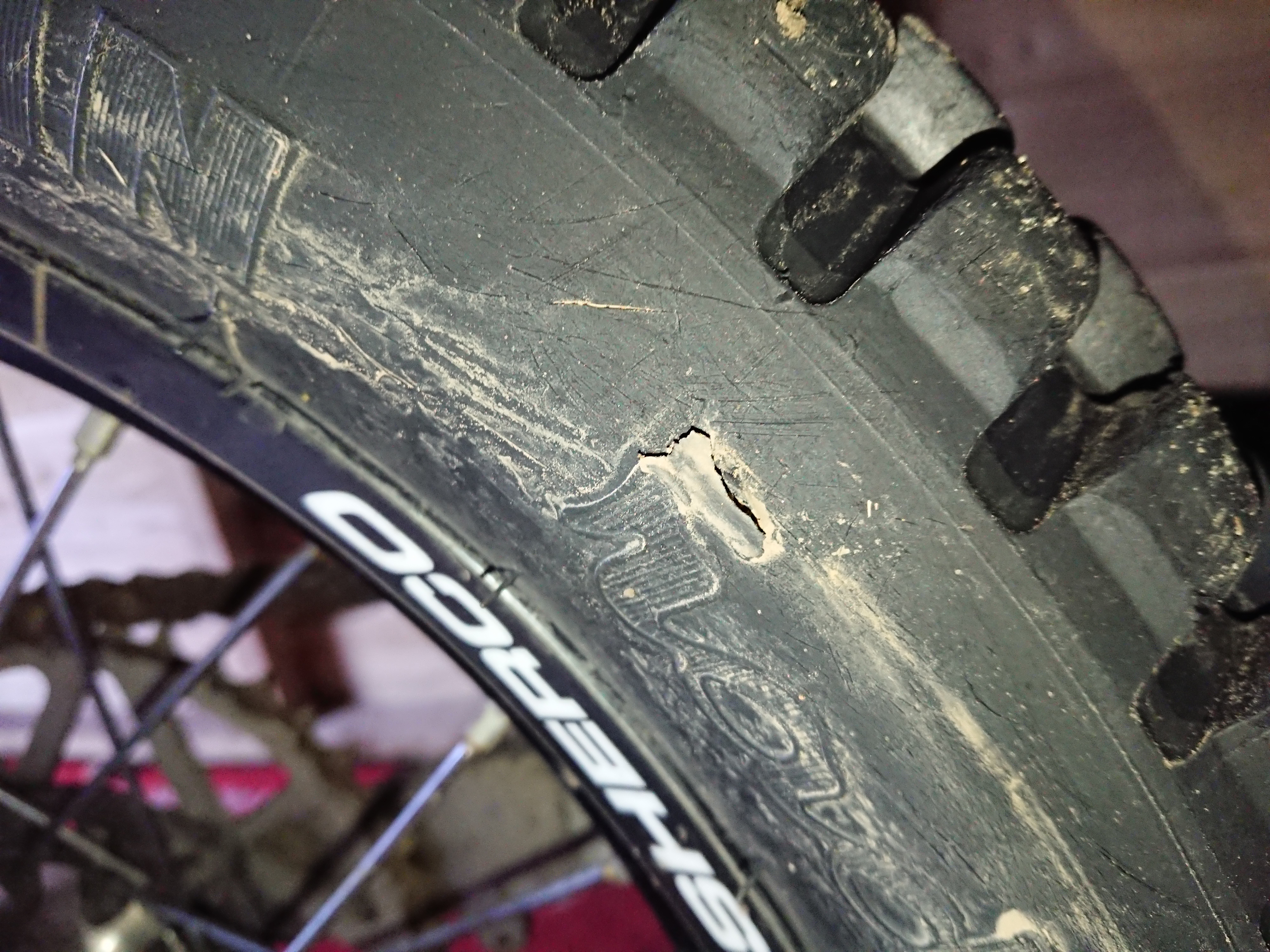

Hi!  I popped down to Tong earlier for a quick walk round, it wasn't that late but people where leaving. I'm definitely going to try and get to the next one. Well impressed with all the space! I discovered yesterday I have a puncture in my rear tyre and a few nasty gouges so I was hoping you could tell me where to get another fitted and what price I'm looking at including fitting? I've been looking online but I haven't a clue what I need :huh:

You can probably find someone at your local club who is willing to fit it for a little beer money (do they have a facebook group?).  Have a look for 4 x 18 trials tyres on ebay, just be aware that the Pirelli ones are a bit stiff (ok for distance riding, but not optimal for competing), and Michelins are considered the best by many people :)

EDIT: forgot to mention, if you have a puncture it may be that it's just the inner tube that needs sorting.  Sometimes they can be patched, so hold off on ordering anything expensive till you know!

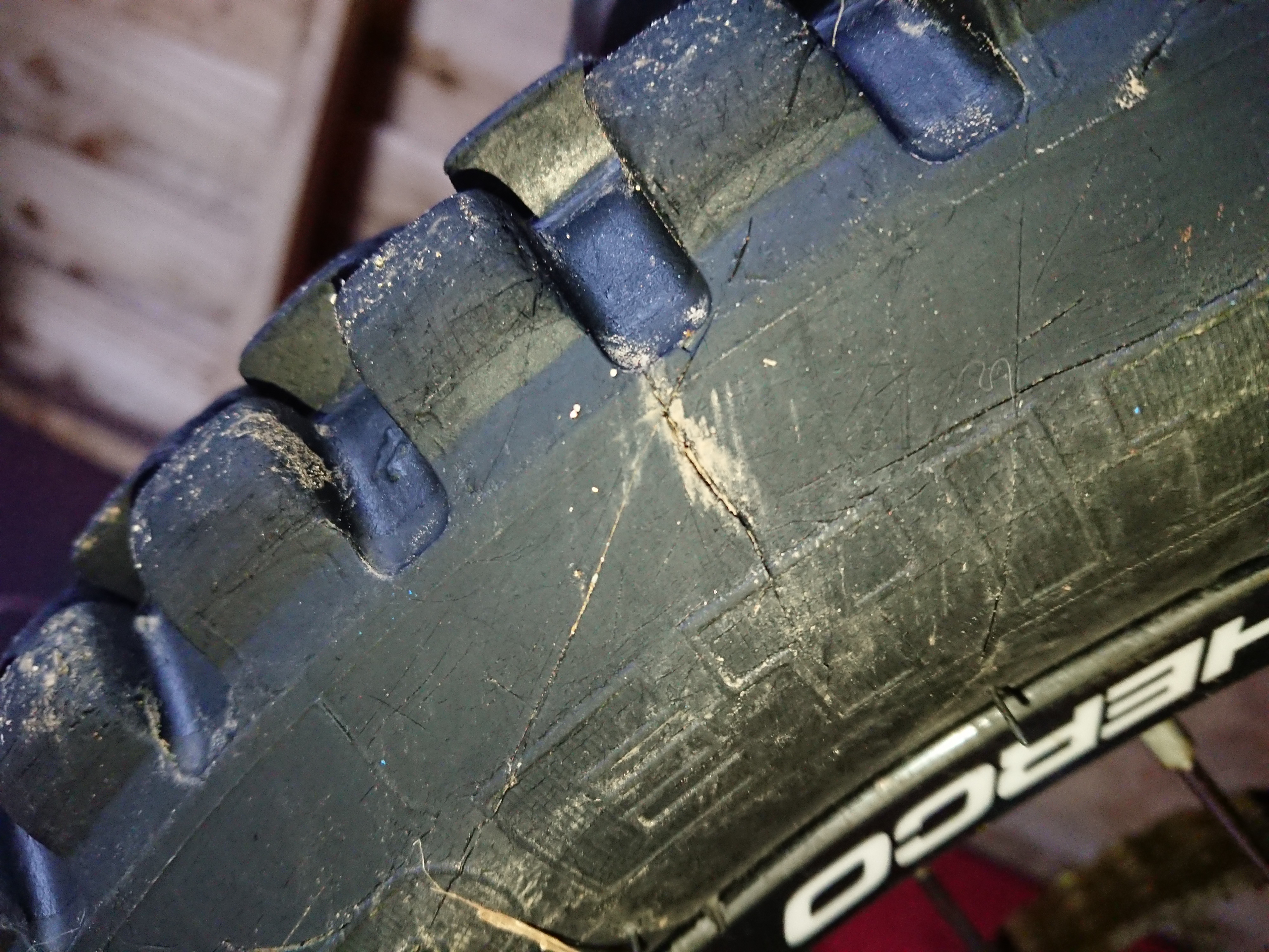

The video links where very helpful thank you. I'm definitely going to give it a go myself. I would like some opinions on my tyre if possible. It has a puncture for sure, it looks battered around the sidewall but I'm not sure what it's supposed to look like considering it spends its life mostly flat (remember I'm very new!) Can I not just put an inner-tube in there? I always repair things myself but these tyres are alien mostly flat weird things!
Anyway to me it looks like it should be replaced, but, if i can get away with just an inner tube for a bit as I'm a long way from hopping around on the back wheel. What do you think?

Given the amount of damage there, you really need to replace it otherwise you'll probably lose more inner tubes!  Ask at your local club if anyone has a good second hand tyre kicking around, as having rounded knobbles doesn't affect beginner riding very much :)
