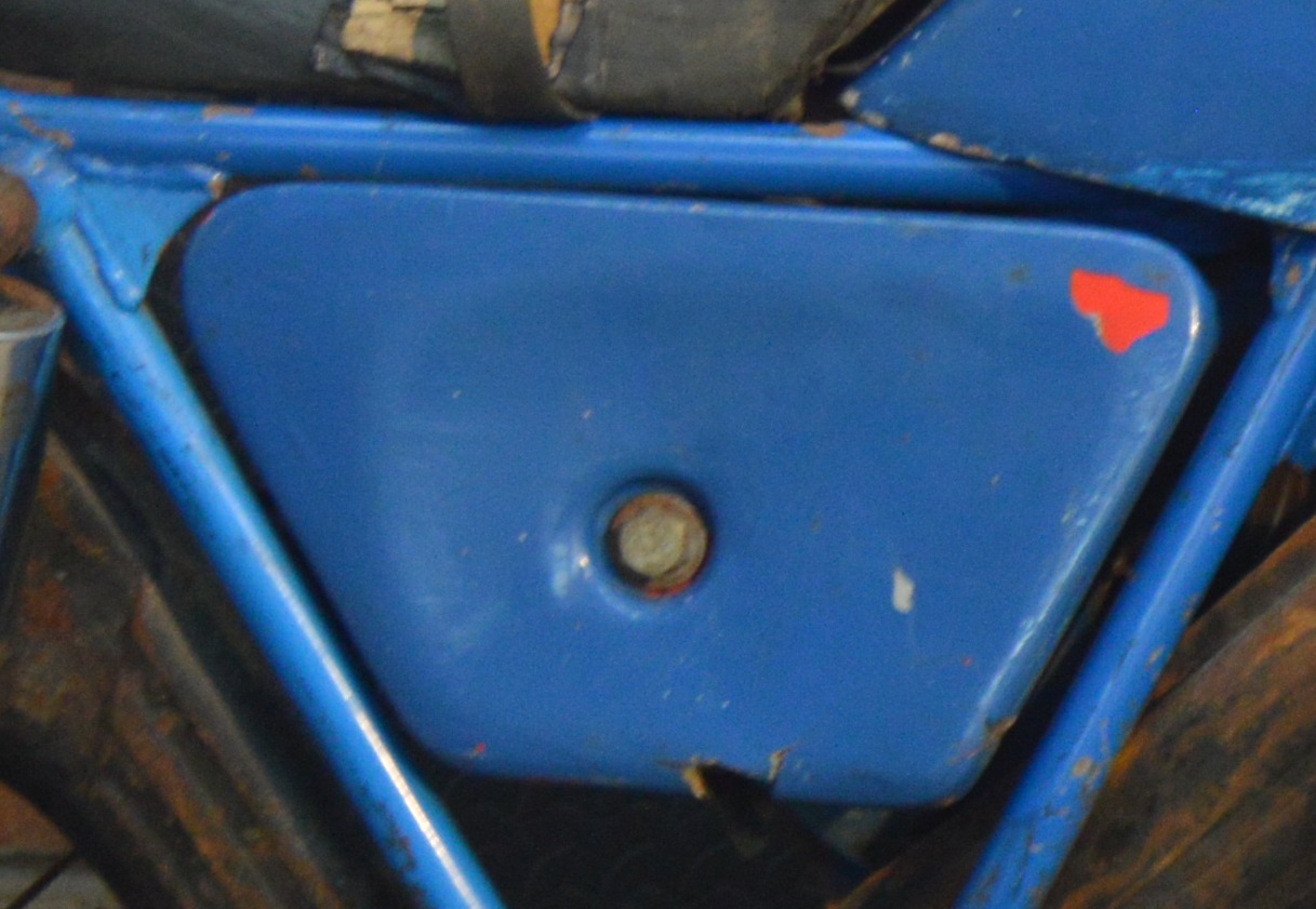

rcgods Posted January 5, 2018 Report Share Posted January 5, 2018 The older airbox would be from the model 159,183,191 style. These have one sidepanel as part of the airbox and the other is the airbox lid. Photo of one from a model 191 attached. 2 Quote Link to comment Share on other sites More sharing options...
