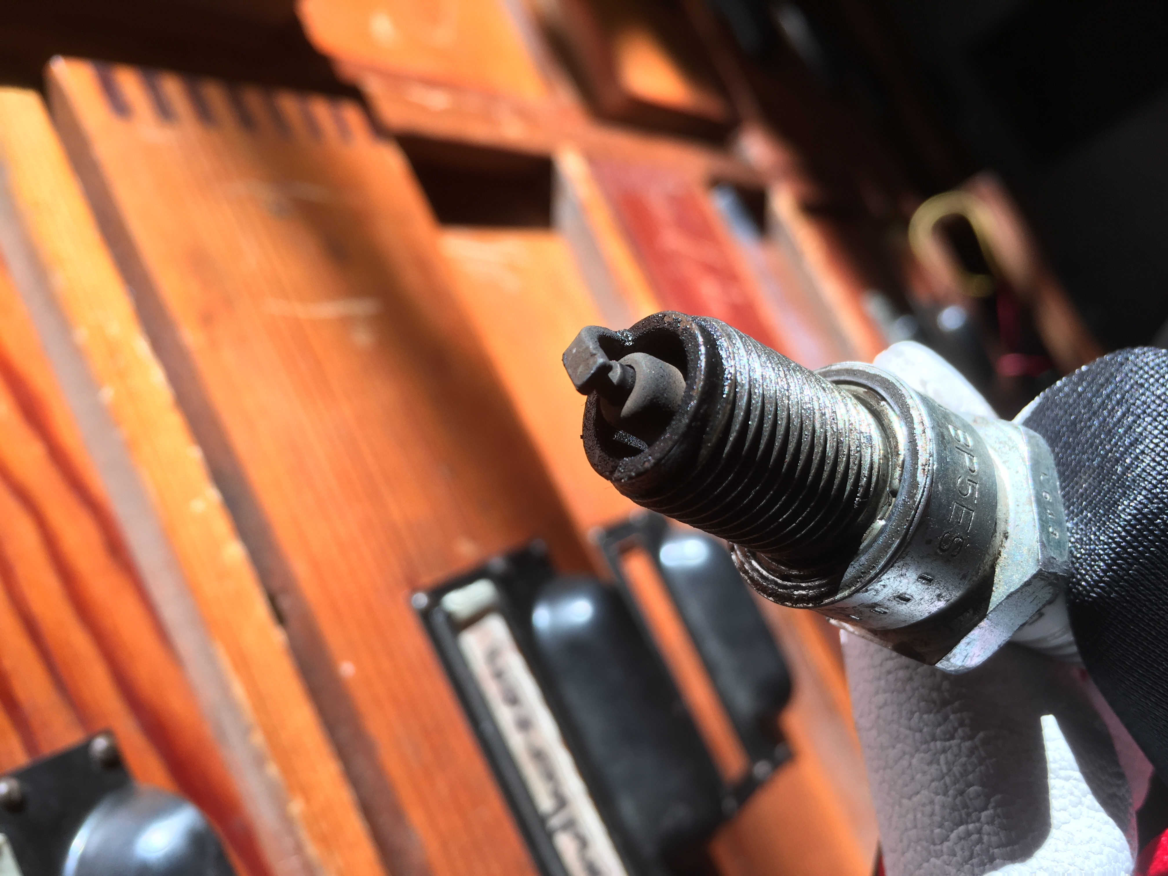

pschrauber Posted January 7, 2018 Report Share Posted January 7, 2018 How is the color of the plug? Can you post a photo of the plug and what kind of plug you are you using? It might be an airflow or a too rich adjusted carb problem, which I had recently? Quote Link to comment Share on other sites More sharing options...

dr-alpina Posted January 9, 2018 Author Report Share Posted January 9, 2018 (edited) On 1/8/2018 at 12:11 PM, sherpa325 said: I had a similar problem and it turned out to be a brand new set of points that had a poor connection where the wires attach as the hole was not fully tapped through. It took me countless hours to find the problem as I thought the wires were tightened up against the screw, but the screw had bottomed out before putting pressure on the wires. But as everyone has said replace the condenser first [I bought one from a mower shop once out of desperation and it worked fine] and check all your wiring joins as well as the kill switch and your earth. Cheers Greg PS a faulty condenser can still give a reasonable spark when you are kicking the engine over! Expand thanks for advice. i will check that at the weekend . here is the plug...ngk 5 Edited January 9, 2018 by dr-alpina Quote Link to comment Share on other sites More sharing options...
bullylover Posted January 9, 2018 Report Share Posted January 9, 2018 One thing I can see with your spark plug is the plug gap looks way too wide. A Bultaco on points need a plug gap of .40mm the same as the points. That would not be causing the problem but it will make it start much easier. Quote Link to comment Share on other sites More sharing options...
