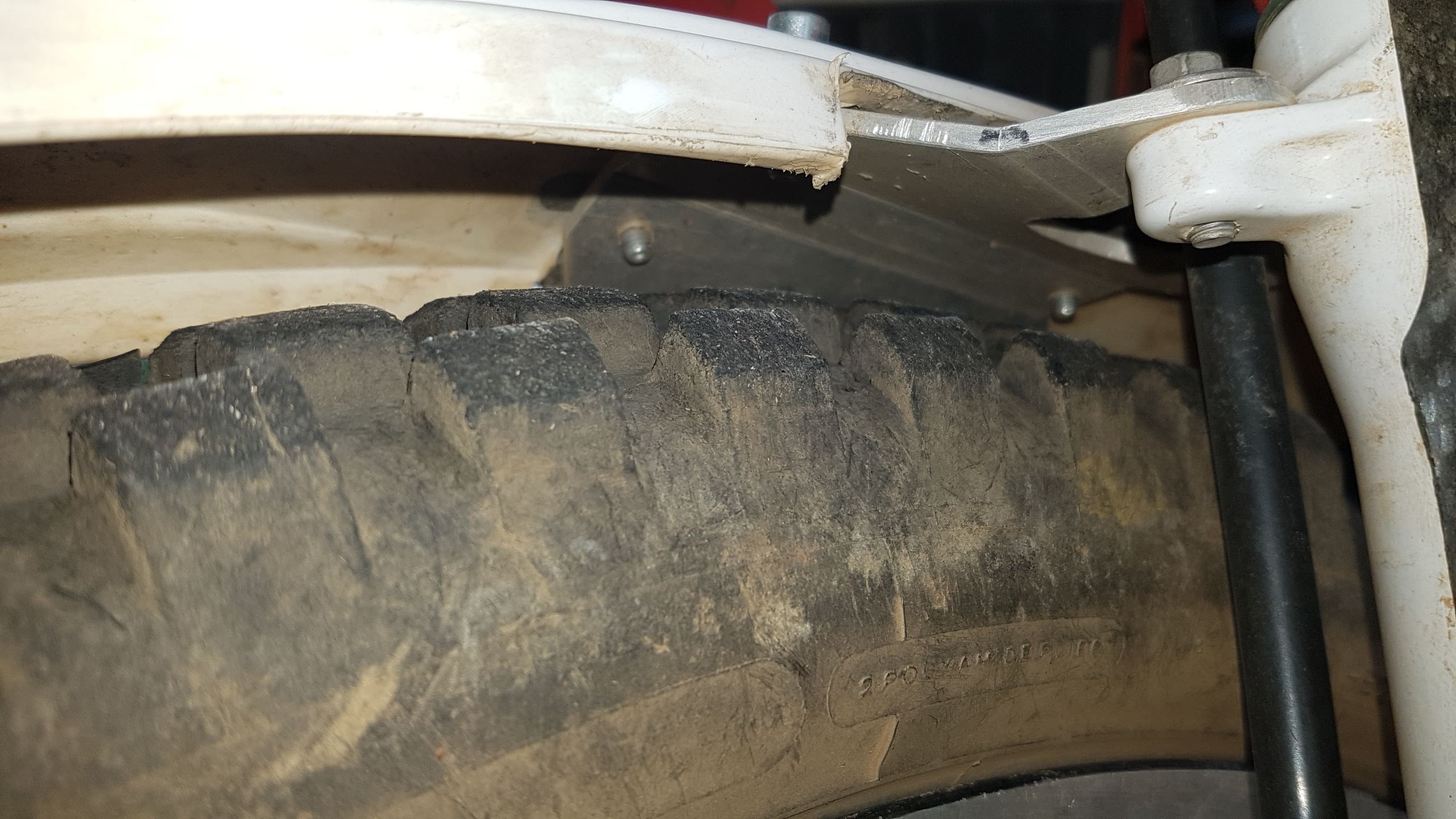

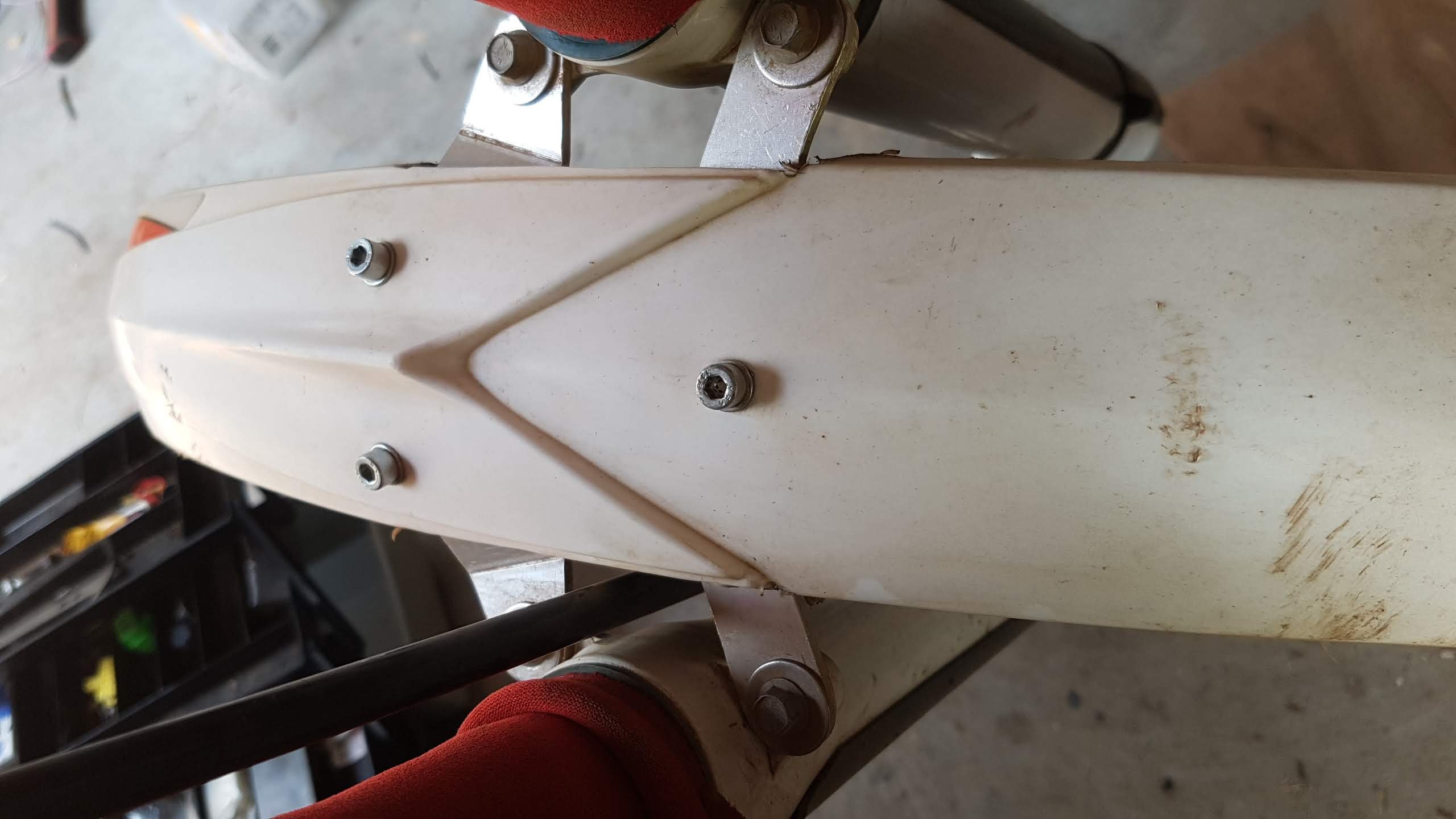

bikerpet Posted January 12, 2020 Report Share Posted January 12, 2020 The silly moulded plastic brace part of my '17 Beta front mudguard completely failed recently. Deciding it was faster to self-repair rather than get parts in, I designed a 3mm sheet aluminium brace to go into the existing Beta guard. It took 3 revisions to get it close enough to right, but seems good now. I neglected to take photos of the part before mounting it, so here are some mounted. I used a Dremel to cut out the remnants of the plastic brace (I was unimpressed how thin the plastic was at the joint to the white guard). Took a bit of adjustment of the design to get the angles correct so the back of the guard clears the exhaust/radiator correctly. I can upload a PDF of the flat pattern and bend angles if anyone is interested - it's on my other PC. If I did another I'd add a little metal to keep the brake hose a bit closer to the fork - minor but would be an improvement. I'd also use just two M4 bolts to mount the guard - the 3 x M5 was a hangover from my first version brace, still need to get some button head screws to improve appearances. All in all a very simple part to make. 1 1 Quote Link to comment Share on other sites More sharing options...
