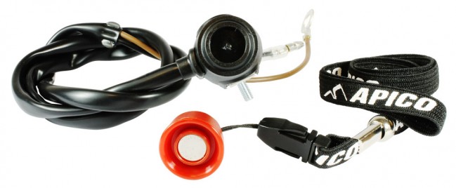

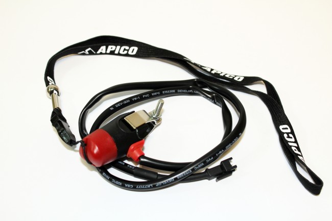

dabba Posted January 13, 2018 Report Share Posted January 13, 2018 (edited) Apico make two types of lanyards, one for petrol bikes which is normally open circuit with the magnet applied, and switches to closed circuit when the magnet is removed. This type has a black grommet where the wire enters the switch housing. The Oset type Apico lanyard is normally closed circuit with the magnet applied, and switches to open circuit when the magnet is removed. This type has a red grommet where the wire enters the switch housing. The top picture is the petrol engine type, the bottom picture is the Oset type with the red grommet. Edited January 13, 2018 by dabba 2 Quote Link to comment Share on other sites More sharing options...
